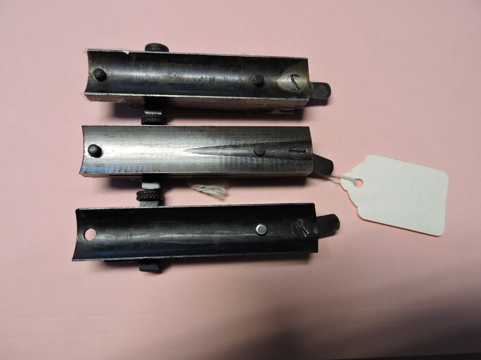

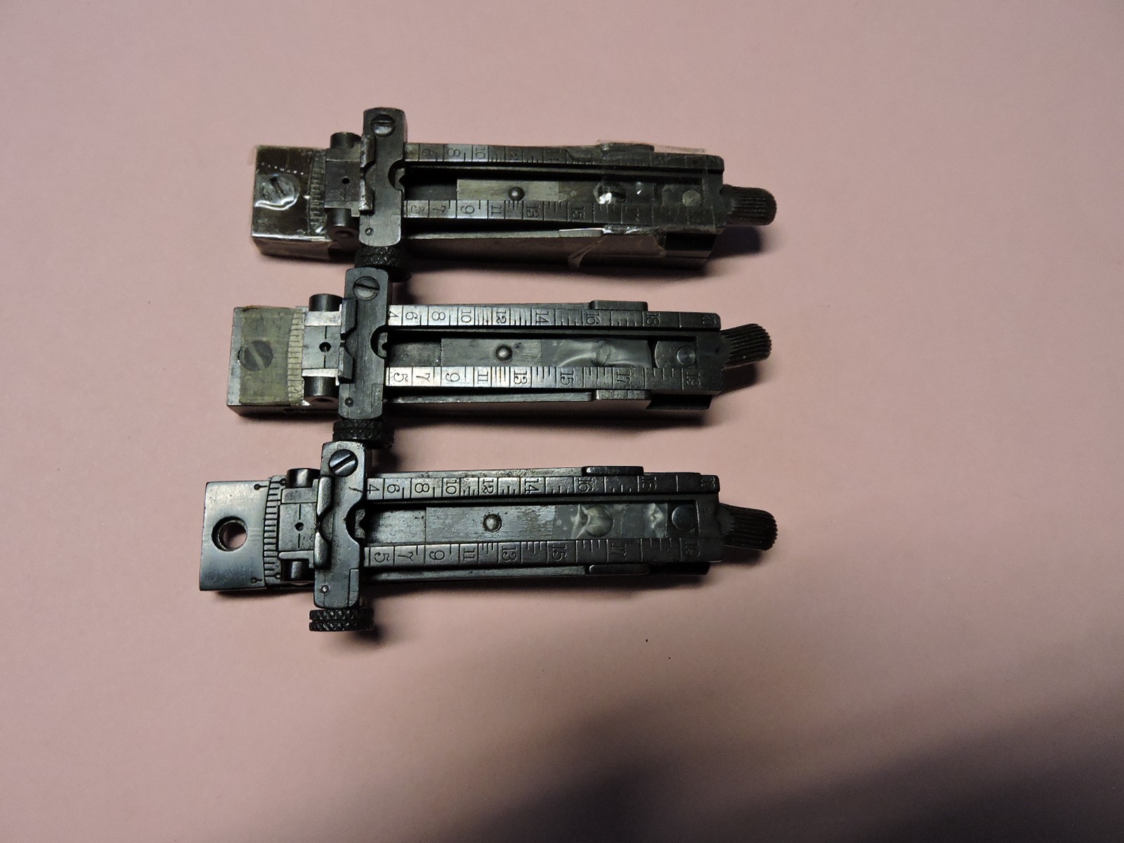

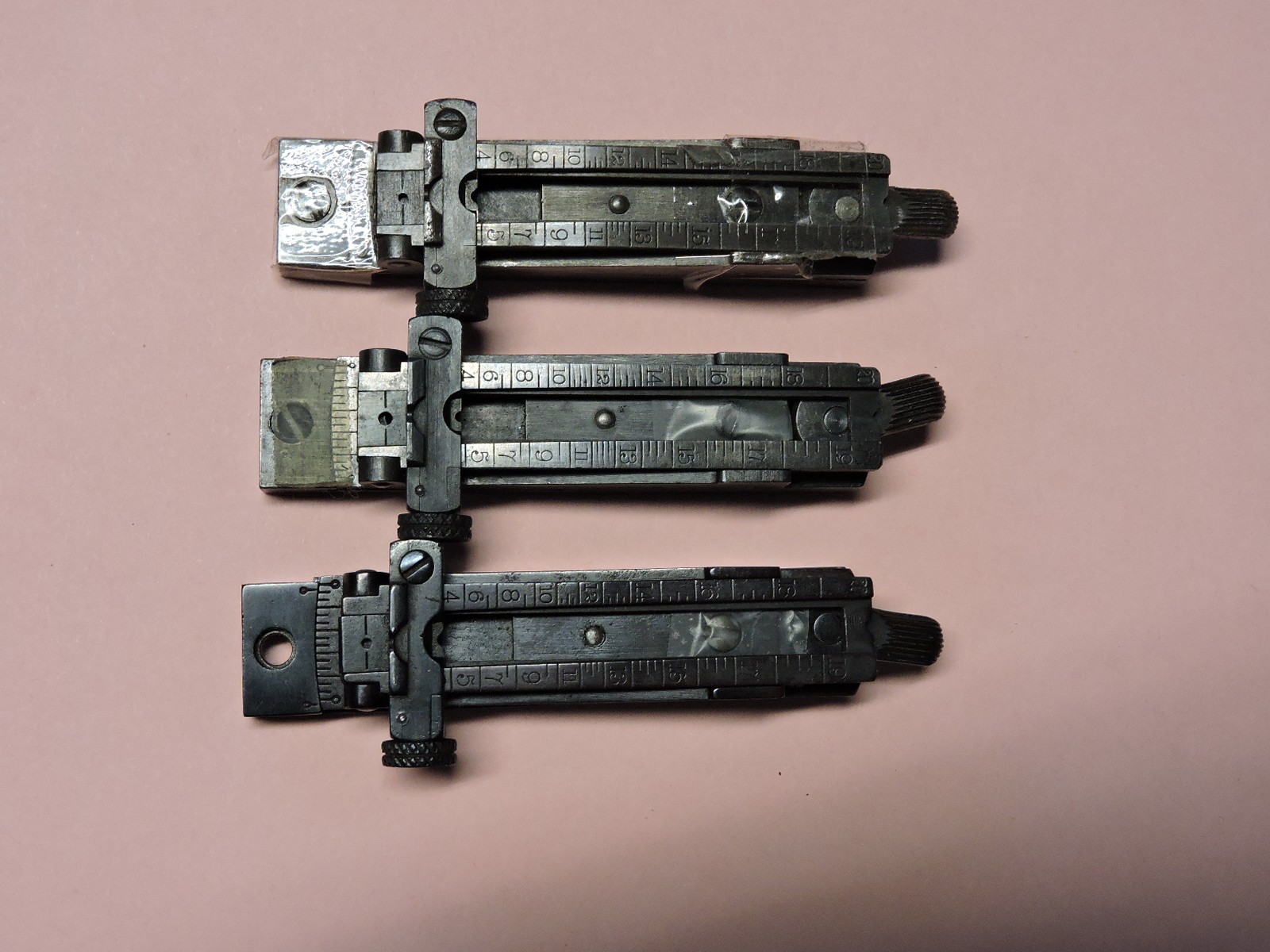

I have 3 of the Krag Jorgensen sights.  The center of the screw holes measures 2.335″, as best as I can measure.  I have two I would sell, the other is off my 1885 22 Musket and not for sale.  The center sight is the Musket sight. The top sight has front and rear screws and shows normal age in very good original condition.  The bottom sight only has the front screw.  It has a nice ‘black’ finish, but shows no signs of polishing or buffing.  I am not sure if these will work on a carbine, but thought it might help.   PM me if you are interested.   RDB  Just realized this is a Musket (Rifle) Sight, not for the carbine.  Embarassed
