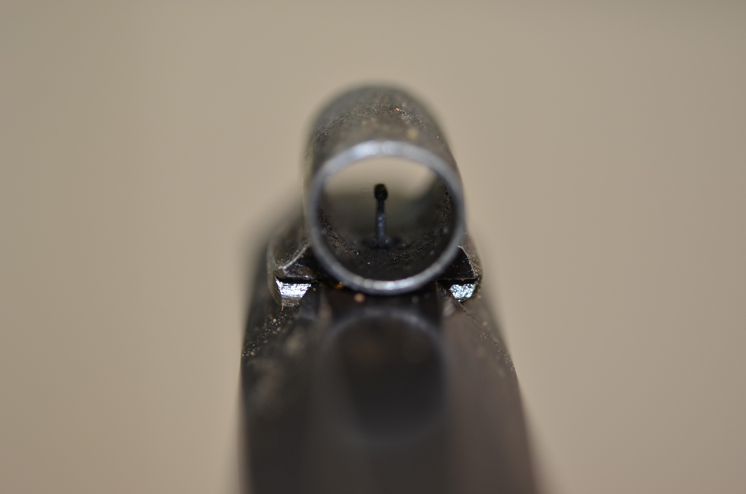

Can anyone help identify this front sight
Appreciate the help.

Pat,  I don’t know who made that sight but I don’t believe it was Winchester.   In the Winchester 1875 catalog they had a fixed reticle globe sight.  The buyer chose the one they wanted.
In the August 1881 catalog they show a new globe sight with interchangeable disc reticles.  This one was made well into the 20th century.  See below.
I looked in Nick Stroebel’s “Old Gunsights” book and your sight looks something like a Marlin globe sight shown on page 176.  It appears to have a fixed reticle.
It also resembles the Lyman No. 17 which I believe had a fixed reticle.

Very close to a Lyman 17 but does not have the little screws on the side. It looks  like its a Sharps Globe by the front and rear groves in the OD just its a little shorter in length.
