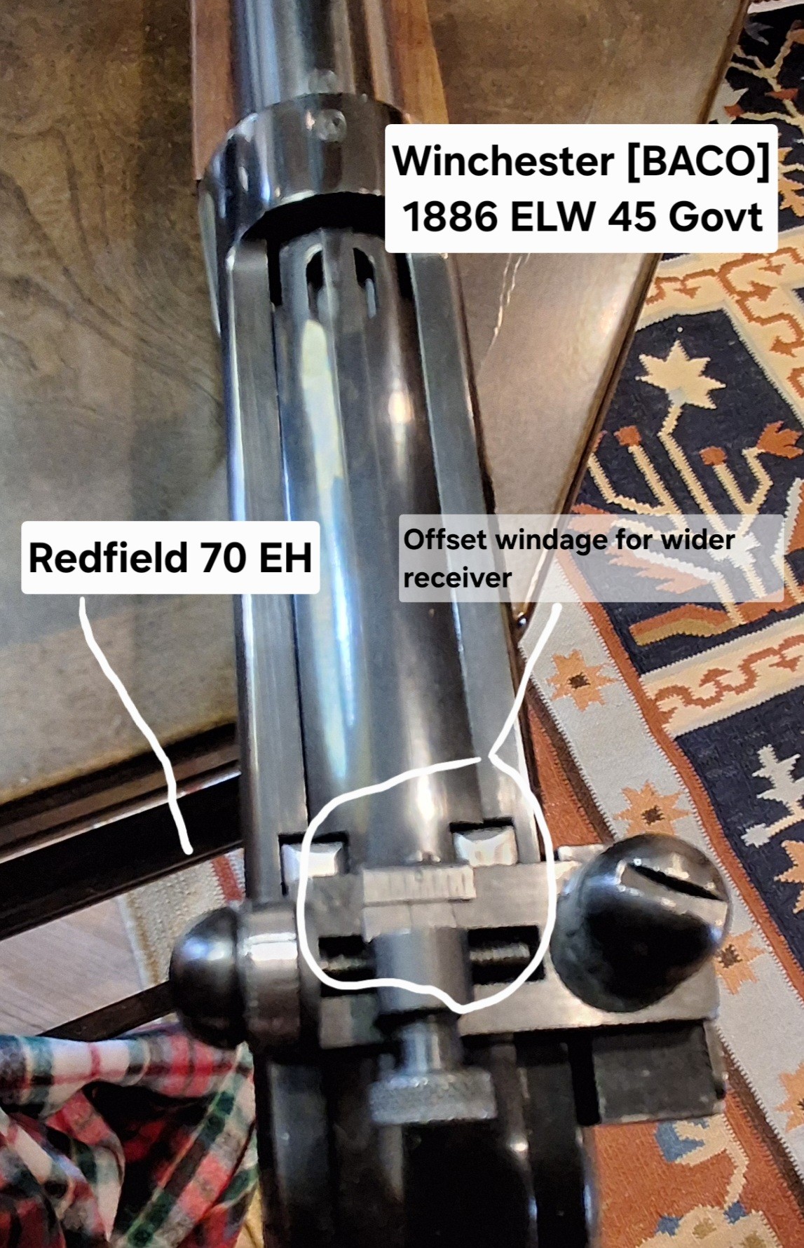

My point is, a Lyman A coded 56 or 66 and an E coded Redfield, although intended for the 92/94 width receivers have plenty of windage range to work well on the Model 71 and any 1886. They are no longer reallyy cheap but they can be had on eBay  …. or, better, from our own Ben or Erin when they have them.

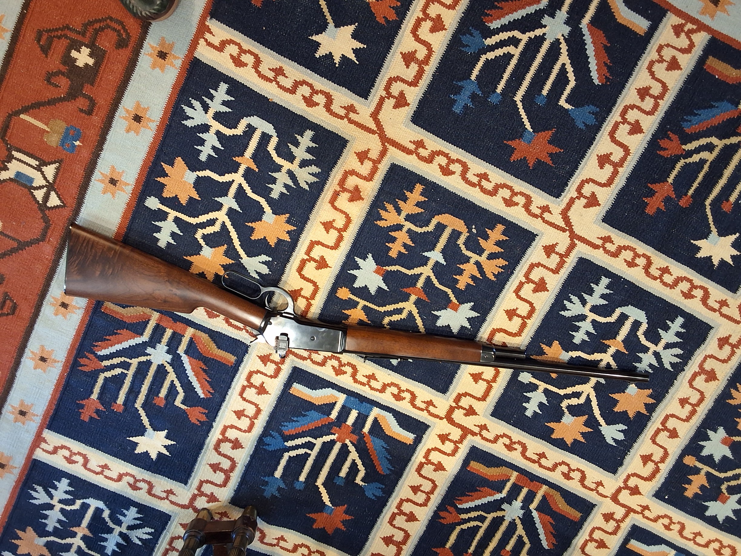

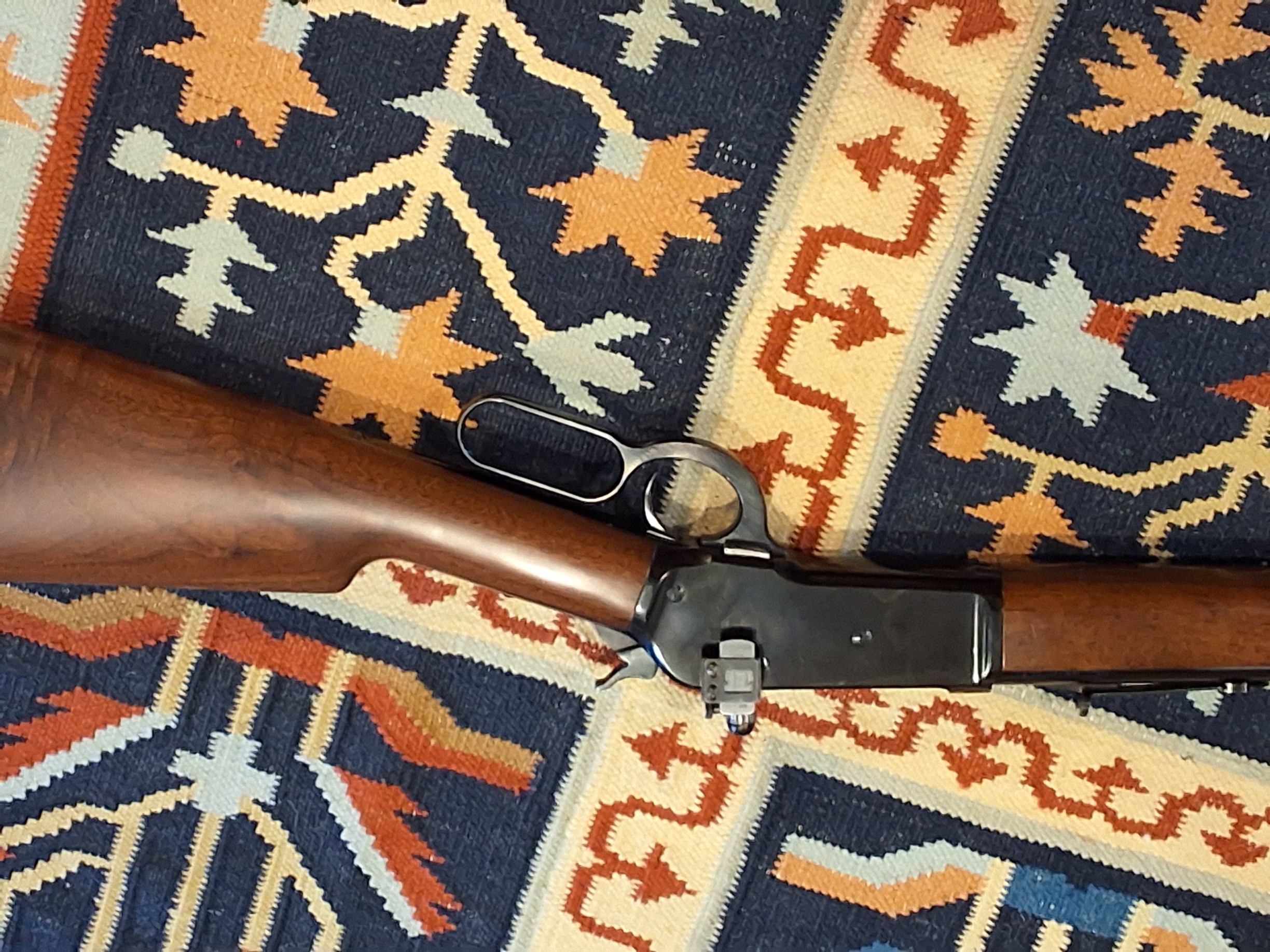

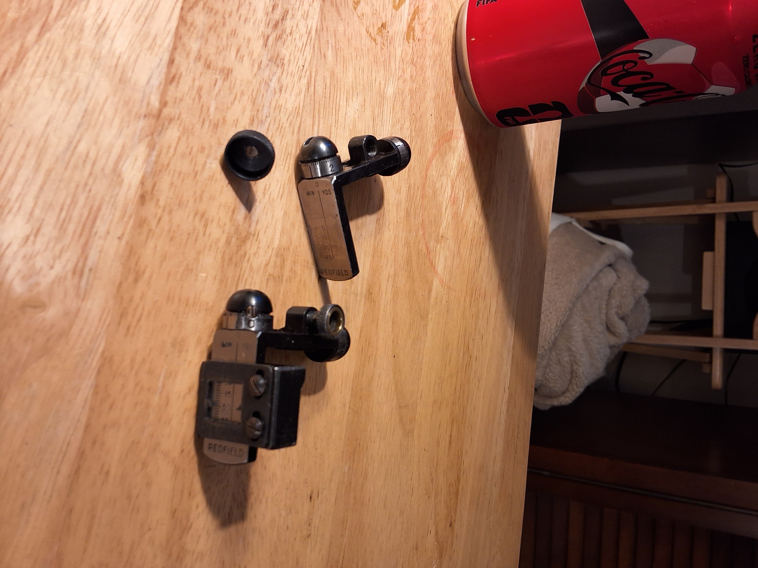

If you find one you want that’s a little tired, remember there are LNIB sights coded for unpopular guns or guns everybody scopes. Buy them cheap as a parts source. The Redfield 70 EH mentioned [and illustrated below]
20260216_171624-2.jpg20260217_152836.jpg20260217_152451.jpg20260217_152510.jpg20260217_152115.jpg wears a like-new staff a/k/a “bridge”, new knobs, elevation screw, detents and knob attachment screws, all from a 70 BRH I bought for parts 20 years ago. The parts were identical in all respects and swapped right out.
