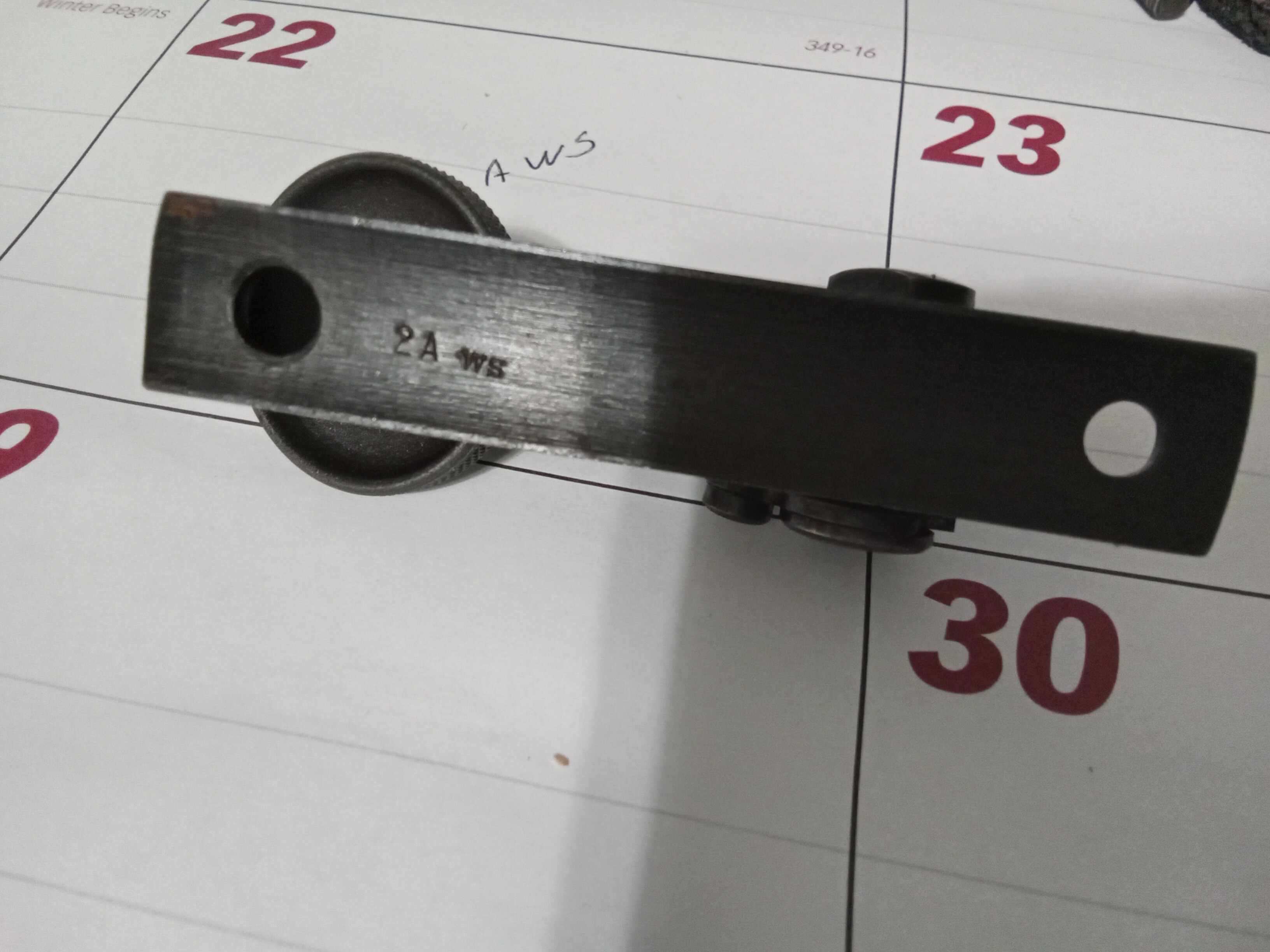

The WS stamp belongs on your 1890’s Harry.

Ya’ , I just figured that out, I think post 1905, correct?

Henry Mero said
What does this one belong on
That’s a Lyman 2A with the WS code for Winchester models 1890, 1906, 62, and 62A.
Actually, it is a post-1920 sight.  Lyman did not start marking top of the sight base until the 1920s.

Thanks Bert, I just happen to have a post 1920 mod. 90 to put it on.
