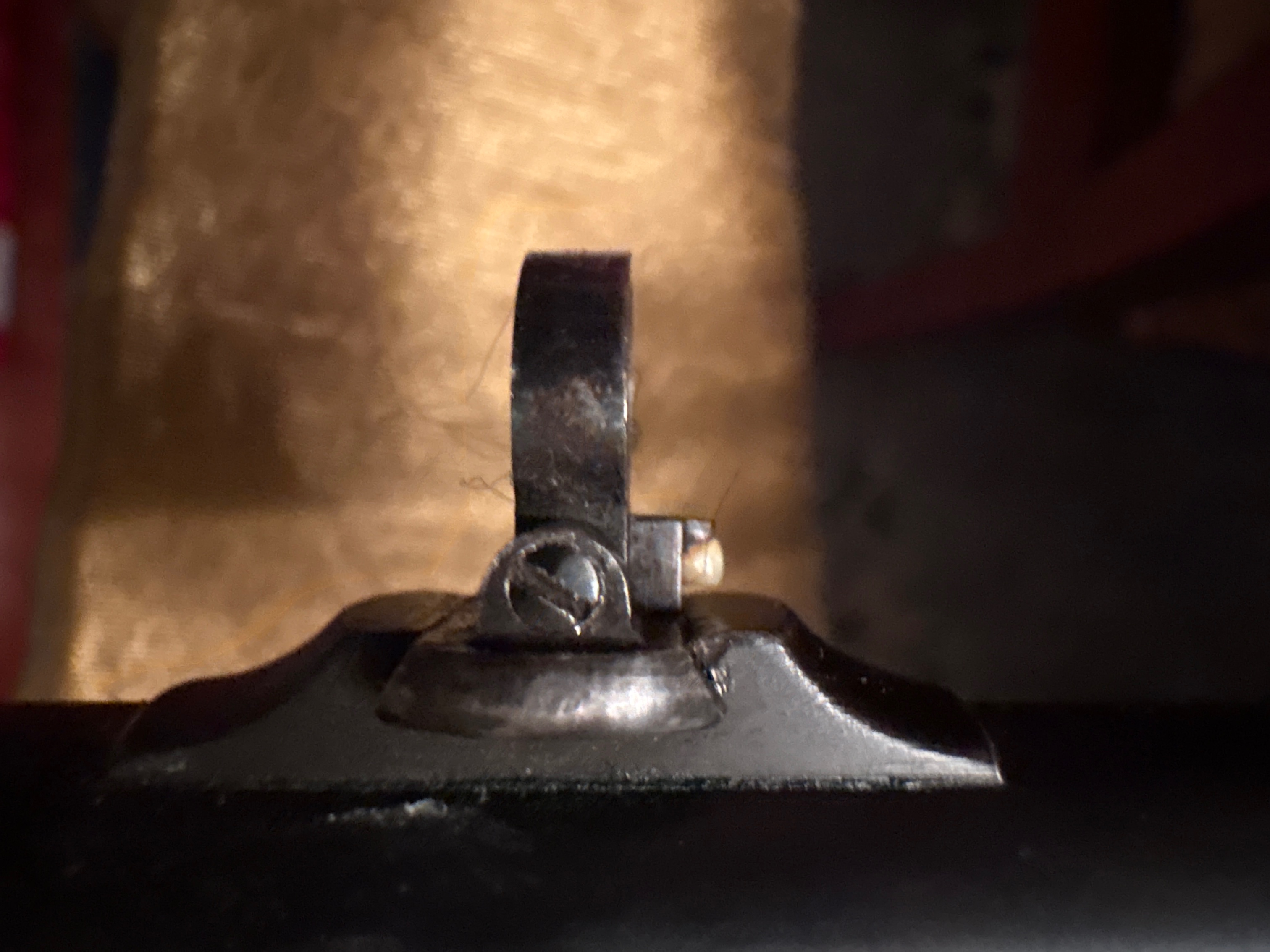

image.jpgThis globe sight has no tension whatsoever.  One would think that tightening the screw on the left side of the sight would increase tension.  But it has no effect, any attempt to further tighten is unlikely to tighten but rather lead to damage to the screw head.  Any suggestions?  Or best to just let sleeping dogs lie, except it’s doubtful the rifle left the factory this loose.

That is a Lyman #5 combination front sight and you can normally tighten the friction by tightening the screw. Have you tried both screws? Remove the screw and inspect it. The pin end of the screw could of been broken off. The beach sight has a spring in the base that kept it in place.

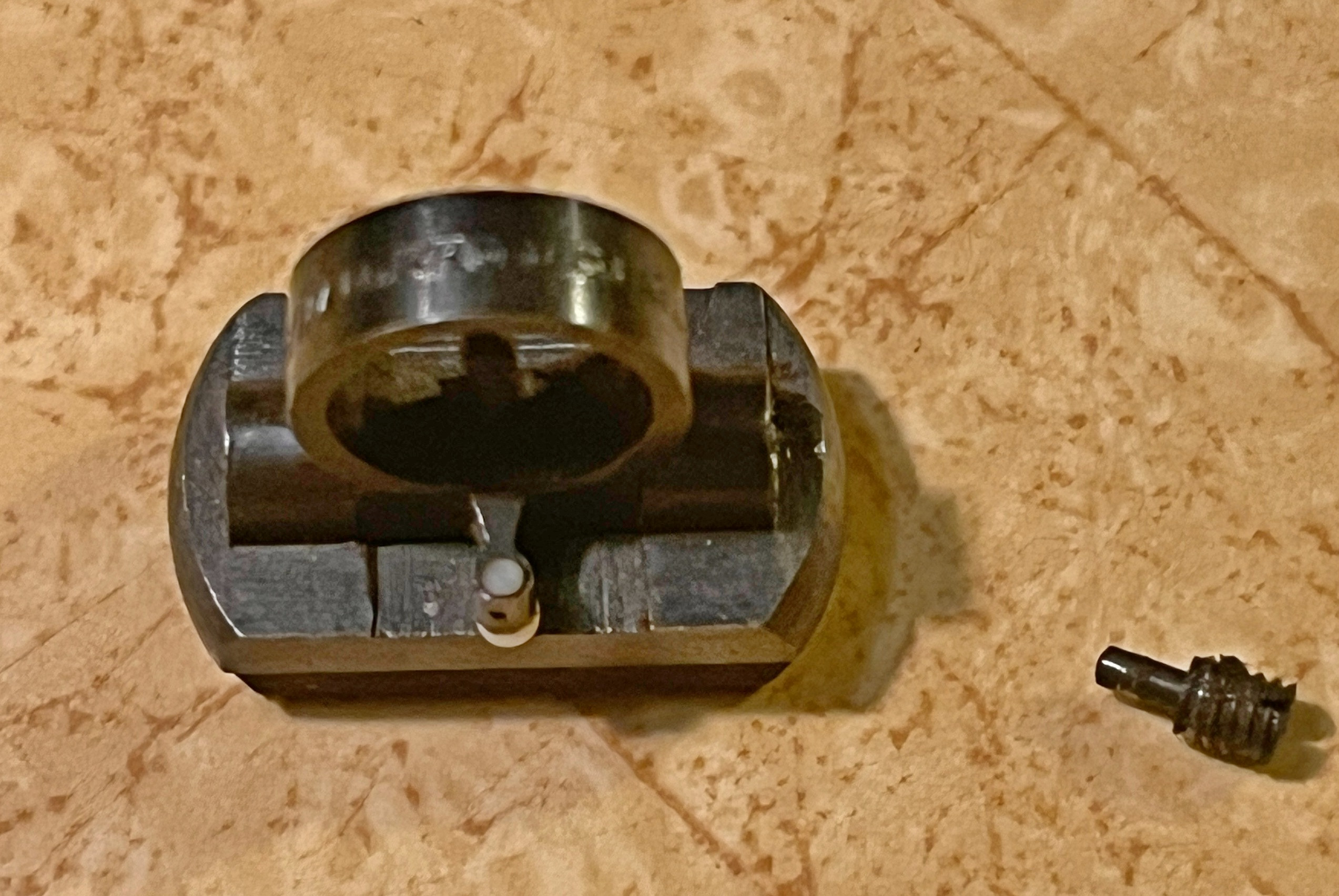

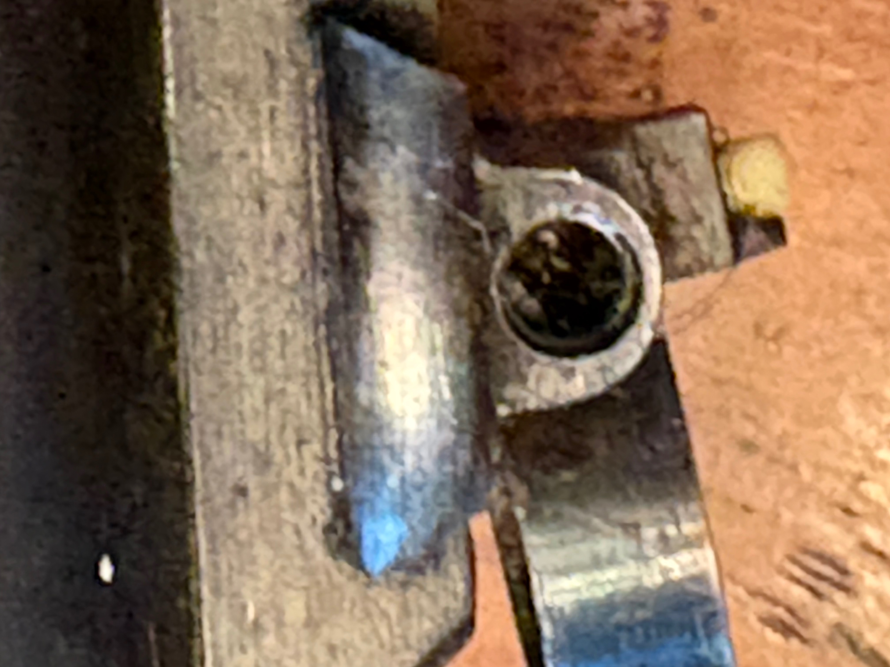

IMG_5457.jpegIMG_5458.jpegI finally got around to tightening this right screw which I did not know existed, although common sense dictates that it would, and I now know why the globe sight is loose.  The screw to tighten on the right side is missing!  Now, how do I go about acquiring a replacement screw?
Forum Posts: 5008
October 14, 2026 - 1:49 pm
Buy another sight to steal one from or make one. No one has ever sold replacement screws. There are sights sold that have broken globes for sale on Ebay.

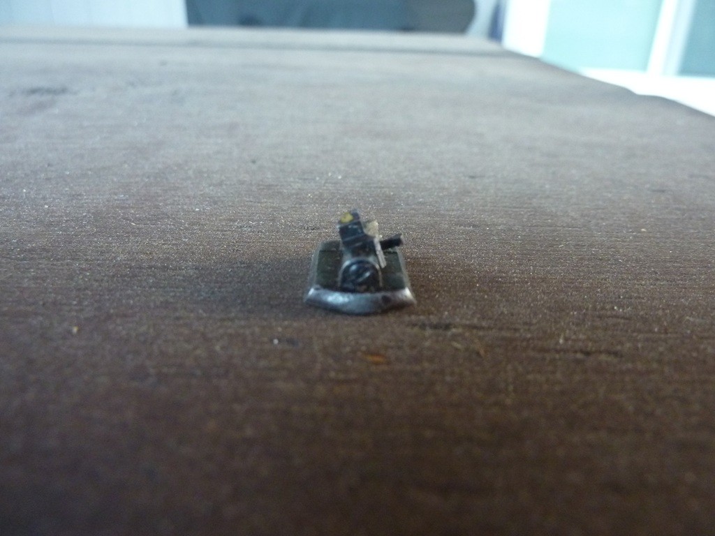

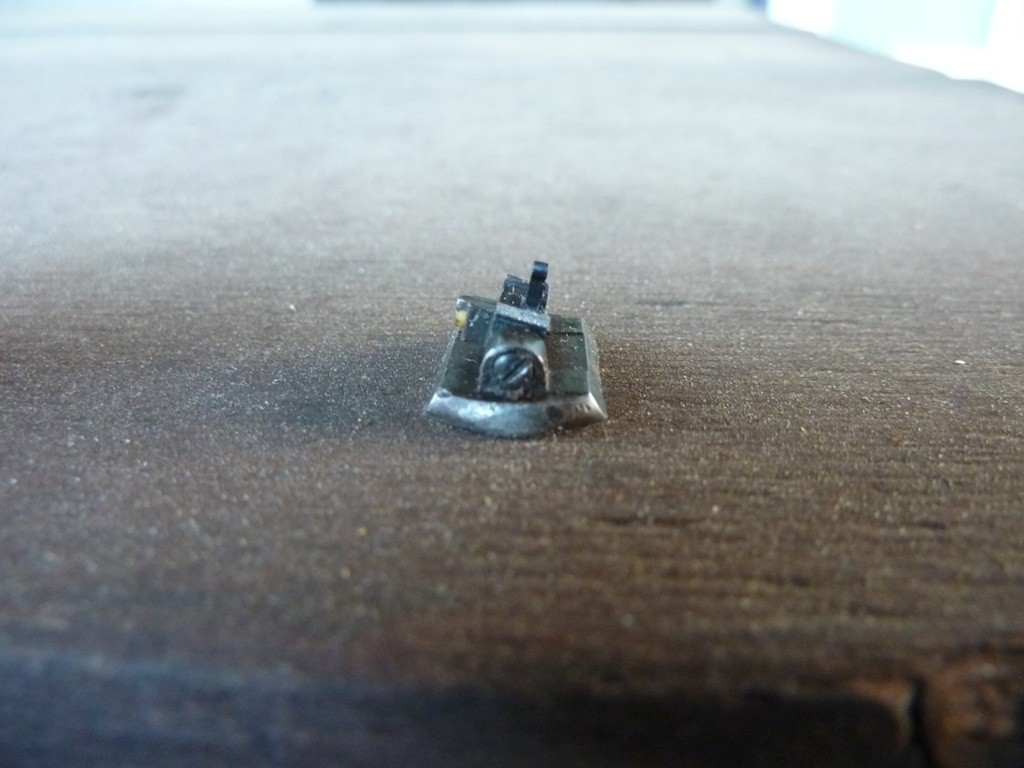

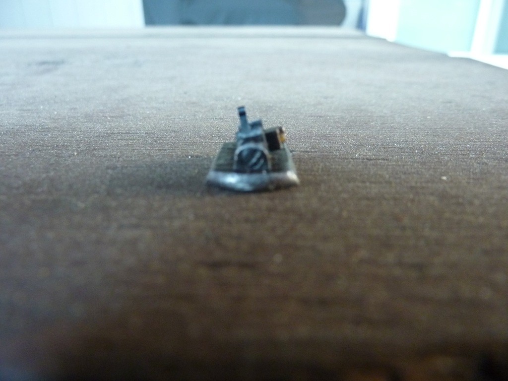

Hi Ian,

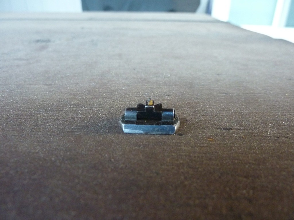

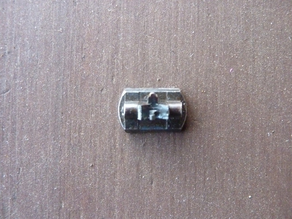

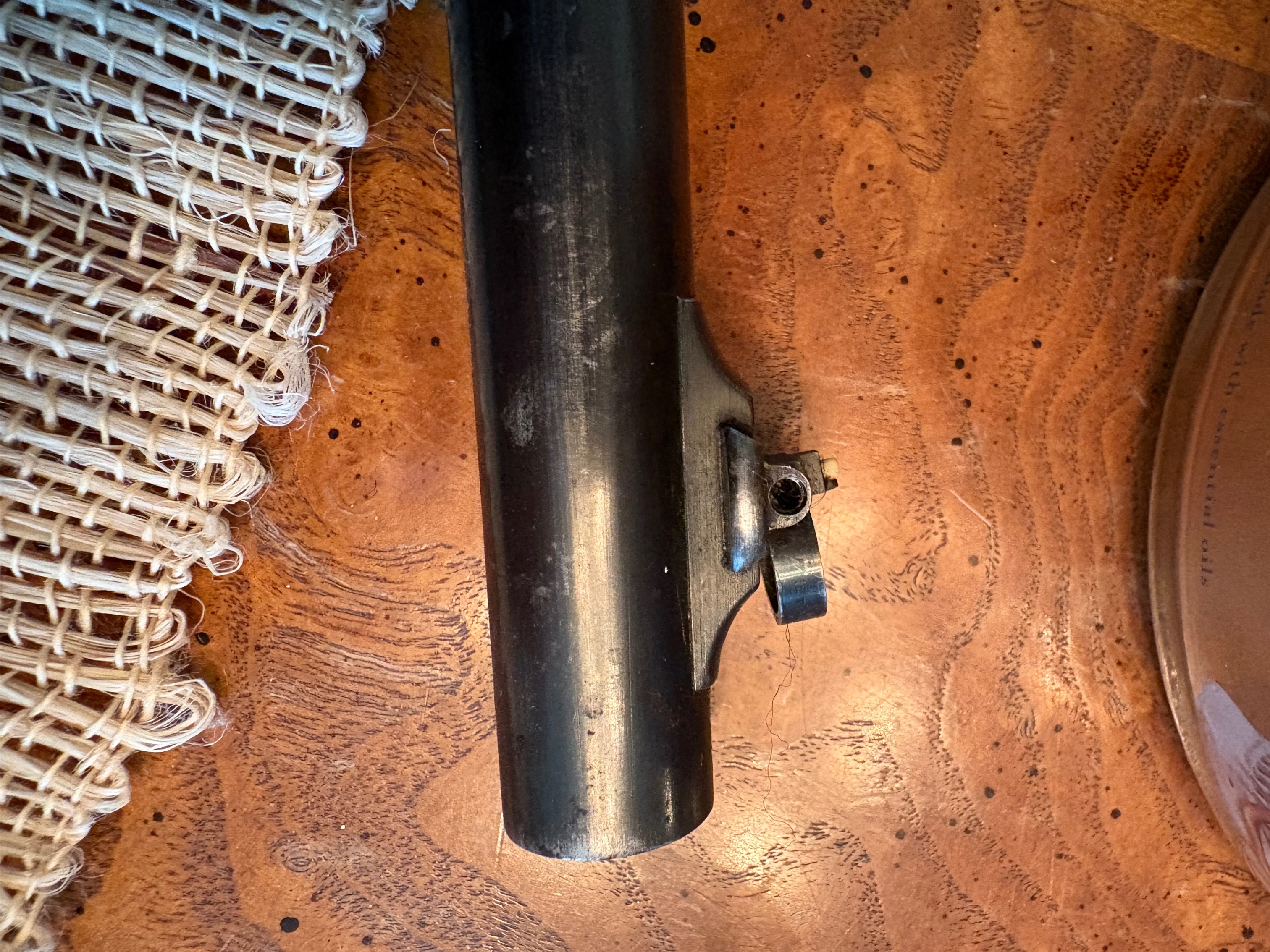

I have a Lyman #5 with a broken globe with both screws present if you’re interested.  I would like to get $65 shipped for it.  Let me know.  Here are some pics:
