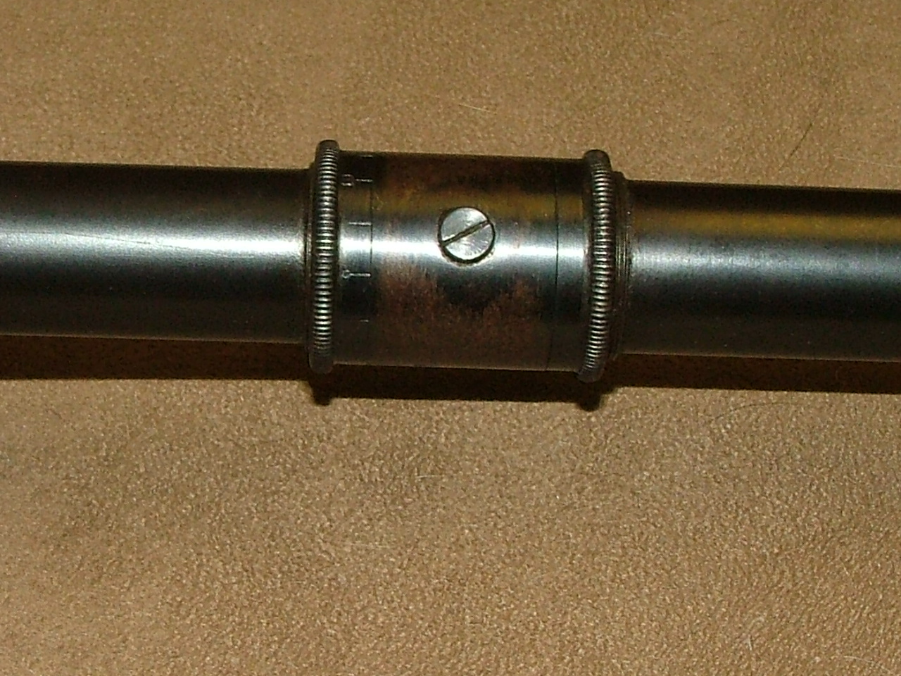

In my collection I have Fecker # 619. Lowest number I have ever seen, but not the lowest number I have heard of. That was #333 belonging to Mr. Parson of Parsons Scope Service. Both scopes appear to be custom and are quite different. Both have Winchester Grasshopper mounts. Big LarryDSCF0531.JPGDSCF0526.JPGDSCF0534.JPG

Fecker offered “custom” designed scopes in countless Rifleman ads, from his first one in ’22 nearly until he died.  Hard to remember exact wording without looking it up, but it was to the general effect that whatever the customer wanted, he would build. Most other scope builders, such as Unertl, would probably have done the same thing if asked, but only Fecker went out of his way to say so openly.  The other unusual element in his advertising was frequent offerings to upgrade older Fecker scopes, which usually meant installing larger objectives.  (I have one of those, now fitted with a 1-1/2″ obj. not offered  at the time the scope was originally built.)
During the time I was actively looking for them years ago, I never saw one as low as #619.  Once had #745, mounted in a Winchester mount that had the grasshopper spring replaced with a plunger as Lyman later introduced.  That and all but two were sold about 10 yrs ago.
Fecker moved his operation to Pittsburgh sometime after June, 1926, so any scope with the Cleveland address would have been made in ’26 or before.  Pittsburgh-produced scopes are not so marked–he merely omitted the old address.

Looks like only way that one could be upgraded would be to have the dated & numbered card on which parallax settings for different ranges were recorded after it had been tested by a technician.  This time consuming practice ended with Fecker’s death.  Needless to say the vast majority have been lost; I’ve only heard of one that remained with the scope, and it was not for sale.
November 14, 2016 - 1:10 am
Yes, they are quite rare. I think I have seen only one. Thanks my friend.    Big Larry
