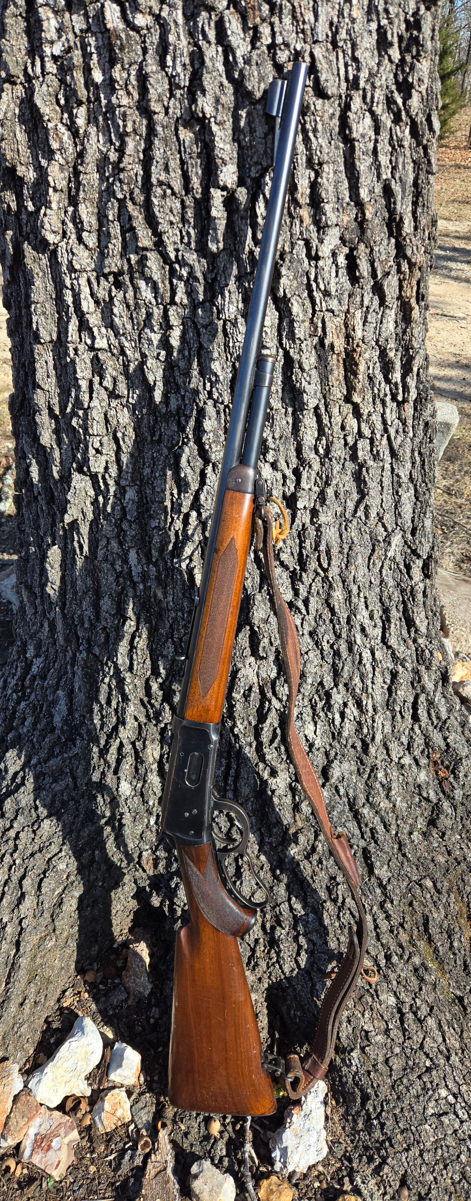

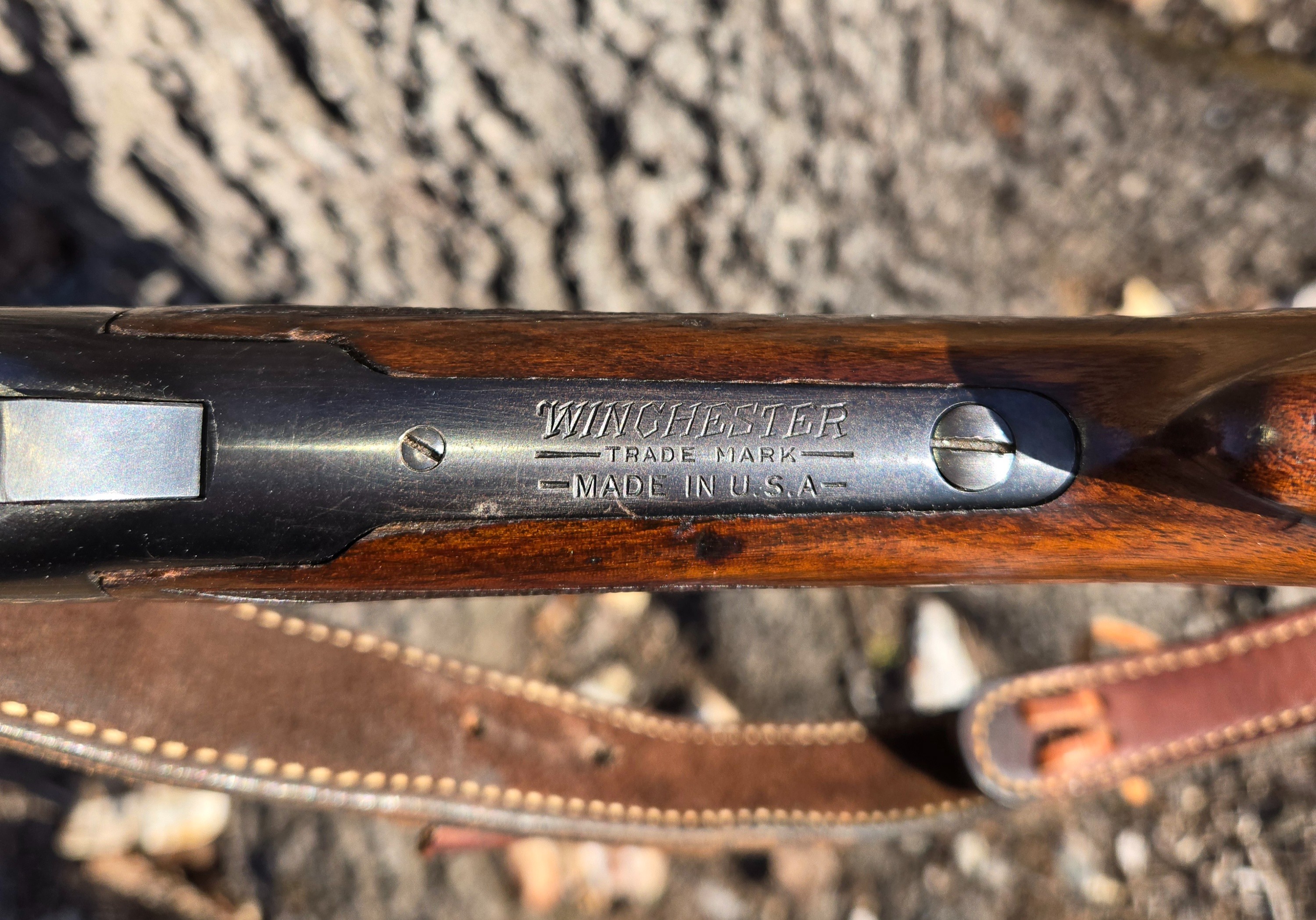

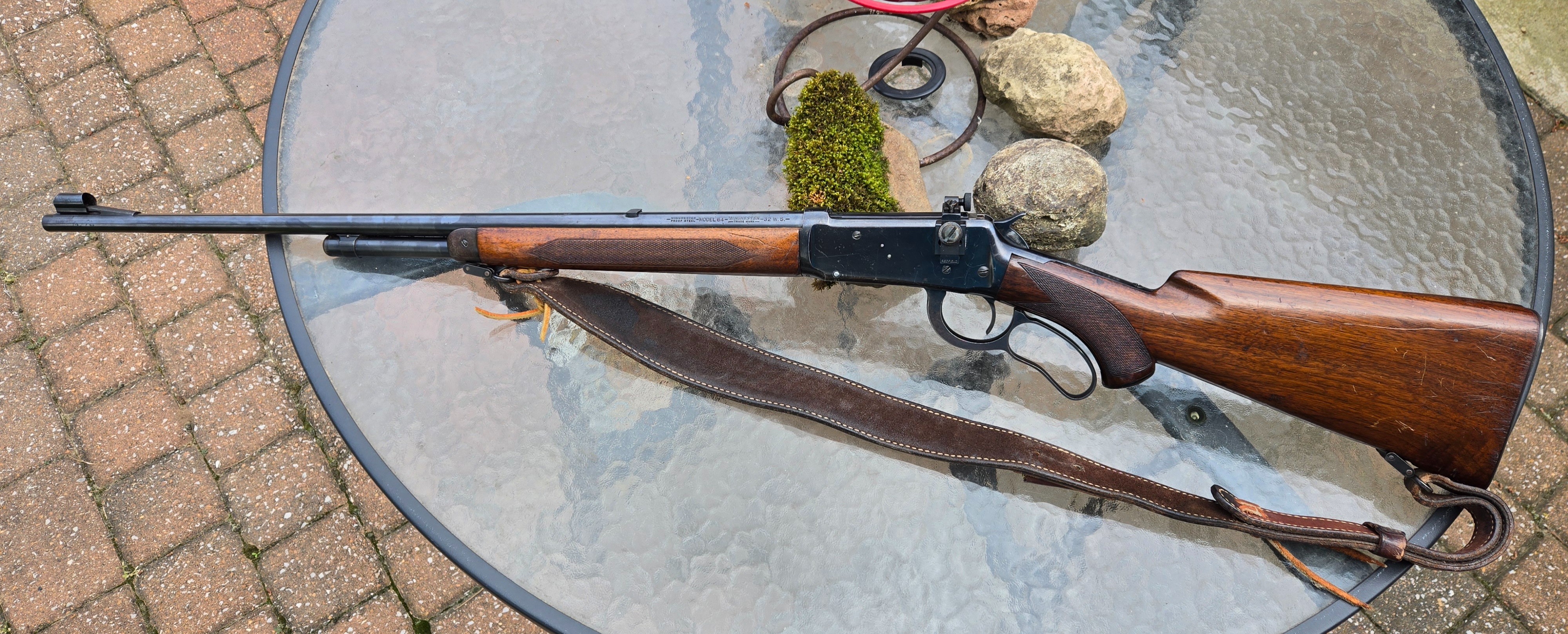

Yes, it’s a 1937 so it can use either. Any excuse for pictures:
Forum Posts: 2012
January 11, 2026 - 10:22 pm
  Nice gun, it would look good with a Lyman tang sight to match. They are nice and won’t get in the way when you fold it back. Your point of carry is farther forward so not in the way. Not cheap, maybe $250, but easy to sell if change your mind. T/R

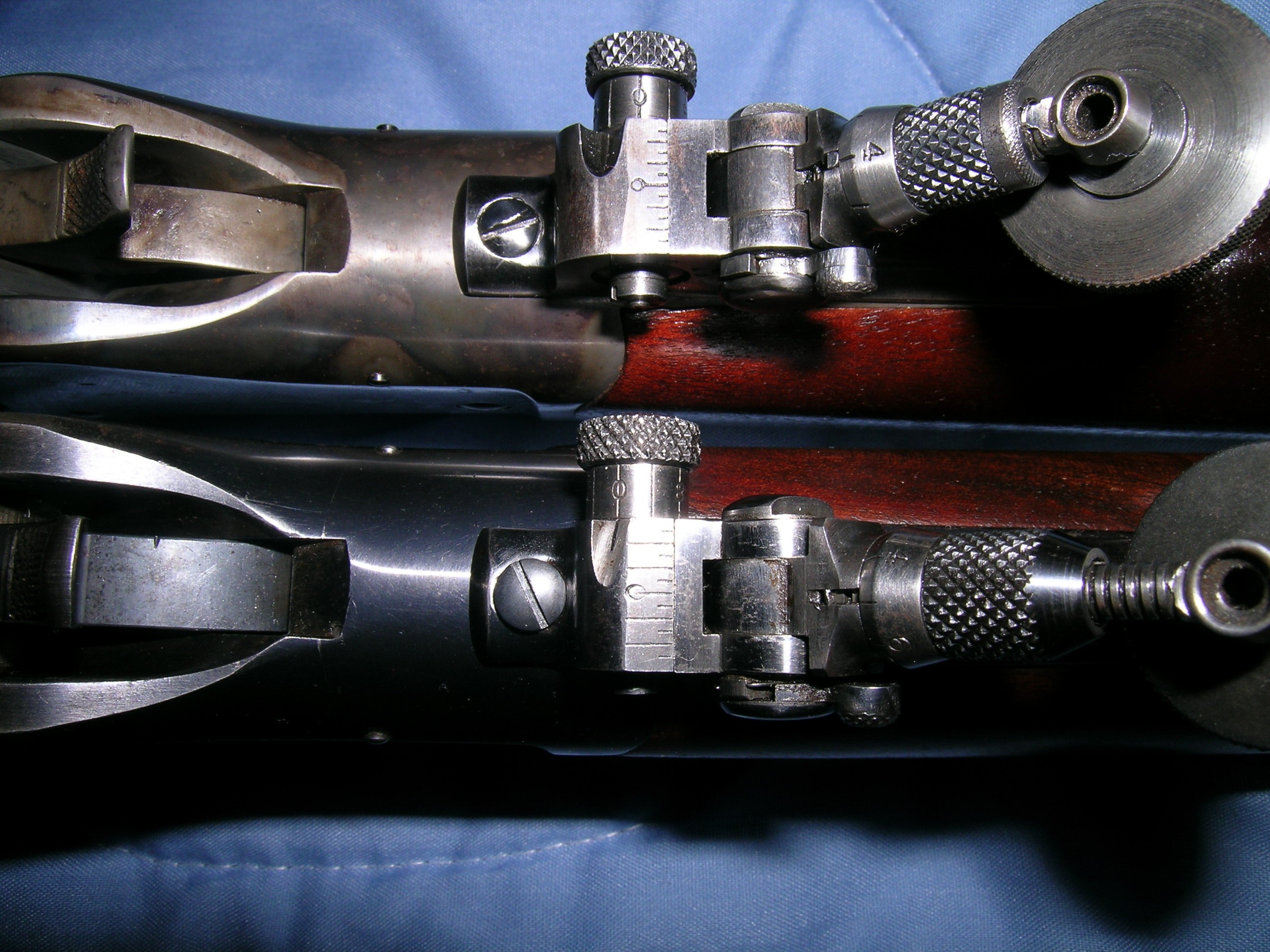

If I am hunting with the rifle, the receiver sight is the way to go, as you do not have to flip it up and lock it in place… it is always where you last left it.  I have a Redfield 102E on my pre-war Model 64. It is a more compact sight than a Lyman No. 56 (which would be my second choice).
If I am target shooting, I much prefer the tang sight (a Lyman No. 2/2A or a Lyman No. 103).  The tang sight is closer to my eye, has a slightly longer sight radius, and it allows for a finer sight alignment.  I have Lyman No. 103 micrometer tang sights on (4) different rifles.

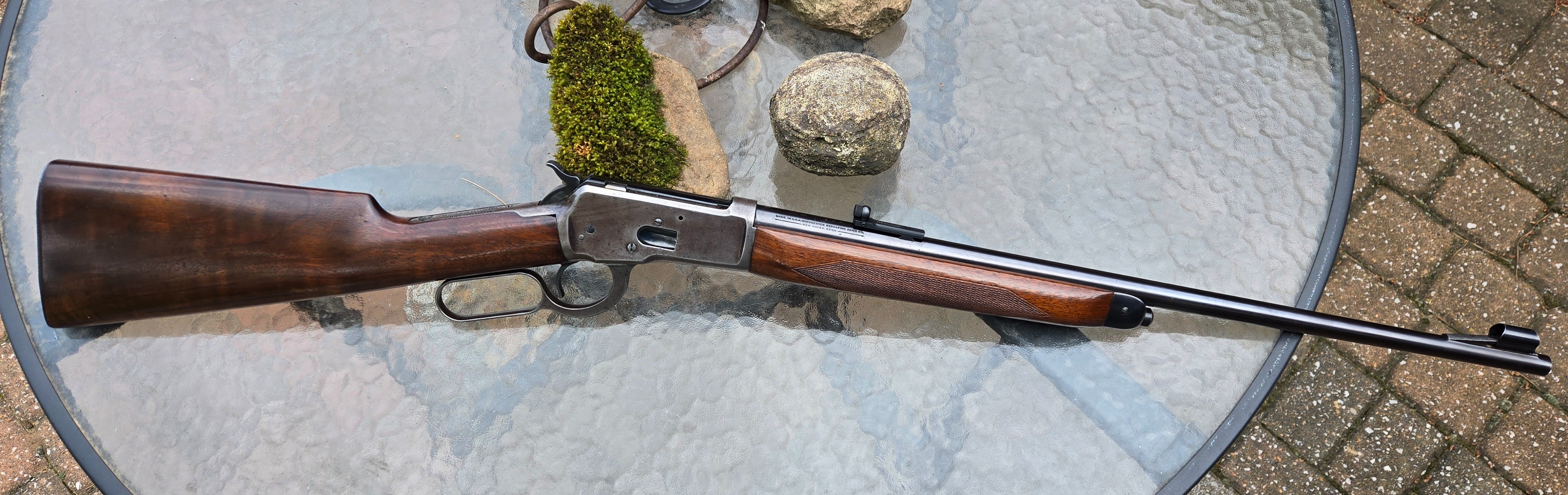

Thanks everyone. Mike, that’s a good idea; I just found a really good deal on a new production Lyman tang sight I’m going to try on the rebuilt 92/53 I just bought since it won’t take a receiver sight before I spend the money on a vintage sight. Bert, wow, it’s wild what even the accessories are bringing these days. I’ll be leaving the Lyman 103 off my list of possible options, that’s more than half what I paid for the rifle!

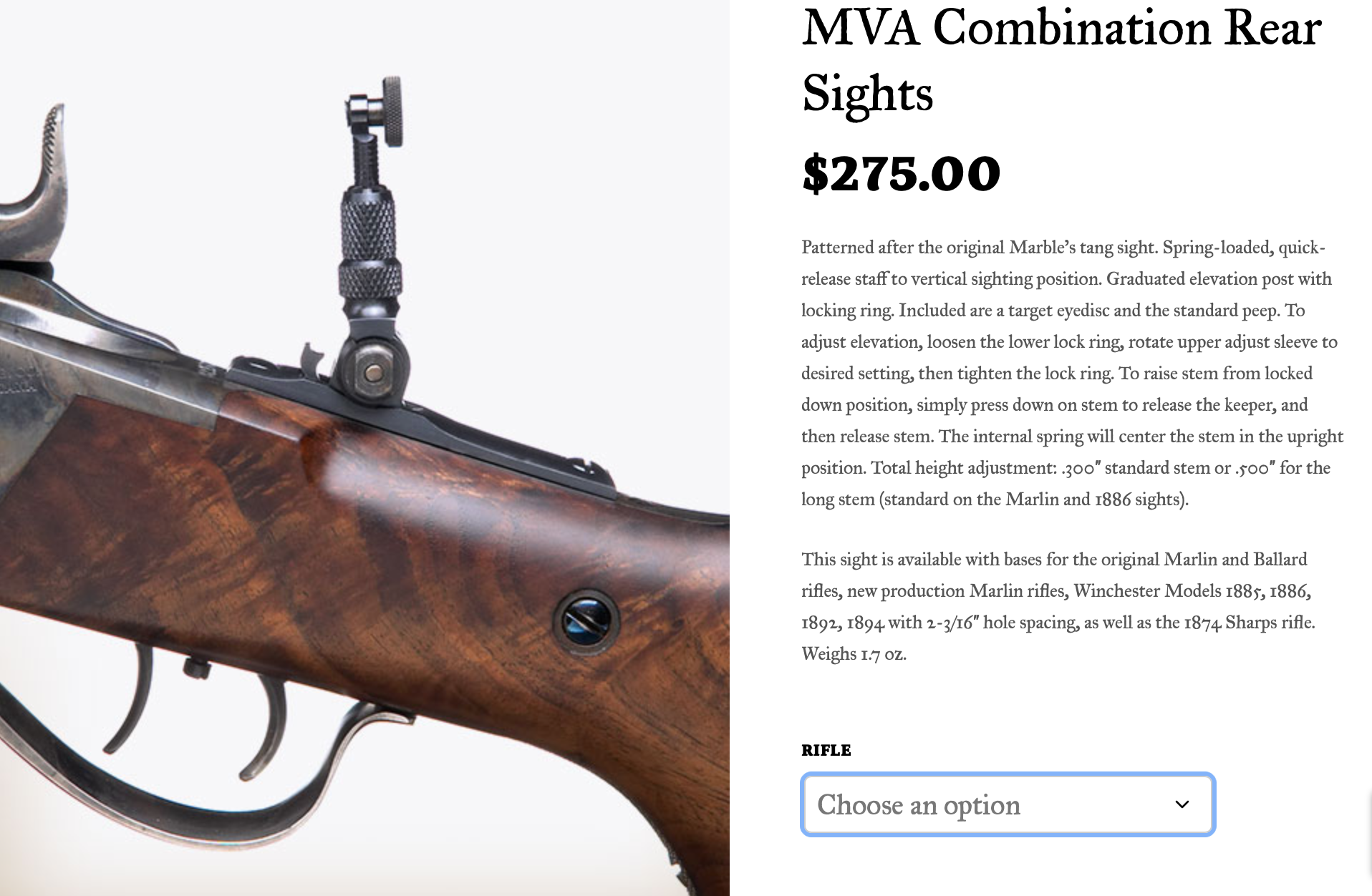

Nathan, your tang is factory-drilled so the tang sight made by Montana Vintage Arms is another option.  You do not need to alter your rifle, which is important with a nice 64 like yours.  Here’s a pic of the MVA sight mounted on a Model 64.
The MVA sight is patterned after the original Marbles folding tang sight and it’s a faithful re-creation.  Here’s a screenshot of the write-up on the MVA website and the link that will take you there:
https://montanavintagearms.com/product/mva-combination-rear-sights/
To answer your question, no, the sight won’t catch your thumb. When gripping the rifle to shoot, your thumb fits naturally behind the sight.
I have two of these sights and I like them a lot.  They’re cheaper than an original and better than the current Marbles production.  You can order the sight on-line from the company and have it in a couple of weeks.
There are are several options with different hole spacing and different tower angles for different vintage rifles.  Be sure you get the one for the Model 94.  (It’s the same as the 64.)
There’s one thing you should know about the MVA sight (and the original) – they are not windage-adjustable.  Normally, if the gun is shooting to the left or right, you drift the front sight the opposite way.  You can’t do this with a Model 64, which means you may have to shim the tang sight.
My tang sight is shimmed.  I used a piece of light copper wire and flattened it to the desired thickness, then inserted it under the left or right side of the mounting block, as the case may be.
Adjustments like these are by trial and error.  They can be a pain in the ass to get sighted-in but the good news is, once they’re sighted-in for windage you won’t need to adjust it again.
For elevation adjustment, the MVA tang sight is a dream.  You just screw the dial up or down.  Like Quigley Down Under.

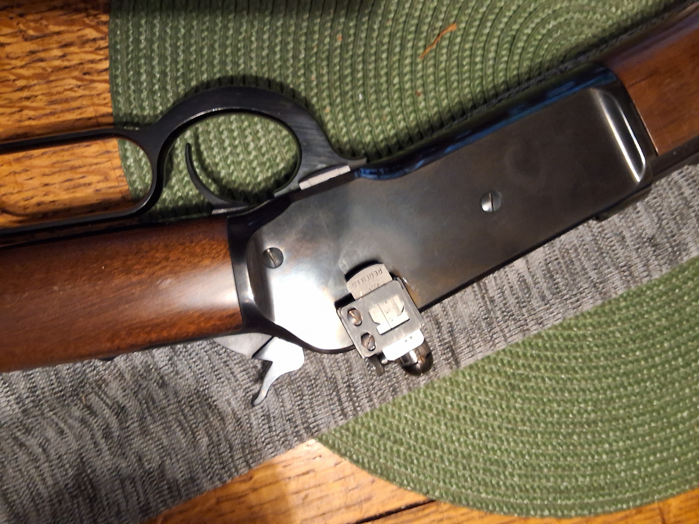

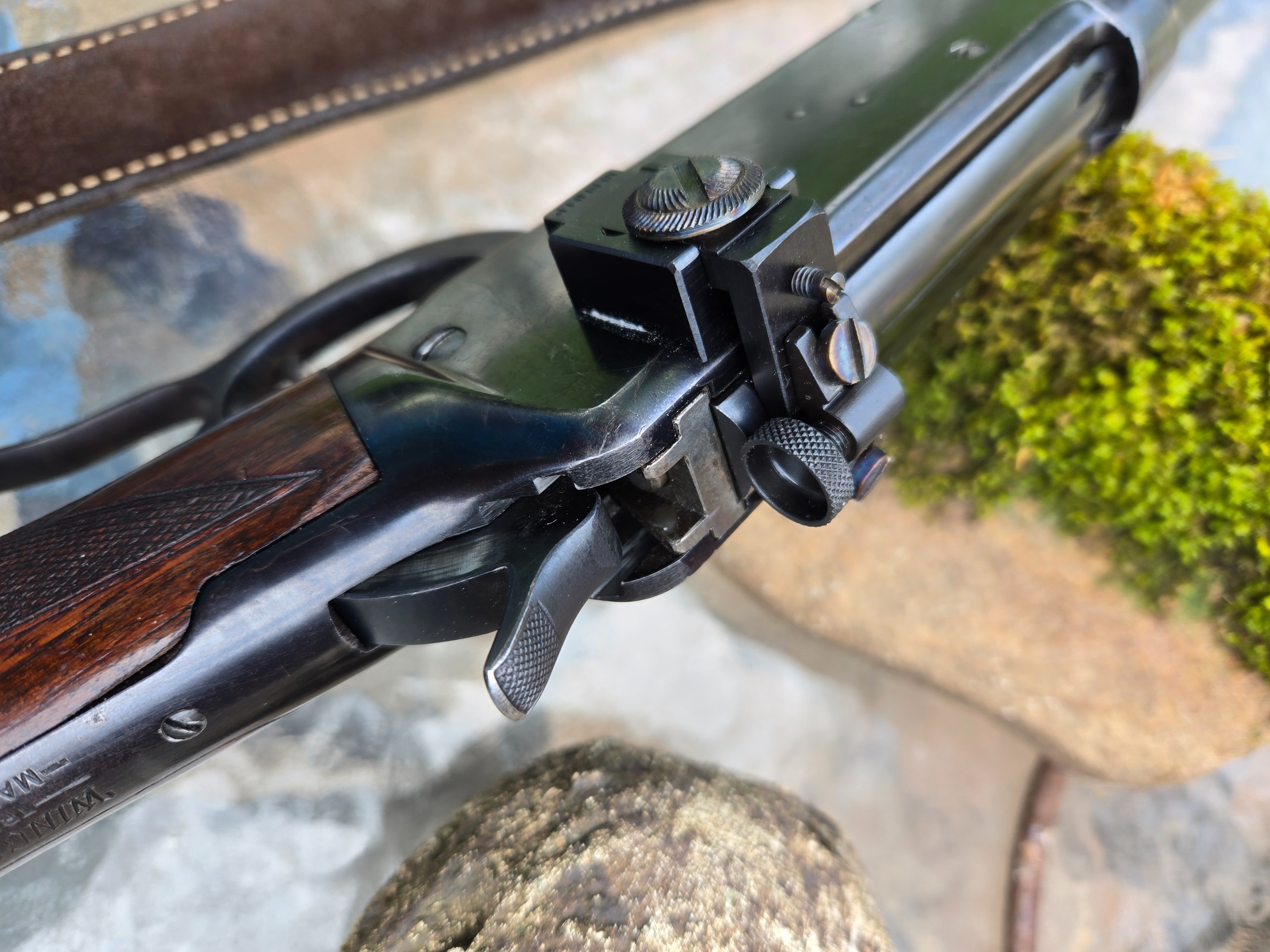

I ended up putting a skinner barrel mounted sight on my model 92 and a Redfield 102 on my model 64. The skinner is fantastic and only took a few rounds to sight in, I used the next size aperture down from the one he suggests. The Redfield was a little more challenging with the two opposing screws to move around but not bad.
