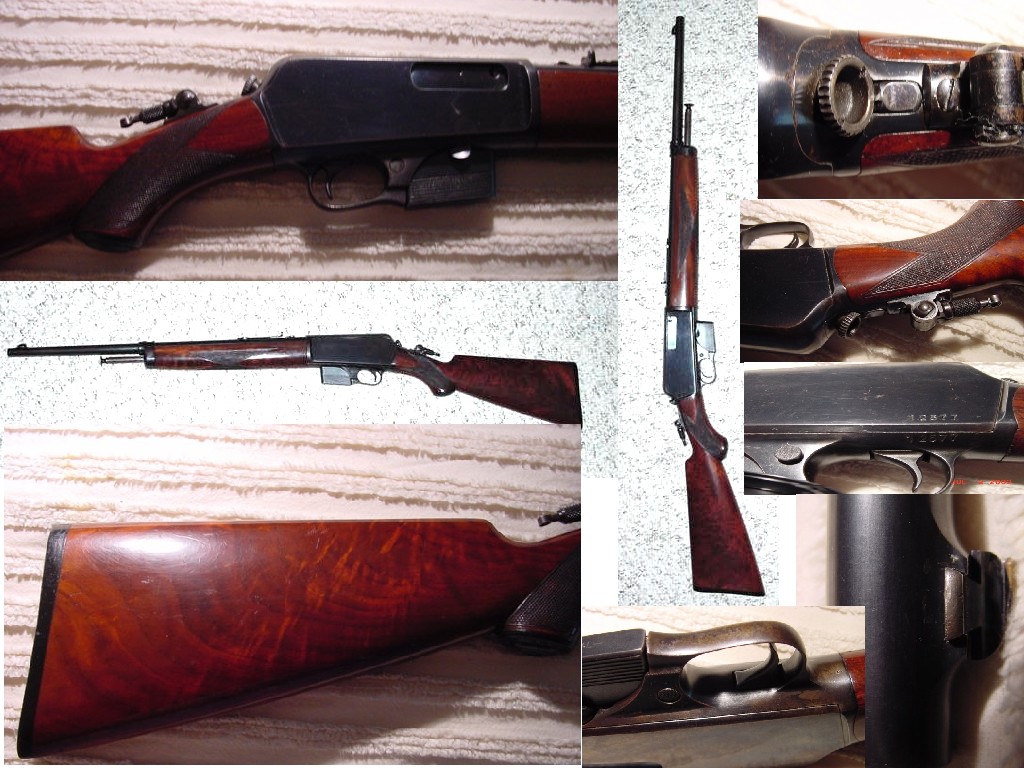

Good morning, Don and Steve.  The only thing I would mention, from an abundance of caution, is this:
I’ve owned several of these self-loaders over the years, one Model 05 and the rest 07s. The only one with a tang sight was an early deluxe 1907 and it was one of those on a flexible stalk.
I’ve shot a couple of the 07 military style rifles with the wider butt and factory open sights, with period factory ammo. As I’m sure Steve knows,  the recoil from an 07 is disproportionately heavy. I never fired the early deluxe  because it had a pretty but skinny, narrow stock of finely checkered burl Walnut and matching forearm I’d already repaired once. The tang sight was pretty close to my shooting eye and made me wonder if inertia would keep the stalk out of my eye. Win07composite_2.jpgWin07composite_1.jpg
