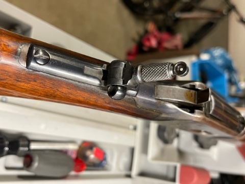

Hey all, I have what I believe is a Lyman #2 tang sight on an 1894 and am getting it squared away on this rifle. First off, can you all confirm that it is in fact a #2, and second, I need help with ideas on how to get the knurled barrel to turn. It doesn’t seem to want to budge and I sure don’t want to force it. Is it safe to use WD40 or something similar to see if it will penetrate?
Markings include the patent date just under the knurled barrel Pat Jan 29.79- May 6.84, and it has a D under the base which I believe was for an 1892? DA being for an 1894?
Thanks for the help all

No, a No. 1; the No. 2 had a large eye-cup or disk.  Appears to be in excellent cond., but turned down tight to lowest position.  The fold-down aperture is the part that usually sticks.  Why don’t you just take it off & submerge it in a small container of carb cleaner?

Thanks Clarence, would it be a number 1, second variation then? I’m embarrassed to say I didn’t notice the flip down aperture, and I’m still learning a lot. Also would help if I put on my reading glasses.
Taking it off now to start soaking : )

Early Lyman catalog illustrations always show this in the “down” position, because Wm. Lyman strongly promoted use of the larger aperture for hunting.  Before the #2 came along (1898-9), there was no “No. 1”–it was called the Lyman Combination Sight, because (according to Lyman’s patent description) the turn-down ap. was intended to be used for target shooting, the larger ap. for hunting, therefore making it a Combination sight.  Few customers, evidently, paid any attention to these instructions & left the turn-down in the “up” position, which after 100 yrs of neglect, is frequently stuck.

Clarence, are you telling us that the round eyelet acting as a pivot is another aperture for this sight?
August 17, 2022 - 3:49 am
Exactly, two sizes.

Like I said, it may be stuck tight against the larger ap by old dried oil or corrosion, so using a punch slightly smaller than the large ap, force it backwards, i.e., towards the muzzle.  Wouldn’t hurt to soak it in carb cleaner first, but it may come free by pushing alone.

Well I soaked this sight all night in WD40 and the knurled barrel of the body still wont budge. I do have some brake cleaner here (no carb cleaner) but I hesitate to soak in that, scared of ruining the finish on the sight. I don;t think I want to grab hold of it with a pair of pliers. Even carefully, but I’m not certain how best to proceed

I would continue soaking it and trying to break it free.  If you wrap a rag around the barrel you can carefully grab it with some smooth jawed pliers.  Don’t force it just try to rock it back and forth a little.  With the rag still wrapped around it you can take a small brass hammer and tap it a few times.  Eventually it will break free.  Just be patient and don’t force the issue.

Use a strip of leather & you won’t need the smooth jawed pliers–I’ve done it many times.  Smooth jawed pliers generally have parallel jaws, which don’t grip as well as the curved jaws of regular pliers.  WD 40 is not the best solvent, if dried oil is why it’s sticking.  Better than carb cleaner for dissolving any kind of petroleum product is lacquer thinner, which won’t harm a blued finish.

I have some paint thinner and also VM&P Naptha here, no lacquer thinner. Ok to use either of those? Pretty paranoid about harming the finish so if I need to run grab lacquer thinner I will

Sure, I’ve never heard of a petroleum-based solvent that would harm the blue, but LT will even soften dried epoxy.  By the way, rotate the barrel clockwise to raise the stem.

Success!!
Thanks for the help gentlemen, both in helping identify exactly which model sight this is and getting it free to function as it should!
I did end up soaking it for a few hours in Nahptha and then used a pair of pliers, which required very little force by that point to free the barrel. Also used a set of fine picks to clean out some gunk at the base of the stem as well as around the inside of the aperture.

Persistence rewarded!  (I was next going to recommend application of a Stilson.)
At some point late in production, precise date unknown to me, the Lyman name-marking was moved to the top of the base in large letters, but no other changes were made in the #1 & #2.  In 1905, two new models were introduced, 1A & 2A, which differed from the originals in being fitted with a locking lever in place of the spring-bolt–a blatant sales-gimmick if ever there was one, which did nothing to improve the sight.
I don’t know when they went out of production, but all models are still listed in the 1959 Shooter’s Bible, the first one I ever bought.  Probably wasn’t much longer after that they started becoming “collector’s items.”

I guess I have one last question in regards to this sight…When I raise the sight it doesn’t quite go to vertical. Is there a way to safely adjust this? Thanks

Yes–run a dowel rod, Phillips screwdriver, etc., through the eye of the spring-bolt & turn it to the vertical position.  Not my invention, this method described in the catalog.
