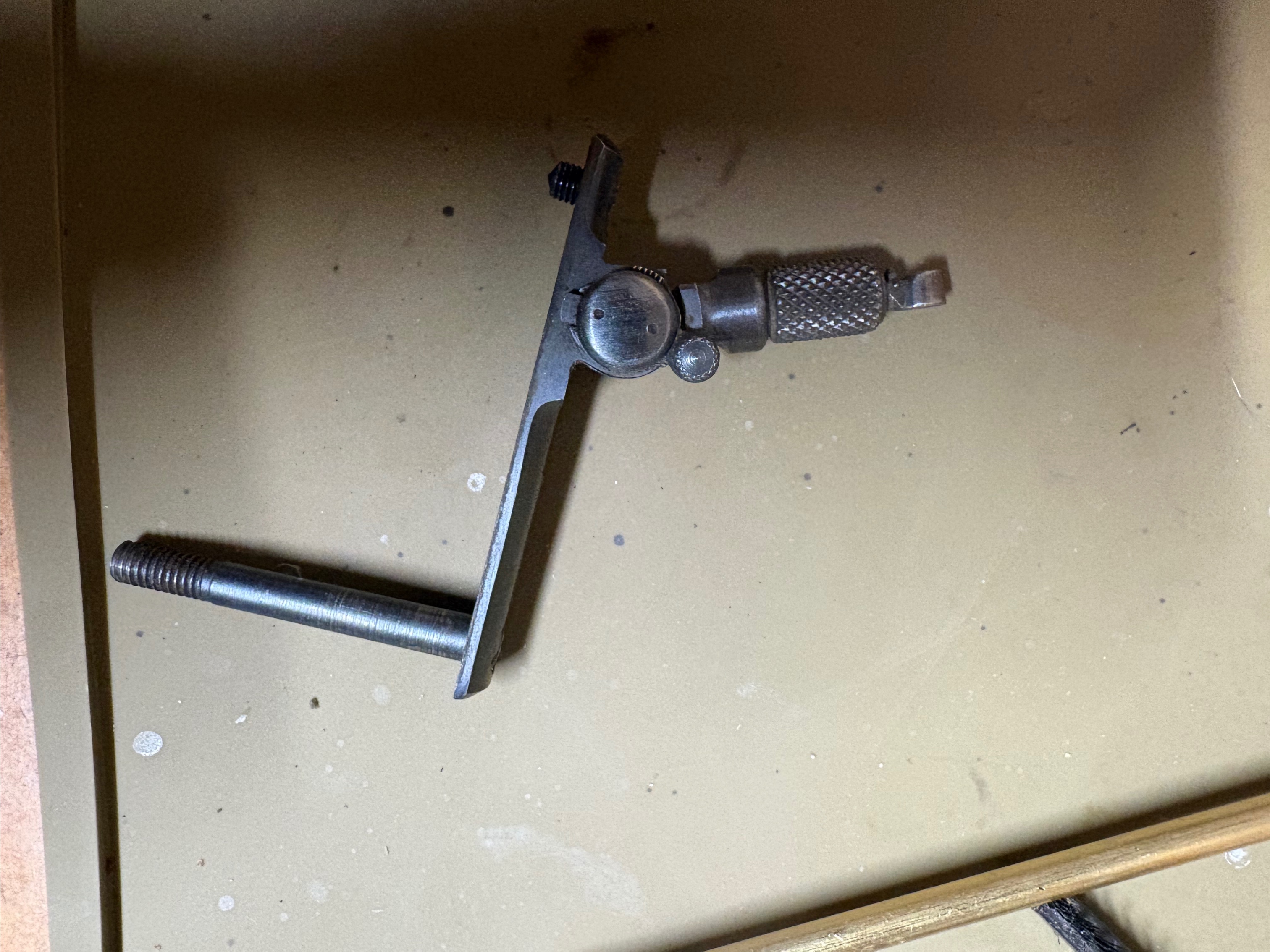

I picked up a ‘92 and a ‘94 recently, the 1908 ‘92 had this sight on it.  From reading through this forum it seems to be a 1A, D application code.  The 1950 ‘94 is d&t on the tang as well but missing a tang sight.  Am I correct that the same 1A would be the sight I need as they were in production until 1955?  Also in the meantime where can I find a plug screw for the tang? The empty hole is unsightly.

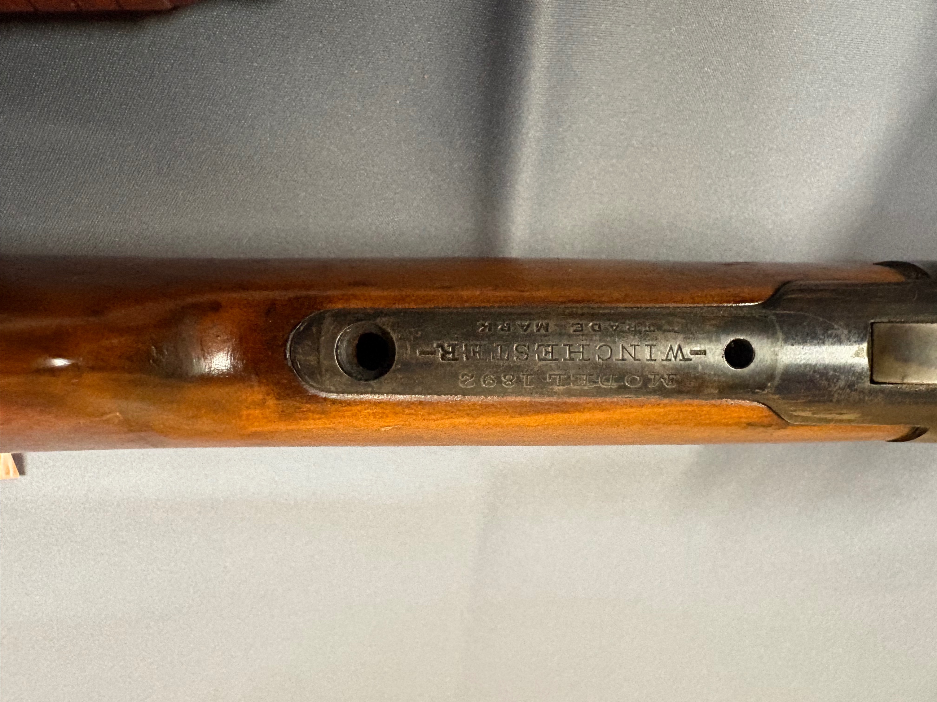

Here is the tang of the 92.  I posted the 94 in another thread on sight holes.
Forum Posts: 14863
January 17, 2026 - 4:48 am
The holes on your Model 1892 are factory original.  To the best of my knowledge, all of the Model 1892 (92) receiver tangs were drilled & tapped for a tang sight.
MidwestCrisis
Forum Posts: 310
January 8, 2025
January 17, 2026 - 5:04 am
Thank you Bert, I’ll get some more pics of this 92 up where appropriate. I’m thinking the tang sight has been there since the factory. The wood has been sanded and the saddle ring cut off. As well as a mail order replacement barrel.  Would it be worth it to get a letter?
