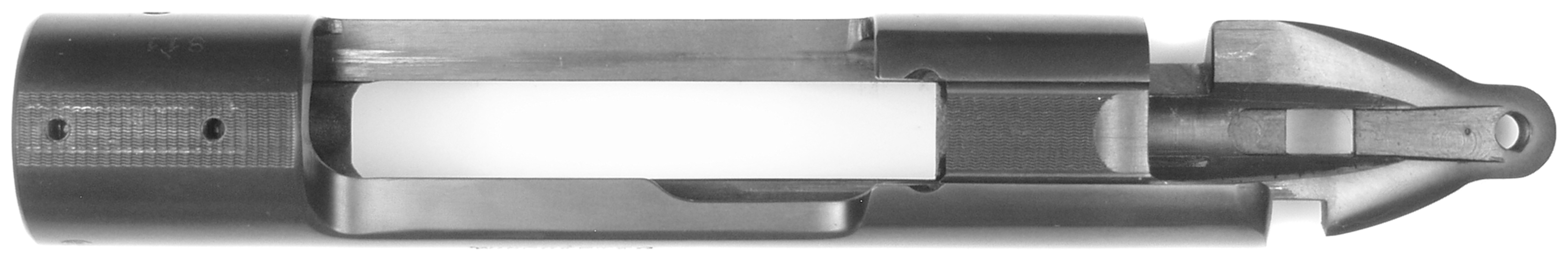

Hopefully someone can answer my question about Leupold Detacho bases for a Pre-64 Model 70 Featherweight in .264 Win Mag with a serial number of 54,000. Can I use the base numbers of 209 and 315 or are those for serial numbers above 66,000? thanks in advance

The 264 WIN MAGNUM was first made in 1959 and first appeared in the catalog with the Standard Westerner in 1960.  The 264 WIN MAGNUM Featherweight Westerner was only cataloged in 1963, but most were made with 1962 receivers in the 540XXX serial number range.
If your rifle S/N is really 54,000 range (not 540,000 range) then it is a non-factory custom re-barrel conversion to Short Magnum built on a pre-war receiver.  Such things did occur.  Thing is that I don’t think that the Leupold Detacho mounts were ever made for the pre-war (under 66,500) receivers…
So the first thing is to figure out what you have…  The first picture is of a pre-war Standard receiver (c/w your stated 54,000 serial number), which could have been converted to short magnum.  Note the bridge with clip slot, roll marked, and undrilled bridge (these were often drilled for scope mounts outside the factory but this is what they looked like from the factory):
This is a Short Magnum receiver circa s/n 500,000.  The original Featherweight Westerners (circa s/n 540XXX) used this receiver. Note the smooth bridge with two factory D&T holes:
If your rifle looks like the second picture, then the Leupold Detacho mounts for M70 receivers above s/n 66,500 will work.  Standard and short magnum receivers in the pre-64 M70 were the same length and used the same hole spacing.  If it looks like the top picture then you’ll have to figure out what hole spacing the non-factory gunsmith used and go from there.

Lou thank you so much for the feedback. Yes, it was a typo on my part! Serial number is 548,000! I sat down at the bench yesterday afternoon and attached the Leupold Detacho bases 209 and 315 I had and they fit wonderfully. I topped it off with a Leupold Westerner 8X scope and am now ready for some ammo. Thanks so much for reaching out and have a great day. By the way the rifle is in 99% condition with one tiny hairline scratch on the comb and it is definitely easy on the eyes!
