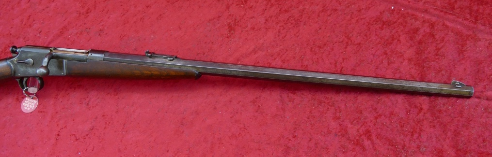

Several months ago, I started a post regarding a Winchester – Hotchkiss 1883 sporting rifle that I acquired. The rifle is currently with Mark Douglas who will be performing restoration services and a re-barreling.

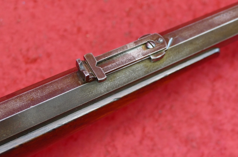

I am a novice when it comes to all the details about Winchester rifles. I will need to replace the front sight which is not original. The rear sight that came with the rifle is of a ladder configuration.
I assume that the original site would have been a blade but was wondering if a Beech site could possibly be an option to use.  I shoot my rifles recreationally and I hunt with them. I’ve never used a Beech sight, and I was wondering if it would be a good option to try in this situation.

Hi Bob thanks for your response. As far as I can tell, the front sight should be dovetailed. Here’s a link to my other thread:
Just Purchased: Winchester Hotchkiss 1883 Fancy Sporting Rifle | Winchester Rifles | Forum | Winchester CollectorWinchester Collector
Thanks for your input regarding the delicate nature of the Beech sight. Obviously not a good choice for PA deer hunting.

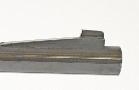

It does not look like you have a dovetail on the front. Its a ramp sight but I’m not sure how its attached. I edited a photo from your posts and lightened it up. Its spelled Beach at least Winchester spelled it that way in their catalogs.

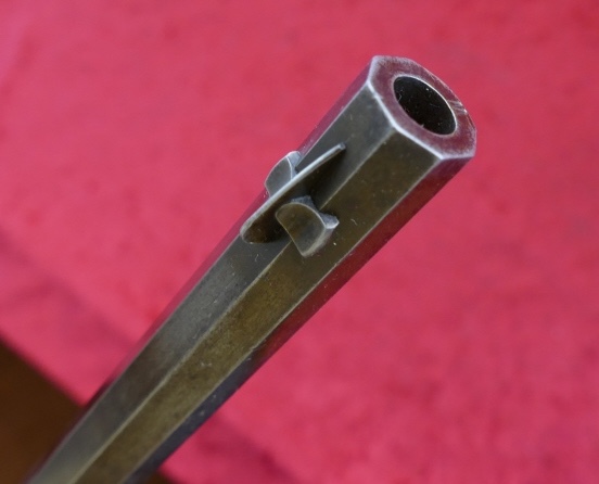

This is a sporting rifle I have, with a sporting Leif and rocky mountain front. The same sights that were offered on the 1876IMG_3536.jpegIMG_3535.jpegIMG_3531.jpeg

Mark will be replacing the barrel to bring her back to the original configuration. She letters as originally having a 28-inch round barrel. Apparently, Mark has had a job of it trying to find somebody to replicate the contour and rifling twist.

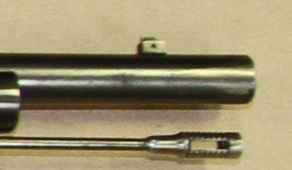

I don’t have a commercial Hotchkiss but here is what the Military front sight looks like.  Rifle and carbine used the same front sight.
If you use a barrel with a front dovetail you could use the Beach.  Usually it is just a blade.

My rear sight looks just like the one that cj57 posted. Looks like I will be looking for a Rocky mountain style sight. I’ll talk it over with Mark.
