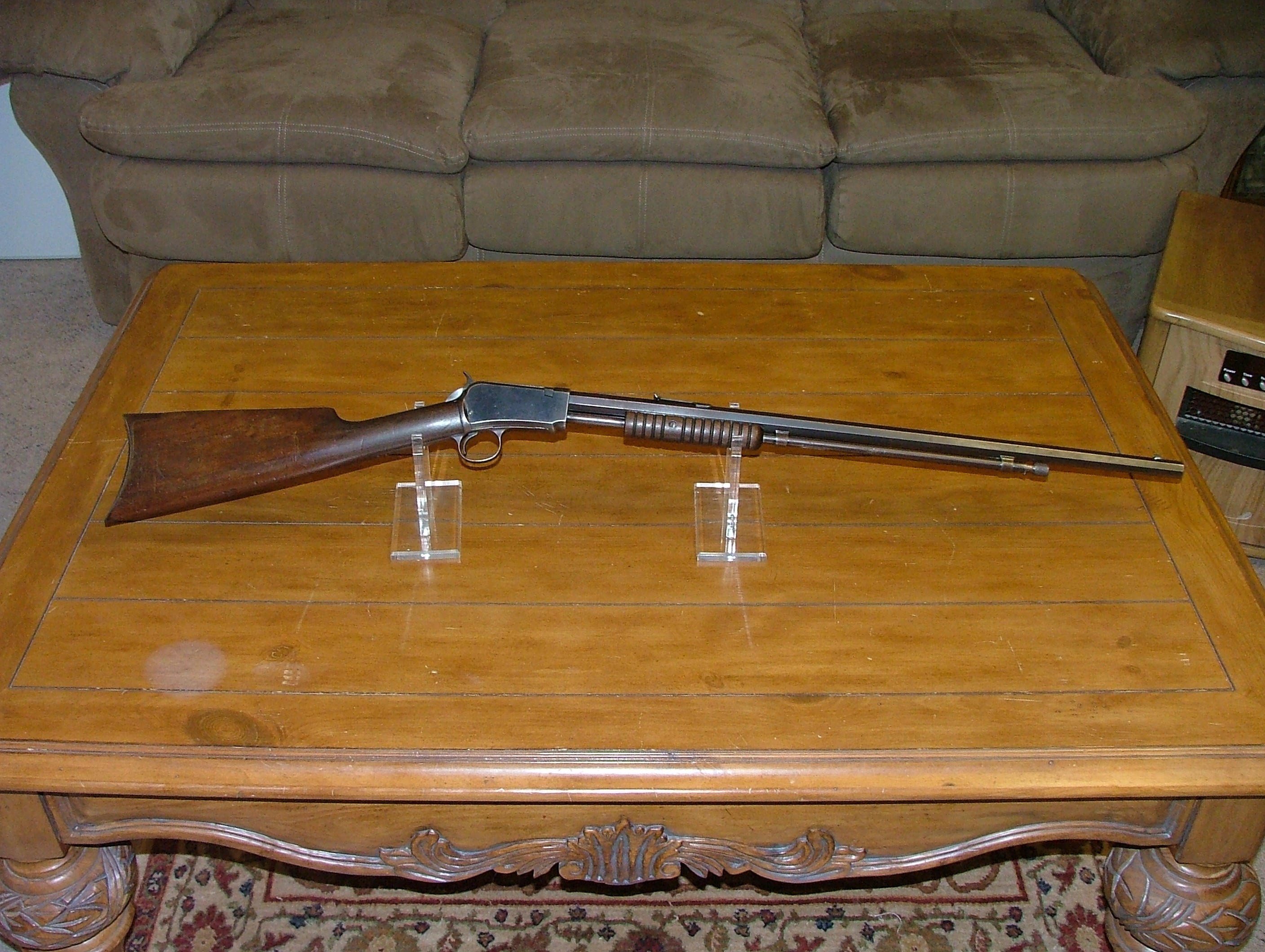

32A “Sporting” rear barrel sight for an 1890

I’ve taken my rifle out in the daylight and showed it to a couple other collectors. After a close inspection, we all agree that there is sight elevator wear on the barrel behind the rear sight dovetail. The wear is back near the rear of the pump slide handle (roughly where your elevator is in the above photo). Here’s a couple crummy indoor photos with bad lighting:
http://i.imgur.com/yllcboU.jpg
http://i.imgur.com/h6DsY9b.jpg
Thanks again!

Joel,
There were at least 5 Sporting Rear Sights very similar to the ones you have pictured in your original post for the 1890/90. Then there was one as pictured at the bottom of page 118. All of these sights were special or extra cost items.  Each of the elevators on these sights would leave a wear pattern much different than the two pictures that you have posted, in that a long slender wear pattern would be typical.  Rustyjack is correct about the 30A type sight you need to be period correct.  A 30 B would be period correct as well.  Either one would have the V notch.
