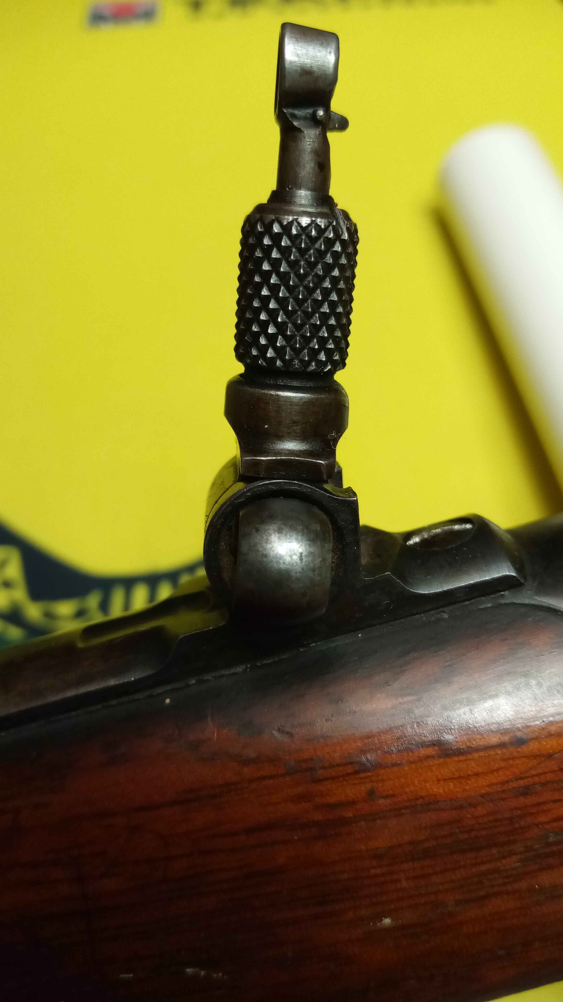

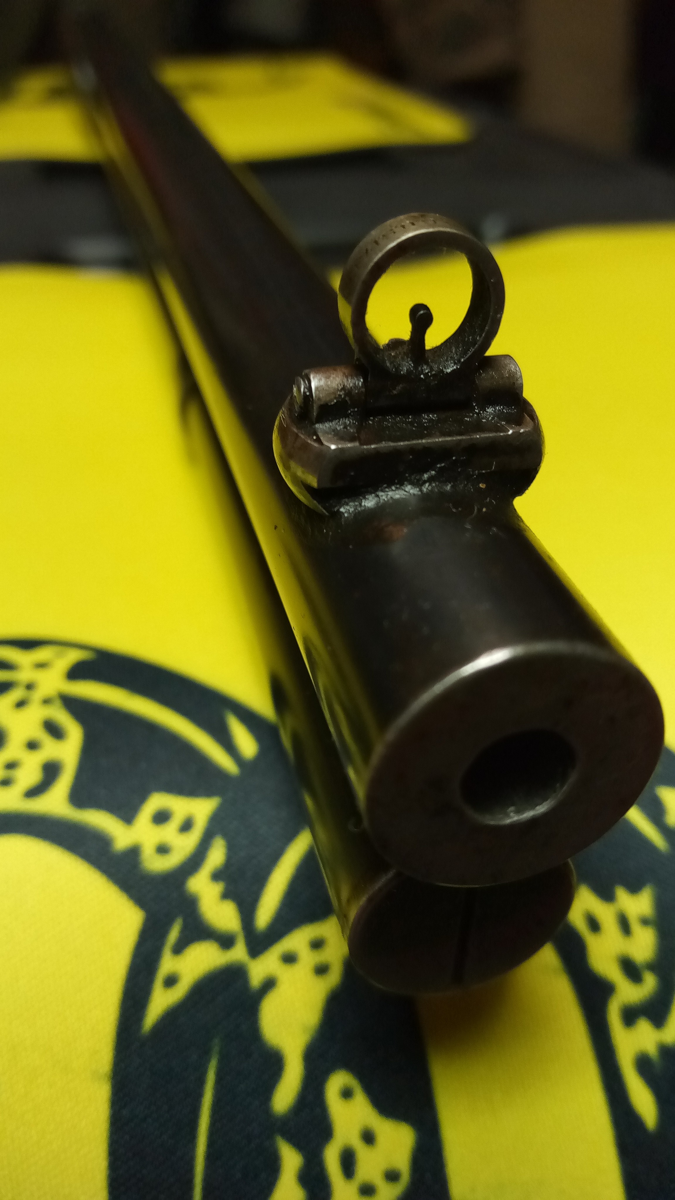

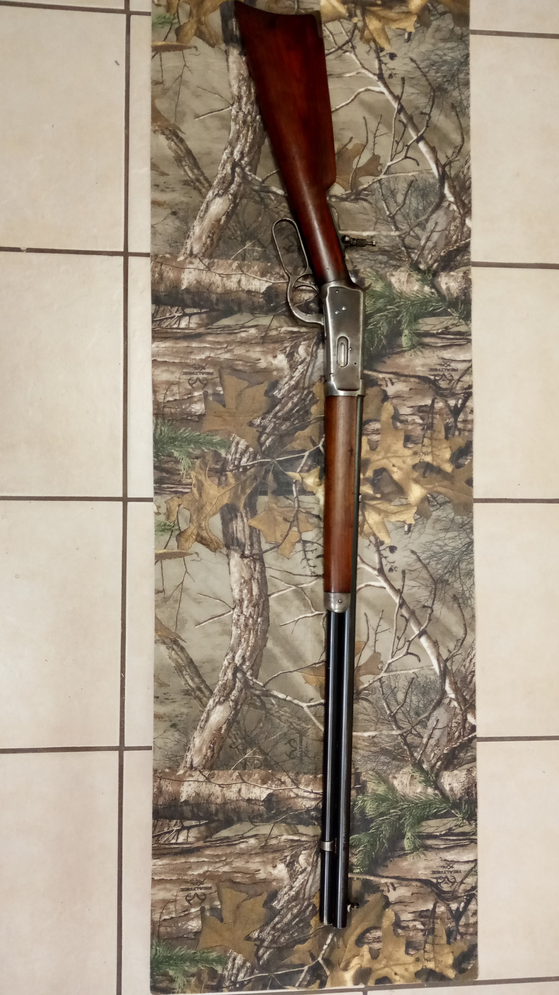

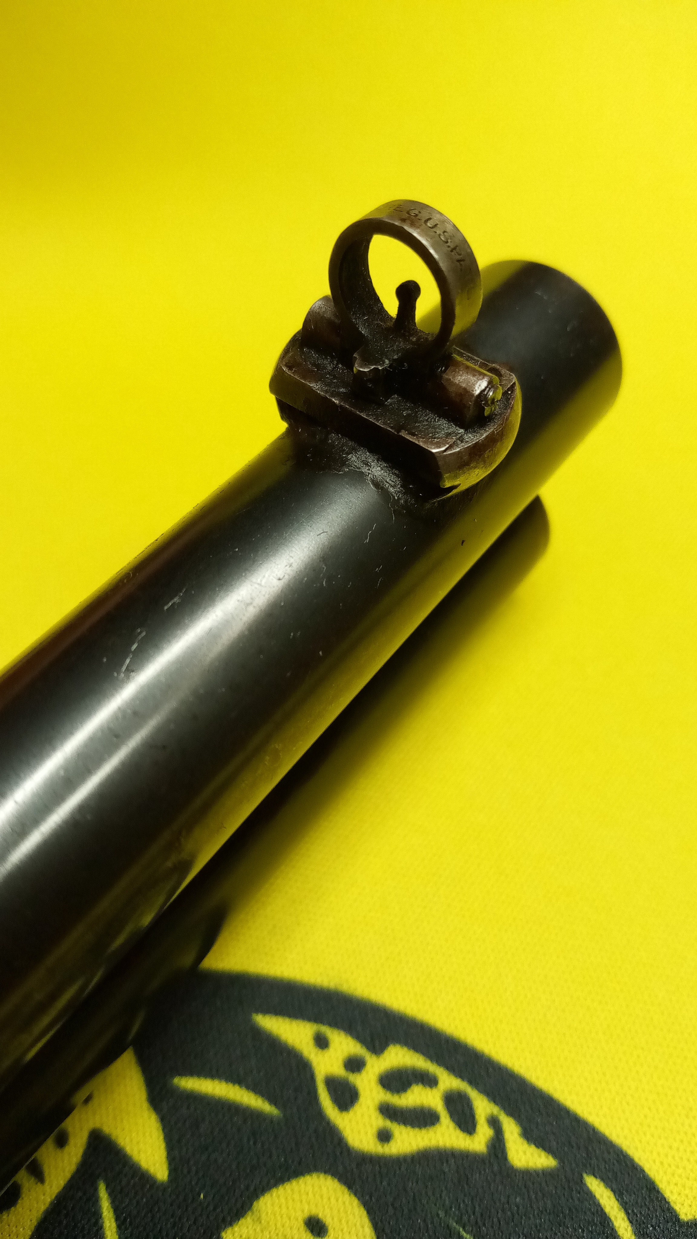

1917 vintage Model 1894 rifle in .25-35 WCF with a Lyman #5 front sight and Lyman #1 tang sight (flip-up aperture). Rear barrel dovetail is blanked. Does anyone know if these sights were available as factory options during this time or were they likely added later? I’m thinking that the Lyman #1 tang sight might be from an earlier timeframe before they moved on to the threaded aperture design.

The odds are very high that the Lyman sights were installed by a past owner.  If Winchester had installed (special order) a Lyman tang sight, it would have been a No. 1A (or a No. 2A) versus the older No. 1 that is currently on your rifle.  The 1A and 2A tang sights superseded the No. 1 and No. 2 sights approximately 10-years before your rifle was manufactured.  What is the serial number on this rifle?

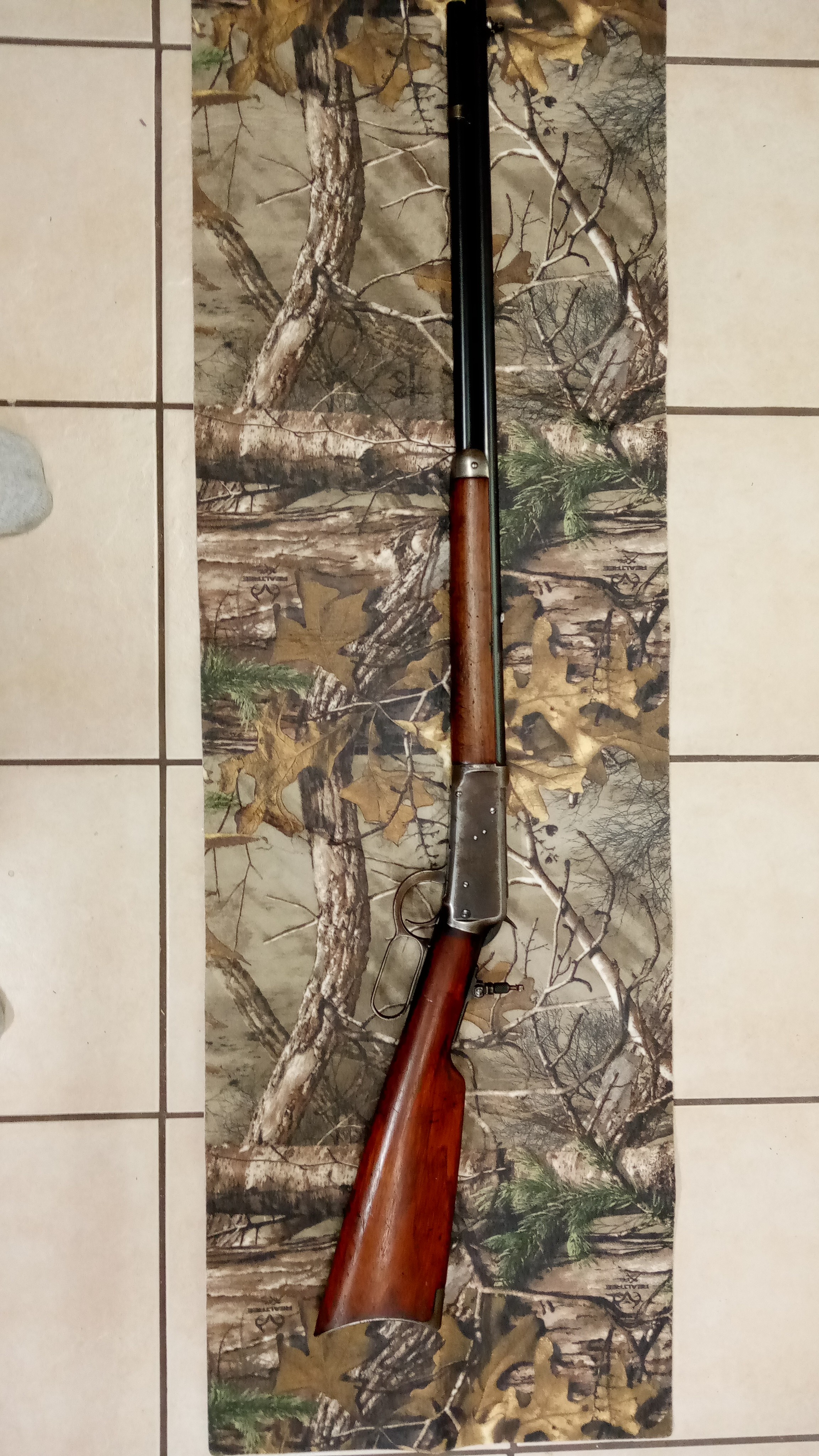

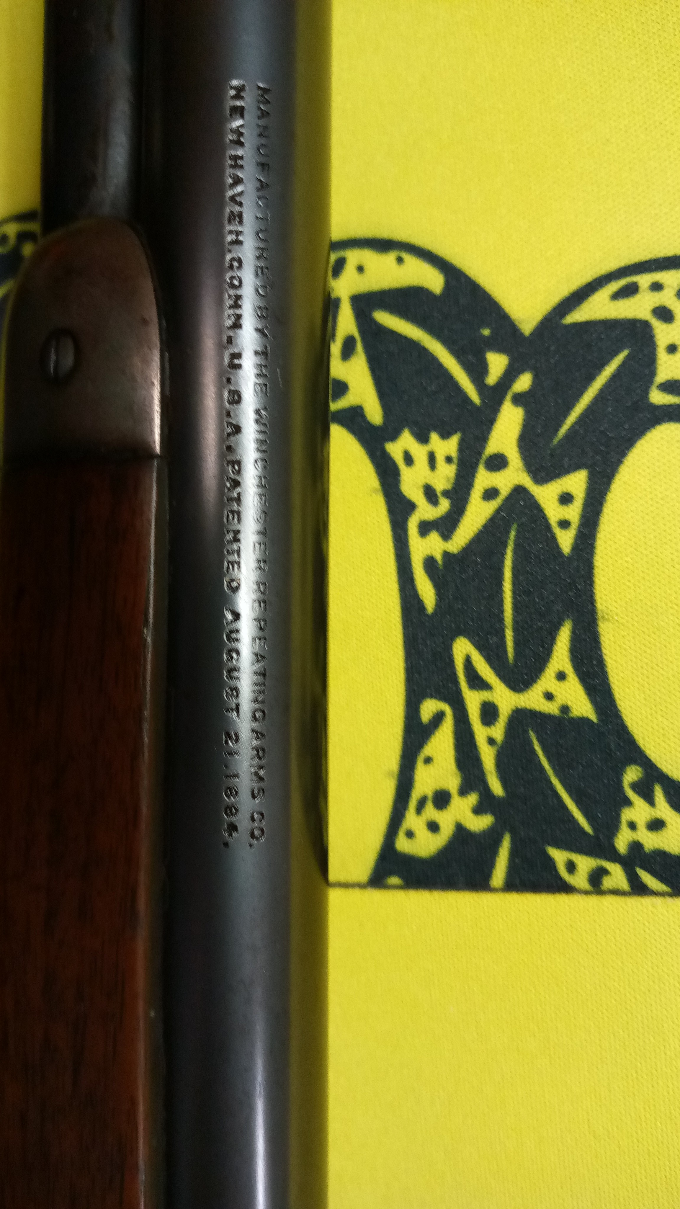

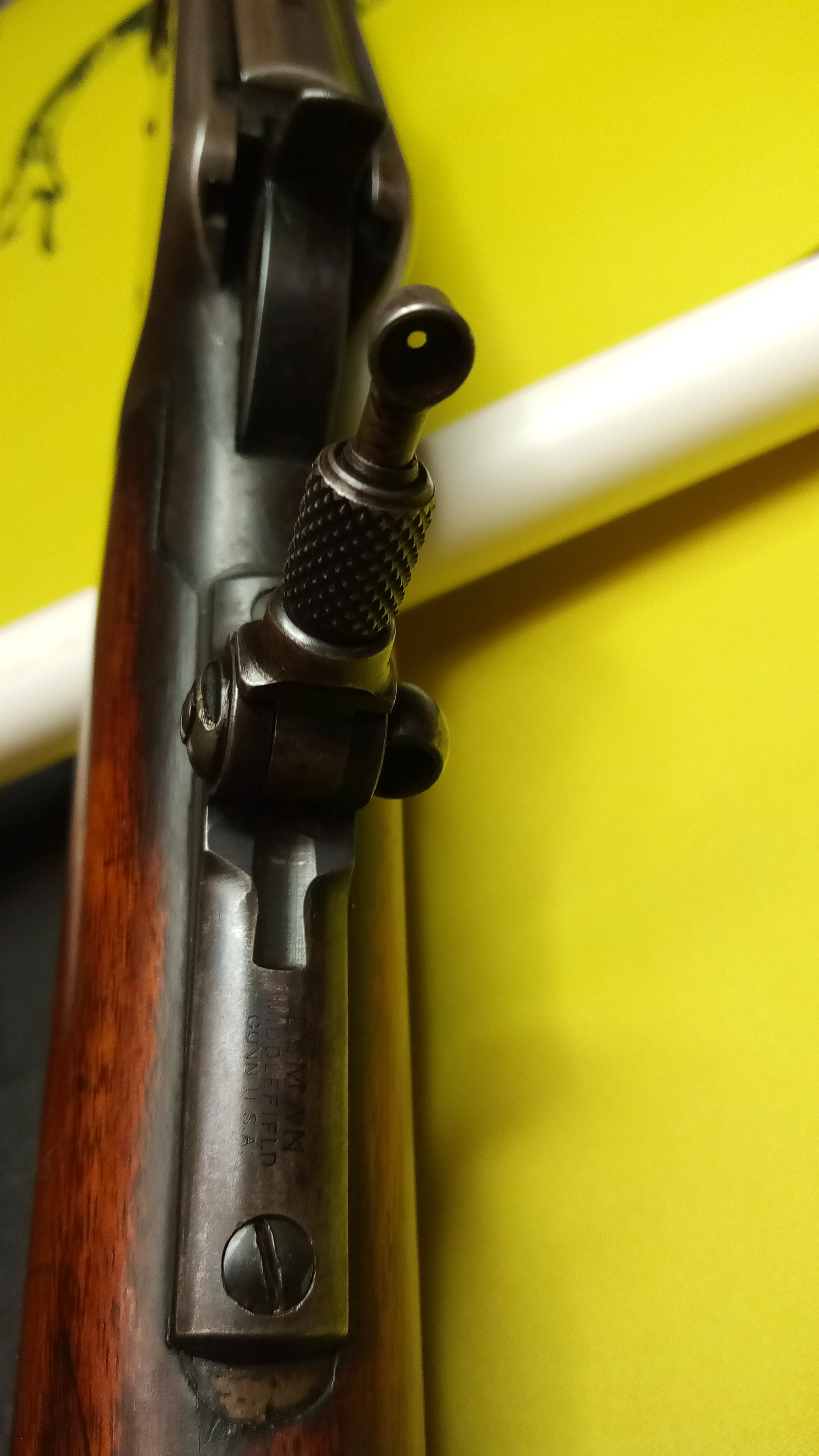

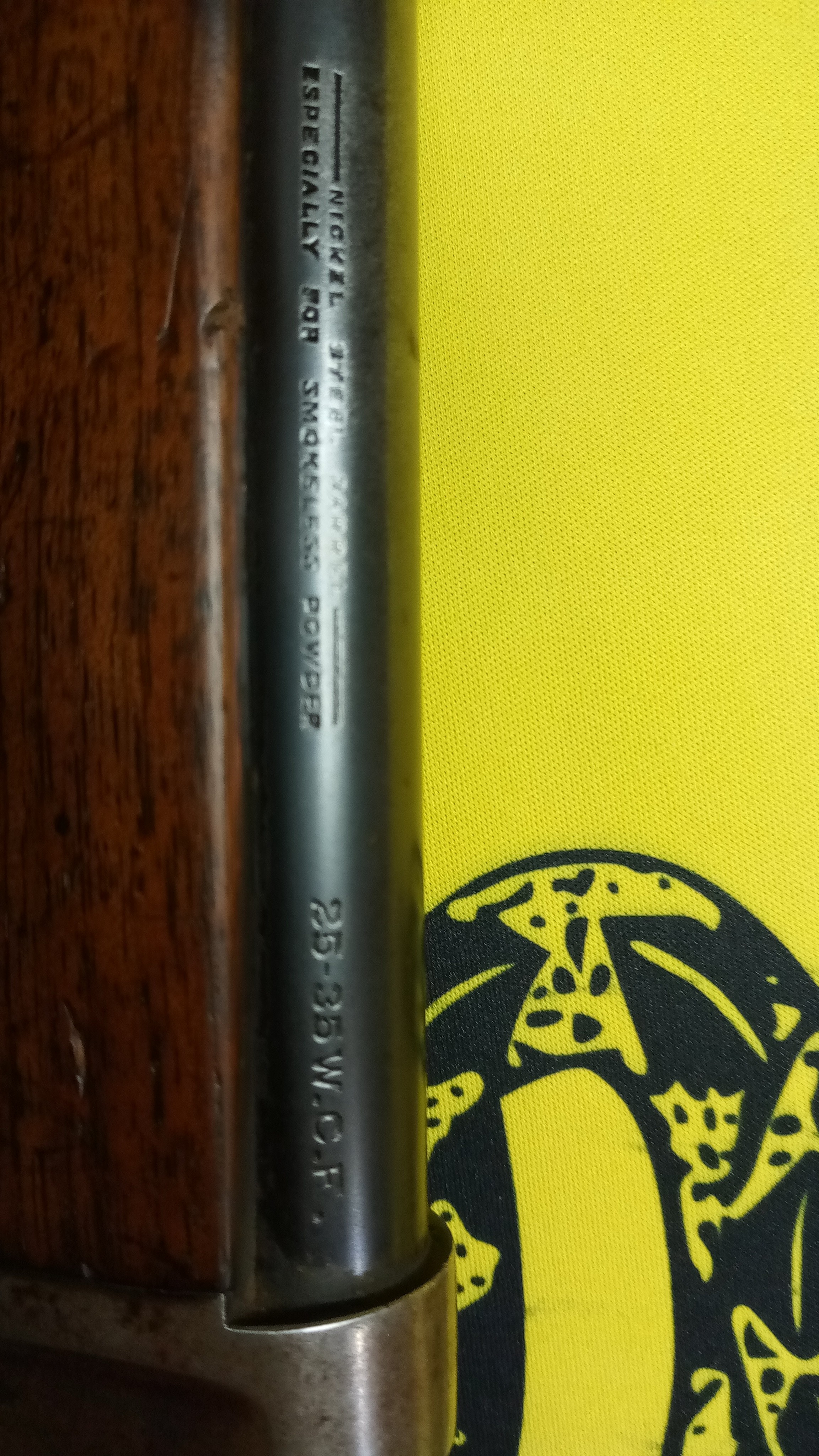

Photos of subject rifle. I appreciate all your help.

Thanks, a standard Sporting Rifle in decent condition with upgraded sights.
