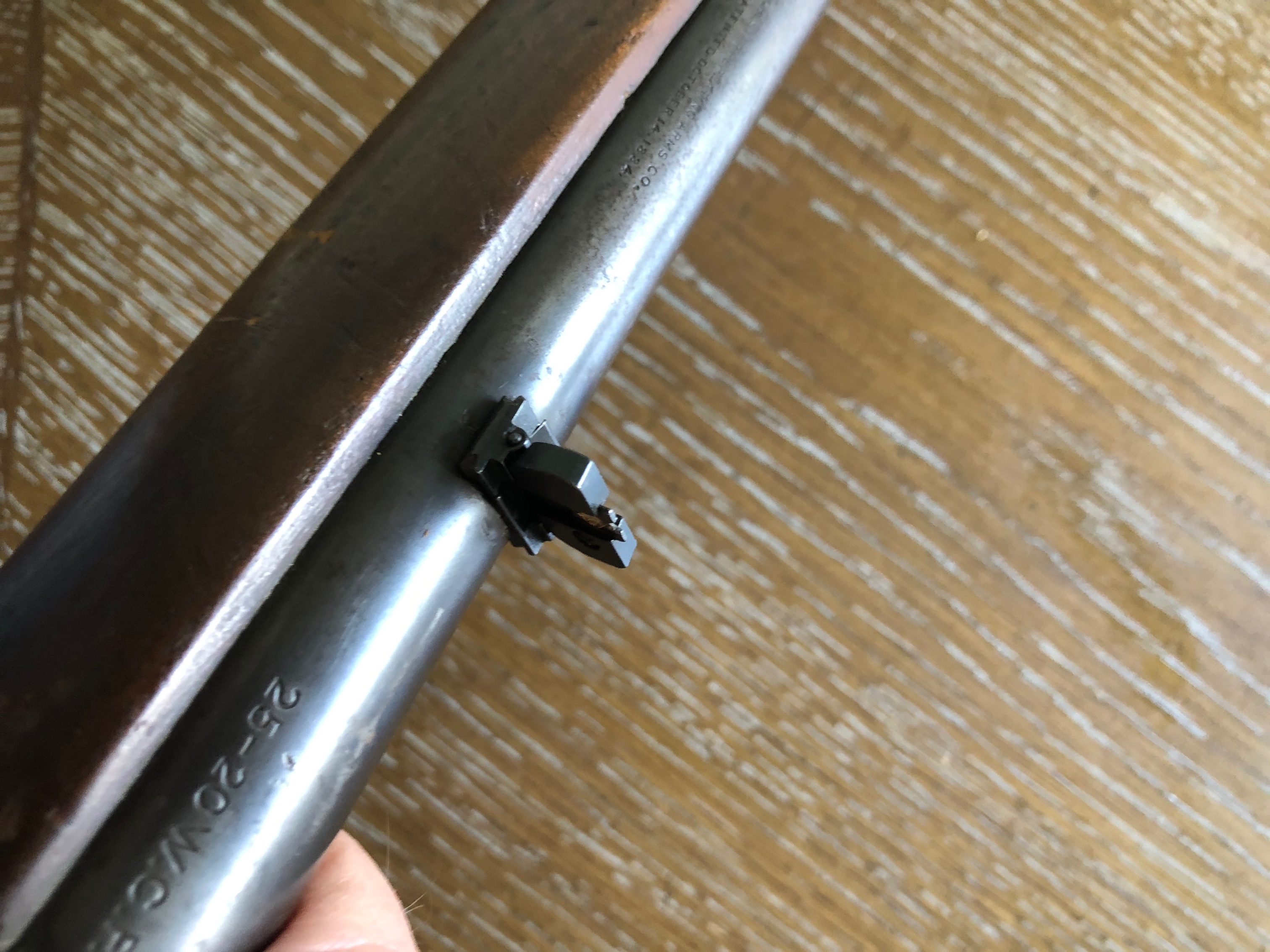

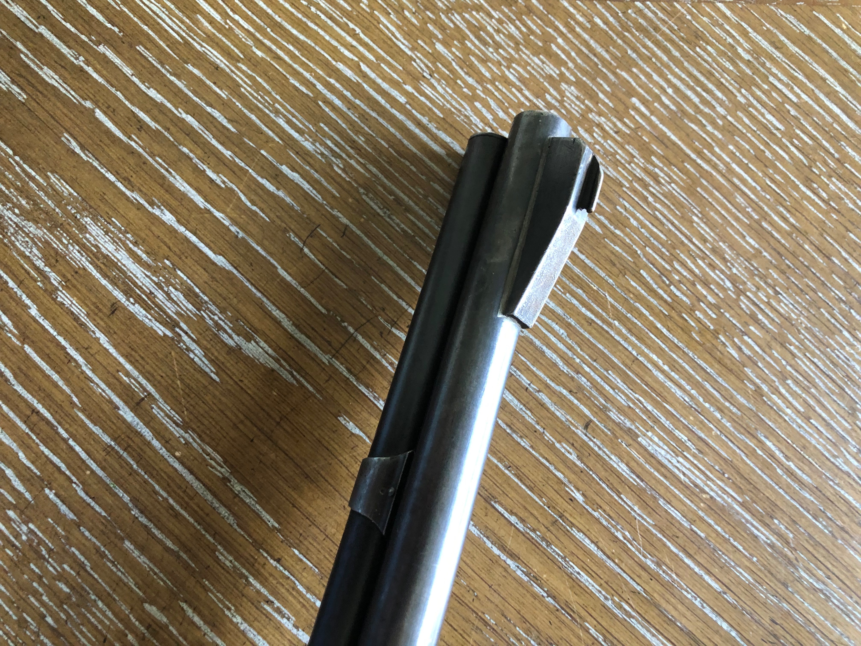

Good afternoon all. I have a model 1892 SRC manufacturers in 1914. I have not seen the sights on carbine in any pictures of the 1892. Are the sights shown below original to the model? The front sight is soldered to the barrel while the rear sight is folding and mounted into dovetail in barrel.

Those are positively not factory original sights on a Model 1892 SRC.

Thanks Bert. Not the news I wanted to hear but it is what I suspected. Carbine is a good shooter though so not a total loss. Thanks for the advice on the plug screws also.

You can pretty plainly see the linear loss of bluing on the top of the barrel where an original carbine leaf sight was located.  Can I get the serial number of your rifle so that I can add it into my research survey of the 1892’s?
