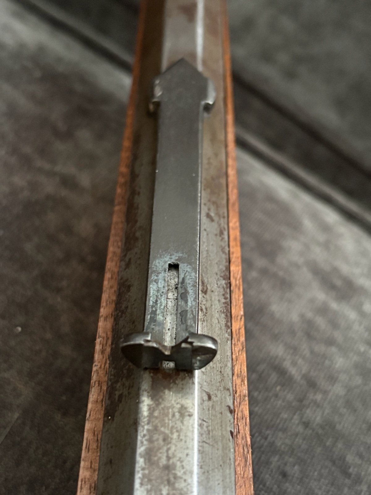

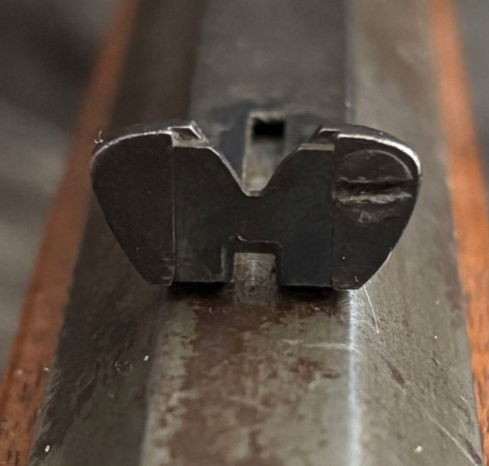

I have an 1873 in 44-40, manufactured in 1886 that is missing the rear elevator. The rear sight blade has a screw in the upper right corner. I have not seen a picture of a rear sight with the screw in this position, most look to be centered on the right side. I am looking for information if this is original and what specific elevator would be correct for this rifle. Any information is appreciated.

The sight sounds proper…  you need a “black powder” elevator.  It doesn’t have the wide serrated “thumb” end .

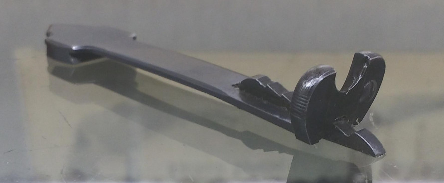

This is the one that would be on the 73.
You can send me a picture of it at my email below but you could have a flat top type which is a filed down standard sight.
Forum Posts: 4995
November 4, 2025 - 12:06 am
John,
Here are the sight pictures. What you have is a later Marlin sight. They used a thinner elevator than Winchester. The later sights had the adjustable sliding insert which this one has been filed down some.
