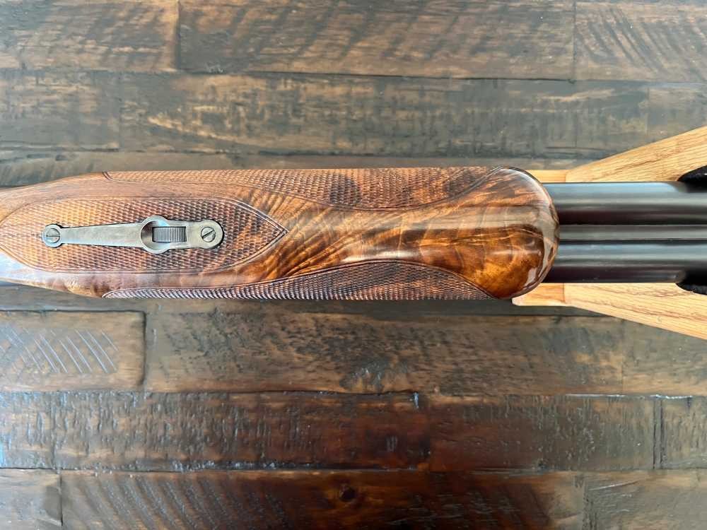

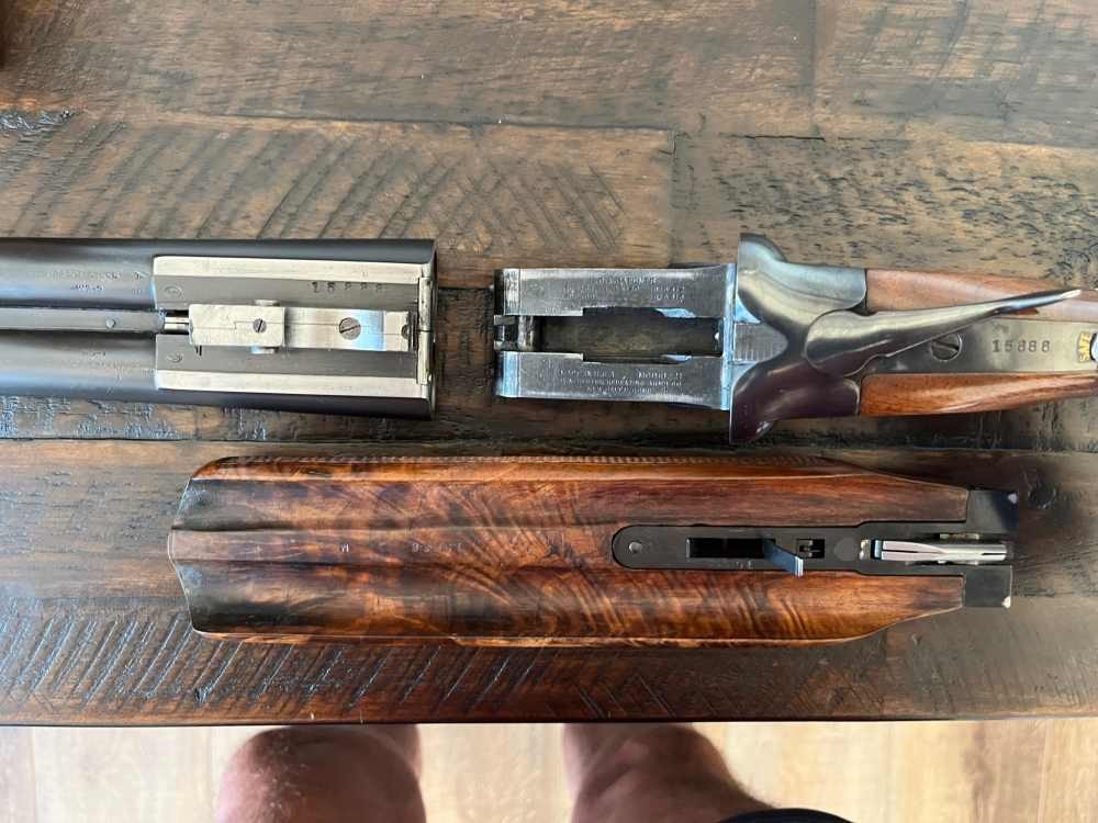

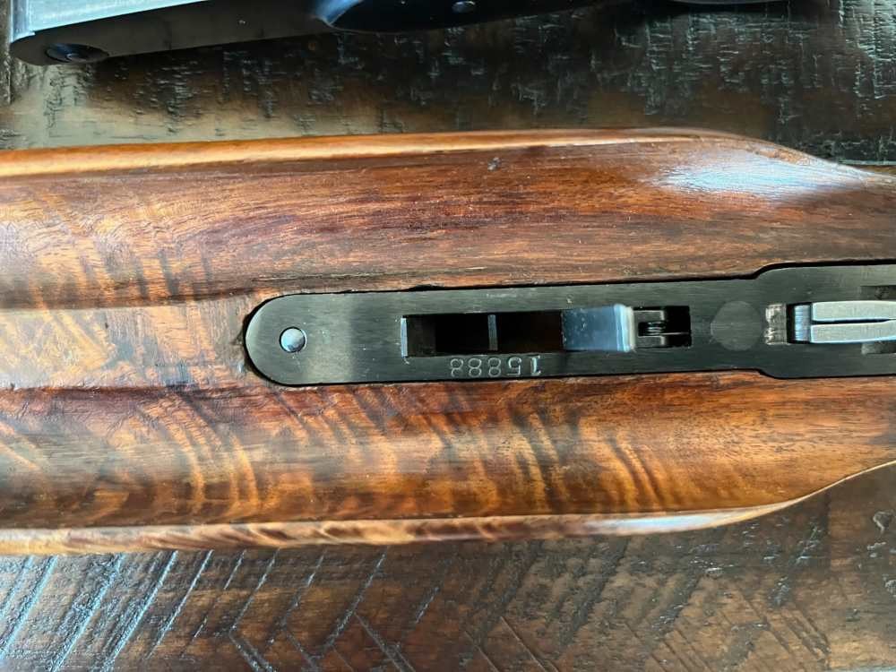

Back home, I was unable to find an exploded drawing of the Model 21 forearm assembly. Lots of illustrations of the receiver only. However, the “Tennessee Gunsmith” has a long, interesting video illustrating the job of making a replacement forearm from scratch for a Model 21, the original forearm of which had been cracked. I learned several things:
1.  The leaf spring of concern is called the “forearm roller latch spring”. It holds tension on the latch when closed. The tip of the spring fits into an angle of a protrusion attached to the bottom of barrel set.
2. Mine is not broken but the reassembly should always  be undertaken carefully, to avoid cracking off very expensive wood or distorting the spring.
3. The Model 21 should not be taken down unless the hammers are cocked. Doing so with uncocked hammers greatly increases the risk of damage if you are hamhanded.
4. The milling required to create the forearm latch inletting is complex, multilayered,  requires an extrordinarily high level of skill and is very time consuming, compared to any other forearm design this gunsmith had seen. The work he turned out was beautiful but the price tag must have been frightening.
The video gave me my first real insight into why the Model 21 was not and could never be a production item.

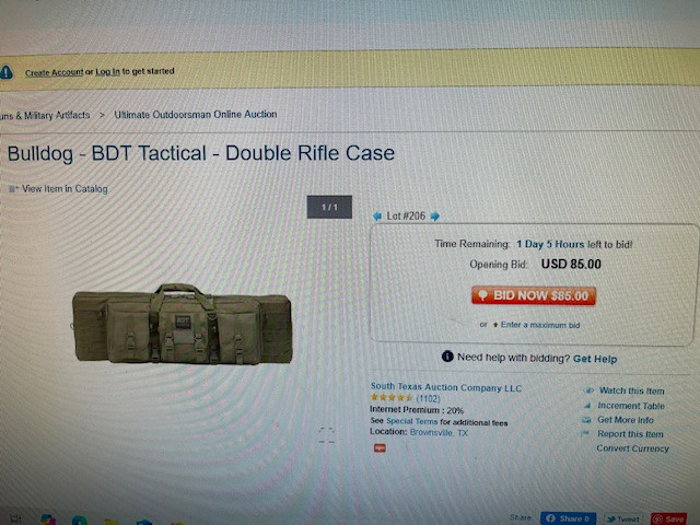

Zeb,
These work out really well in the field, and do everything you need it to do, as you described in you’re application.
https://www.proxibid.com/Guns-Military-Artifacts/Rifles/Bulldog-BDT-Tactical-Double-Rifle-Case/lotInformation/97988596

Zeb,
Here’s a picture of the page that I sent. I’m not sure why it won’t open for you.
These really work out well when we’re doing our fieldwork weather it target stuff or practicing up for a Western game trip/hunt. Leaving the better and nicer cases home out of the weather.

I have learned that when placing a 21 forearm on the barrels  when  the barrels off the gun it is important NOT to place the ejector ends on a flat surface as assembly requires the ejectors to be extended from the barrels.  Quite different from other guns.
