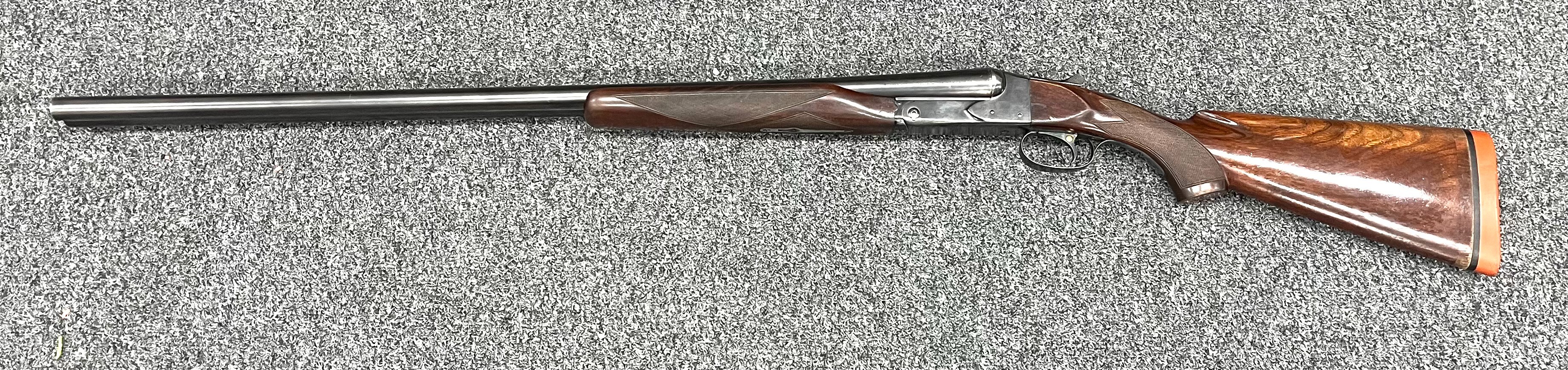

I just inherited a Winchester Model 21 “DUCK” in .12 Gauge with 32″ barrels. I am trying to figure out general information on it. I am waiting on a factory letter from the Cody Firearms Museum, and in the meantime thought I’d post it here! From what I see online, the Model 21 Duck may have come in a few different configurations? The butt stock seems to also have had an extra wood spacer inserted. The serial number is 29661. If anyone could throw some information my way about the potential value, model information, different grades, and the configuration of this Model 21, I’d really appreciate it.

The modified stock, while nicely executed, certainly hurts it for a discriminating collector. The CFM letter will list all the pertinent stock dimensions and other details. Beautiful wood!

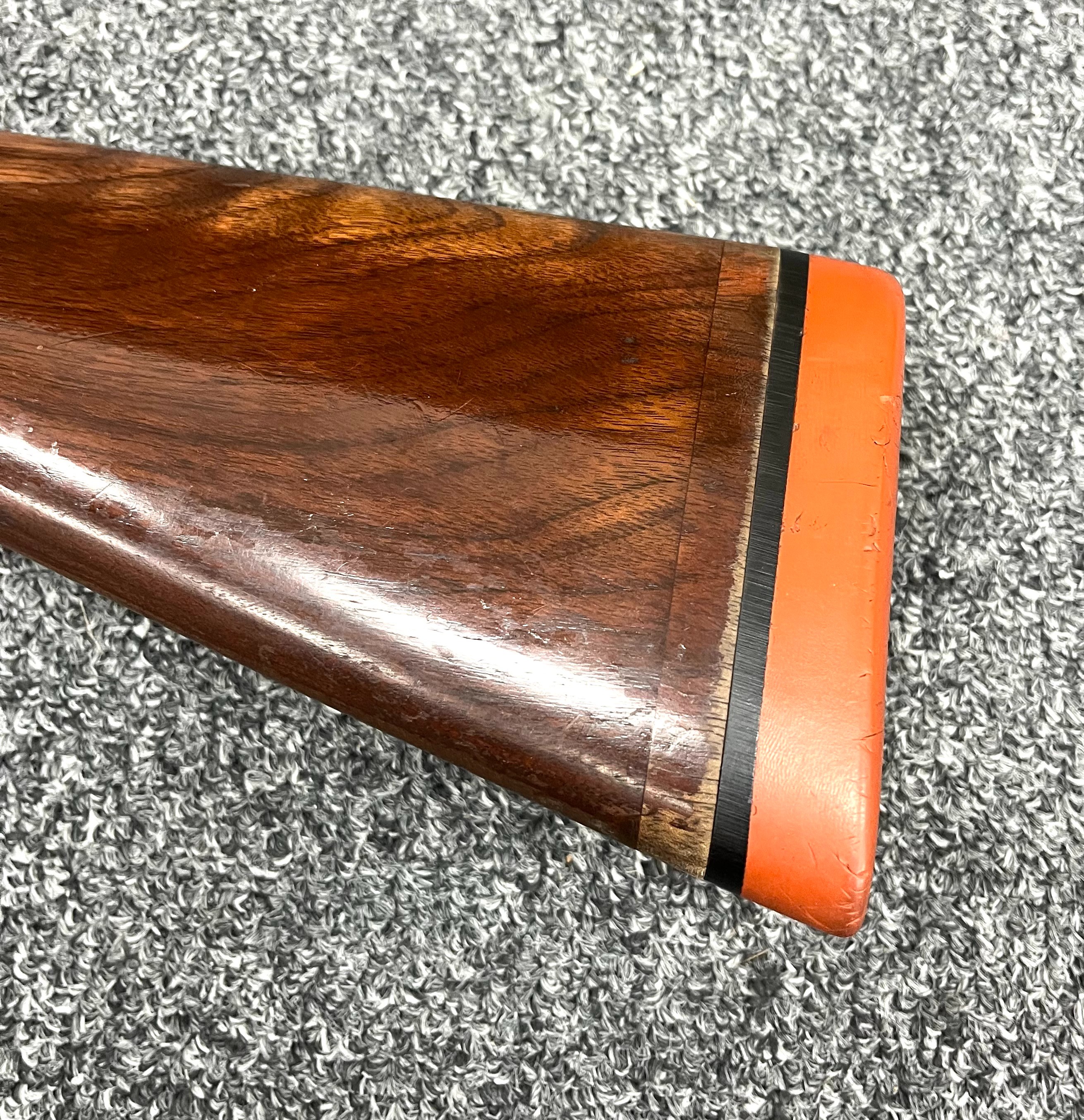

Red Cloud,  I’m curious what the present LOP is, given the wood shim plus the pad. Would you mind to put a cloth or other flexible tape on the center of the trigger and measure from there to the middle of the pad?  That would give us one piece of useful information — how far off catalog standard LOP is it now.
As Mike says, the Cody letter should say how it left New Haven, which could have been standard or short or long.
If the gun has gone through more than one owner/shooter,  there are more possibilities.
I have seen this configuration before, where a gun was cut down for a boy after first drilling index holes to accurately reposition the cutoff later.  From the matching grain lines,  the shim on this stock was obviously cut from this stock, then added back, likely as its owner grew up. That probably means the stock was shortened from catalogue length and then returned to it.

If I were its owner and did not care what a collector might think, my inclination would be to remove the pad, remove the shim, and substitute a black spacer of a length equivalent to the shim plus the existing thin black spacer, then reinstall the pad. I think it makes a smoother look and have seen several Best Quality English sidelocks altered in that way. However, that’s my own aesthetic taste at work and the notion might make another Model 21 fancier or a  conventional collector faint.

Zeb, In my eyes, the grain of the patch is close but not exact.  I would hazard that a good woodsmith found a donor piece of wood.  Look to the area just below the heel and there is a band of blondish wood with few dark grain streaks opposite a dark area with dark streaks.  There are others like that.  There are indeed several spots where the grain agrees, tho.  Had it been cut and the cut piece returned, I would expect a closer match (as in perfect).  I know at least one woodsmith who could do this level of matching.  He salvages and catalogs old stocks and cut offs for just such use.  A heavy duck gun was made to be used and that tends to endear this gun to me more than a pristine one would.  But I know zilch about model 21’s.  Tim

Tim,  you have the better eye. I was looking at the image on my phone and failed to see where the grain lines don’t match up and the splashes of color don’t cross the vertical cut line. On my big tablet, I see what you saw.
It was a credible job but the gun deserves better. I’ve already said what I’d do. If I had unlimited funds I’d see what Connecticut Shotgun Co. could do with it.  Last I heard, they have the old Custom Shop machinery and tools and a license from Winchester to build new Model 21 shotguns to order.  If money were no object CSC could restock the gun to Red Cloud’s personal requirements,  refinish metal and wood, and install choke tubes.

One downfall (if you want to call it that) is that the standard Duck spec. had a shorted length of pull to accommodate the heavier clothing usually worn while hunting waterfowl.   I believe 13 5/8″ was standard.  That’s too short for many modern shooters.  I have seen several examples with added wood or synthetic spacers.  If you plan on shooting it, I would start with sending it to CSMC for a service.  They will clean and oil it and let you know if anything is out of spec.  They can replace the locking lug and hinge pin if needed.  The service is fairly reasonable, but parts replacement gets pricey.  It’s just part of keeping a nice shotgun going.  Putting a value on these is hard and as you stated, they vary quite a bit.  The 32″ barrels are not as common as the 30″ barrels, so it has that going for it.  It would be hard for me to modify the chokes on this one if you are wanting to shoot ducks or geese with it.  If that is the case, I would leave it alone and buy some bismuth shells.  They can kill ducks farther than most shooters are capable.

That is what I would do with it, and remove the wood spacer. Depending on the resulting length of pull,  if it needed a spacer I’d ask for a flat (un-shiney) black synthetic spacer. If they’re good enough for Purdey and Holland, they’re good enough for me.)
