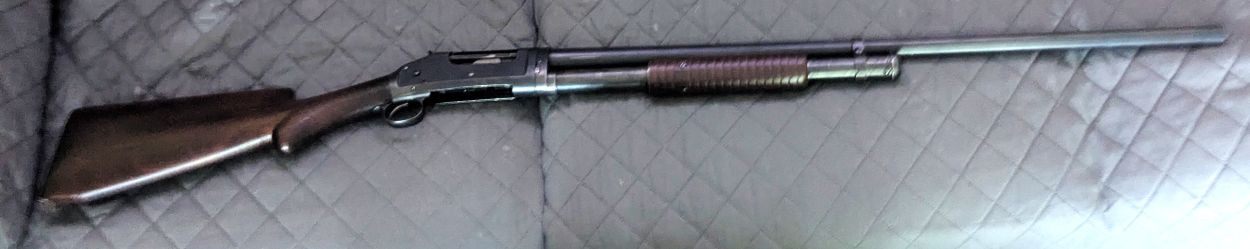

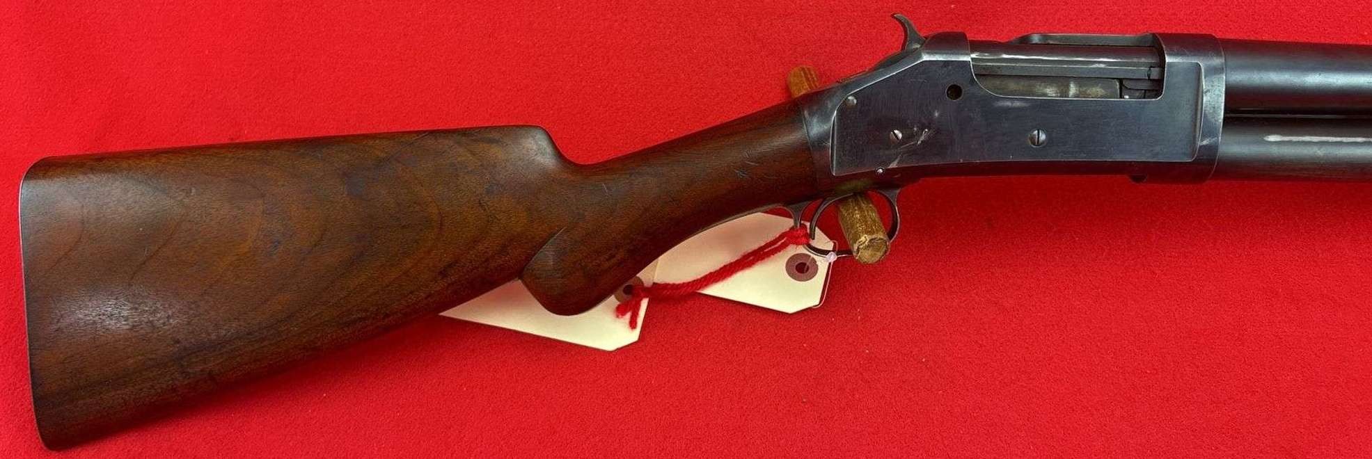

I bought a fairly old (1899) (S/N C 82444) Winchester 1897. It was painfully obvious from the first pic that the previous owner had no clue. That ugly slide handle was screwed on, with non-appropriate screws, and glued to the the slide bar. When I got it off, the screw holes were all fouled up. I got them welded shut, drilled, and re-tapped the holes.
To say it was an education would be an understatement. The new handle is a reproduction, but at least it’s period correct. I’ll keep looking for an original, but I don’t want to have to make a car payment to get it.
The second pic is the new handle installed. I still have to take it for a test drive before I try to antique the finish and locktite the screws.

Nice job! looks much better

Huge improvement. But not period correct at all. The corncob style is period correct, the longer pump handle came much later to the M12.
I do not know if a corncob style reproduction is available, I am thinking no.

That’s interesting about the handle.
I was not aware that there was a different length for the early 1897s. Can you tell me what I should be looking for to make it at least look period correct?

Corey,
There is no length difference in the early Model 1897 slide handle stocks.  The first difference is the transition from the 3-screw style (Pre-C and C-series) to the D-series slide handles (with no screws), but the length stated the same.  In total, just three variations of slide handle stocks were used for the Model 1897 (97).  Refer to my recent article in the Spring 2026 Collector magazine – 2026 Spring (winchestercollector.org)

Was the longer “big” slide handle as pictured on the OP’s gun ever original? I’ve not seen that larger one before on an 1897. My own trap grade model 12 wears a fore end like that. However the M12 field stock was a round corncob style similar to the 1897.
I’ve seen a couple guns like that on GB too. For using the darn thing I like the bigger one more.
I think they also call that a beavertail? Something like that anyway.

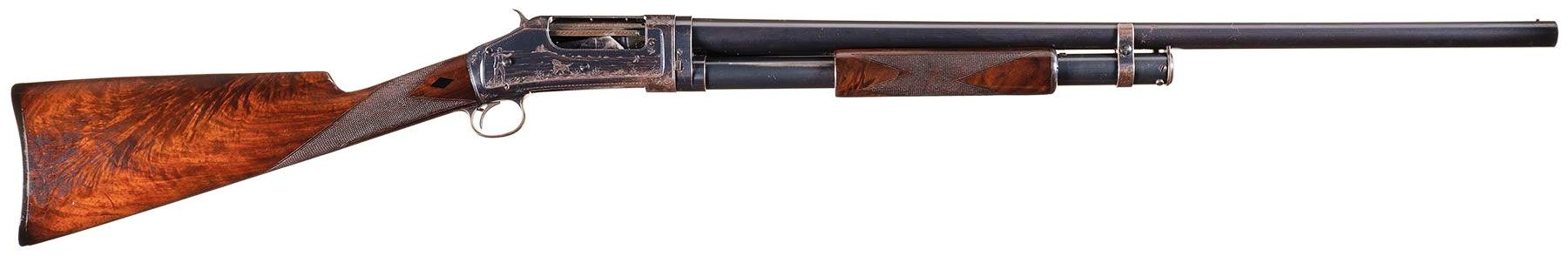

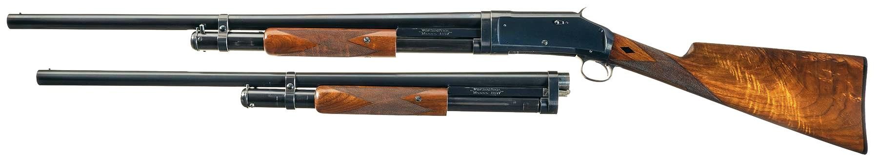

In answer to your question, No it was not ever a factory option on the Model 1897.  Ther “corn cob” style slide handle stock was standard on all Model 1897 variations except the Trap, Tournament, and Pigeon grade guns, and it remained standard until 1946 when it was replaced by the slightly larger grooved “flat bottom” slide handle stock.
The higher grade Trap Gun, Tournament Gun, and Pigeon Gun were made with a smaller non-grooved slide handle.
Black Diamond Trap – s/n 216372 (2-barrel set)
Pigeon Gun s/n 403002

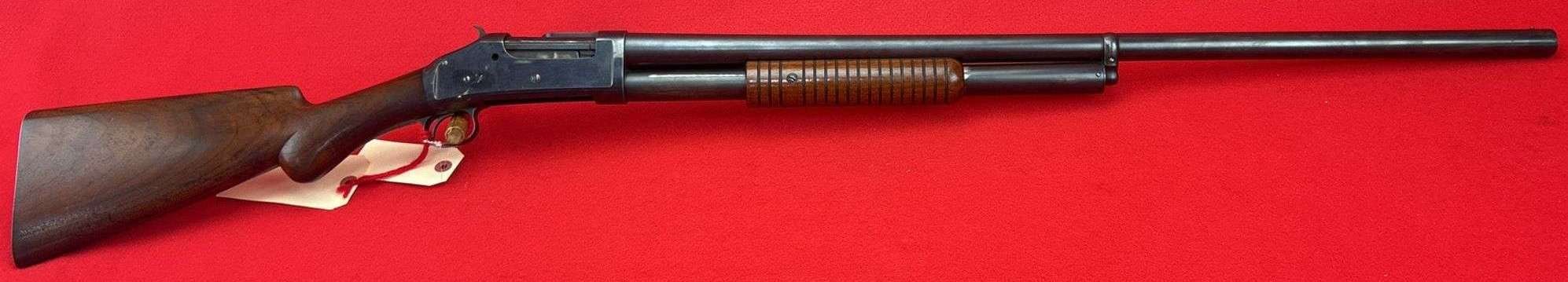

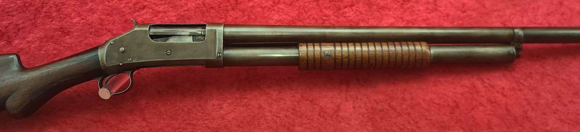

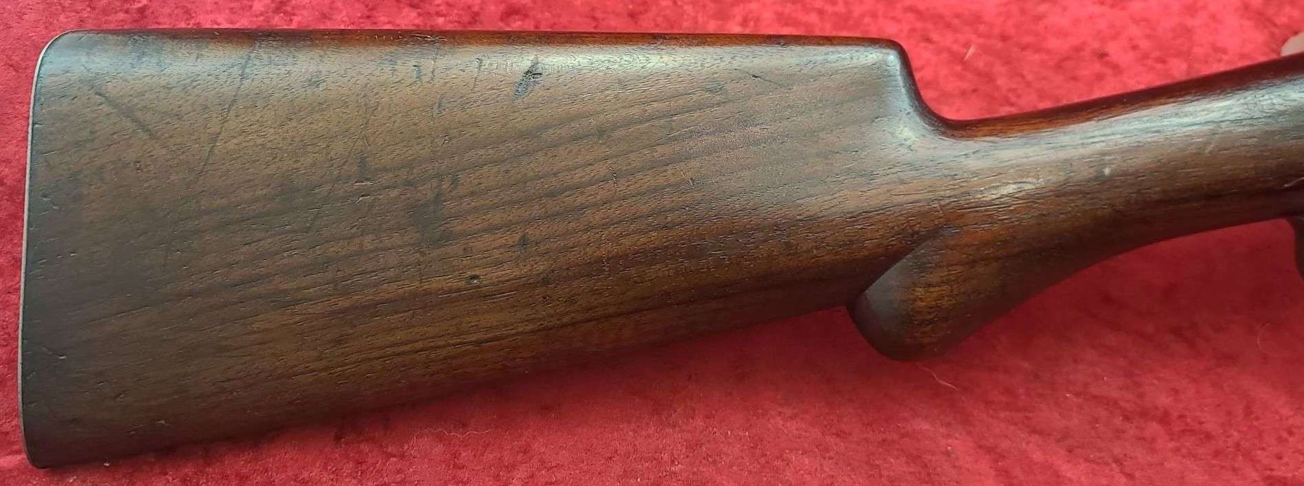

I have not read or heard it called that.  It is simply the “round knob” pistol grip.  It was first used by Winchester on the Model 1887 shotgun (JMB’s first), followed by the Model 1893 and then 1897, then on the early Auto-5 shotguns.
This is one of my Model 1893 shotguns (s/n 28149)
This is one of my Model 1897 shotguns (s/n/ 36850)
