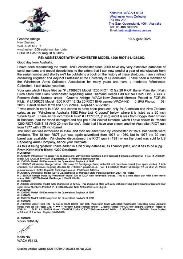

If I have an email address I present the information as a letter setting out why I consider the year of manufacture and this takes time.  See the attached letter “JerryWebster-Springfield-Nebraska-Model 1200 # 280683”  In review I see there is an obvious mistake – I typed 1997 manufacture instead of 1967, but this is obvious from the text and attachnent.
I look forward to hearing from you both in due course.

If I have an email address I present the information as a letter setting out why I consider the year of manufacture and this takes time.  See the attached letter “JerryWebster-Springfield-Nebraska-Model 1200 # 280683”, which has the error corrected.
I could not upload the letter as it was in pdf.  It is now two pages as a JPG.
JerryWebster-Springfield-Nebraska-Model-1200-280683-P1.jpgJerryWebster-Springfield-Nebraska-Model-1200-280683-P2.jpg
and is uploaded

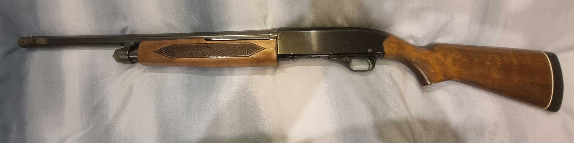

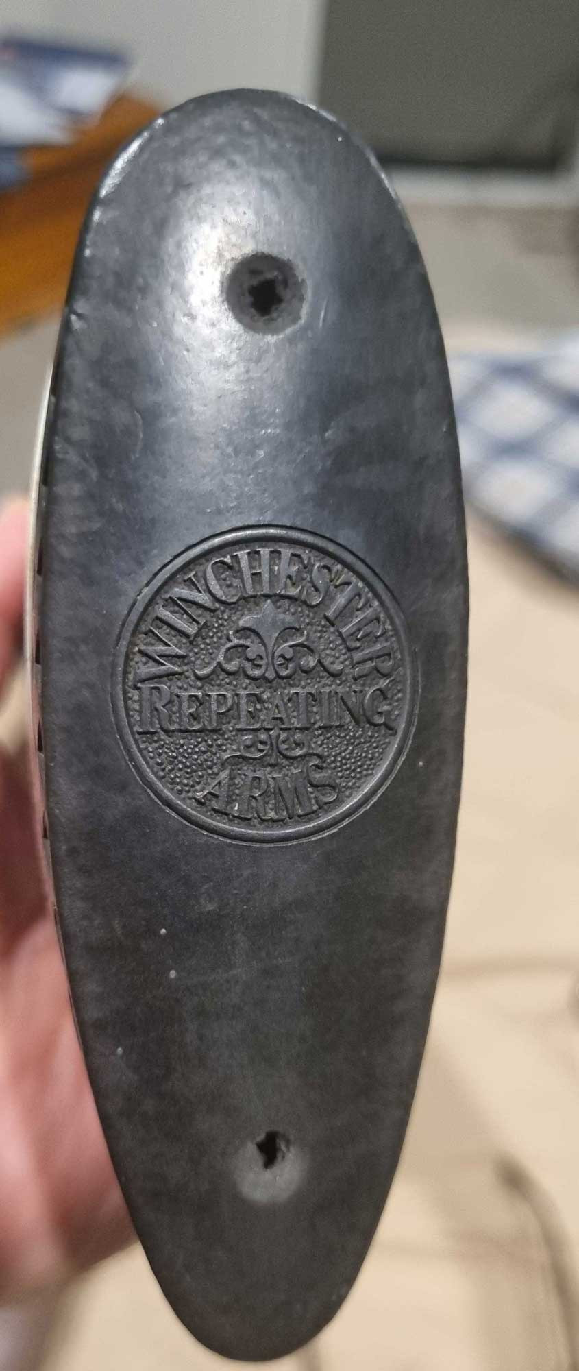

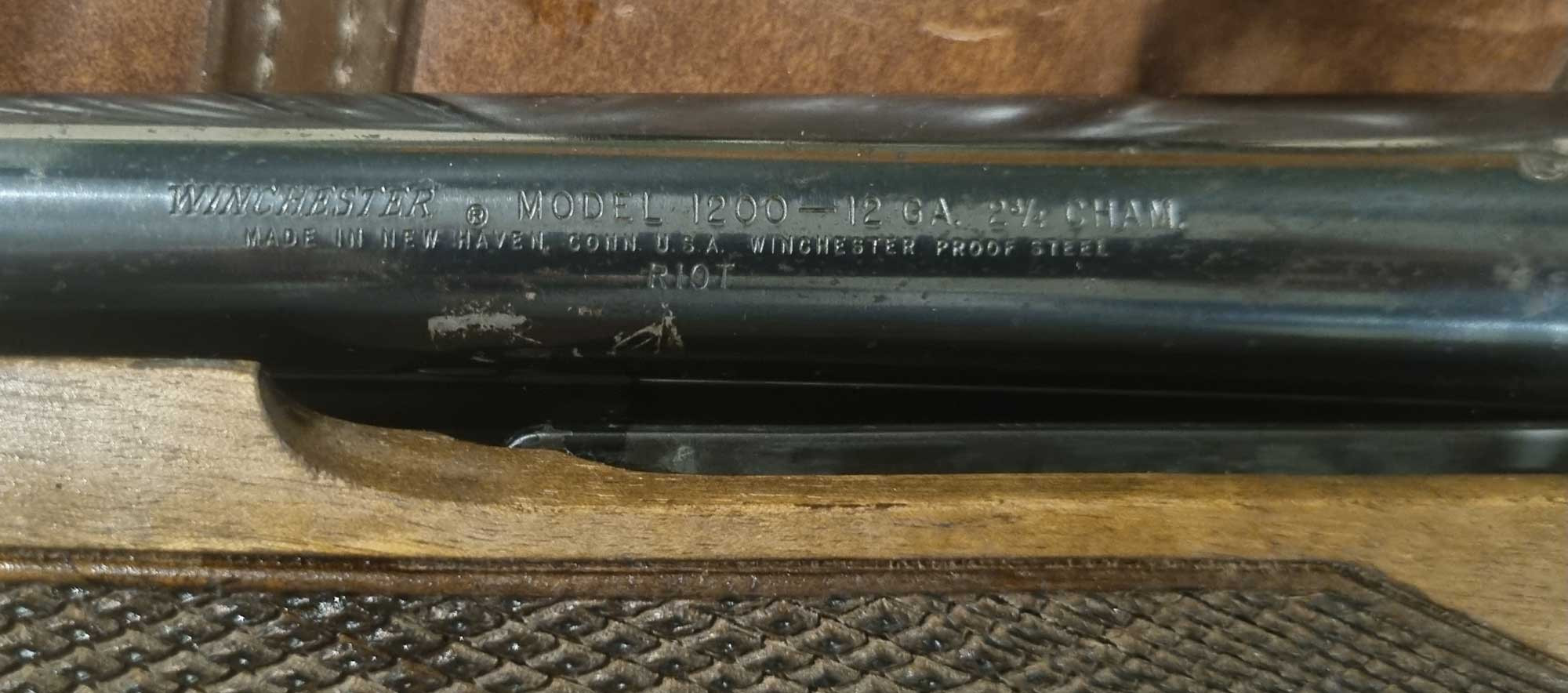

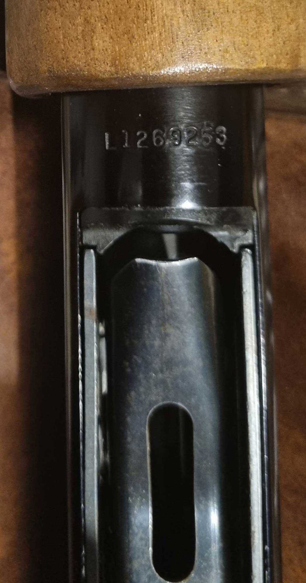

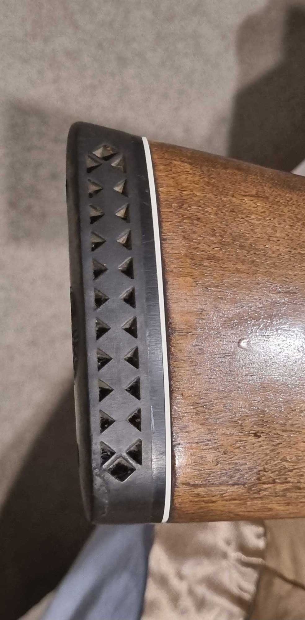

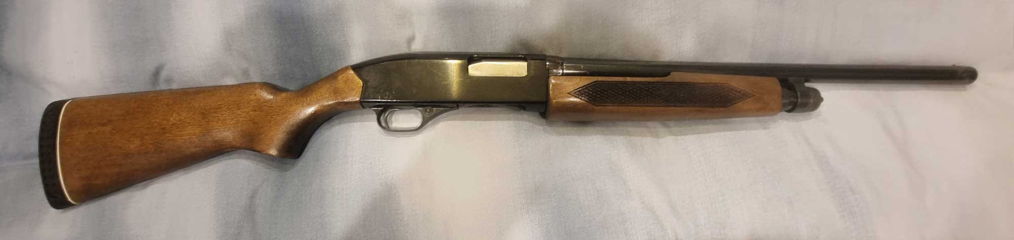

Serial.jpgButt-pad-1.jpgBarrel-1.jpgButt-1.jpgLeft-1.jpgRight-1.jpgHi
I just bought this rather rough 1200 Riot, serial number L1369253.
I haven’t seen one in NZ before. I’m keen to find out its DOB.  Photos to come when I can work out how to attach and send.
Cheers, Graeme

Hi Graemia, Yes I can help you with that.  As it happens Winchester used up old stock to supply 20 inch barrels instead of 18 inch barrels but only in Australia and New Zealand. So I need the barrel length and the barrel address when you send photos.  You can Private Message me if you wish or direct email to [email protected] or post the photos back here.  See my post No 28
I live in Brisbane, and presently in Townsville so will not be on line for another 12 hours
Keith

Hi Keith
Yes, the barrel is indeed 20″ long.  The barrel address in the photos is New Haven Conn USA and the serial number is L1269253 as shown in the photo.  I read it wrong earlier.
Cheers
Graeme

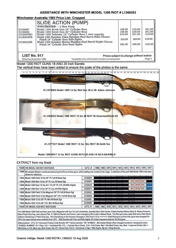

August 10, 2026 - 4:25 am
Good Day Graeme
I have attached an abbreviated reply to your post 29, and my reply to you as Post 30.  If you want more go to Post 30 and advise.
Sincerely
KeithGraeme-Arlidge-Model-1200-RIOT-L1369253-10-Aug-20-conv-0.jpegGraeme-Arlidge-Model-1200-RIOT-L1369253-10-Aug-20-conv-1.jpeg
