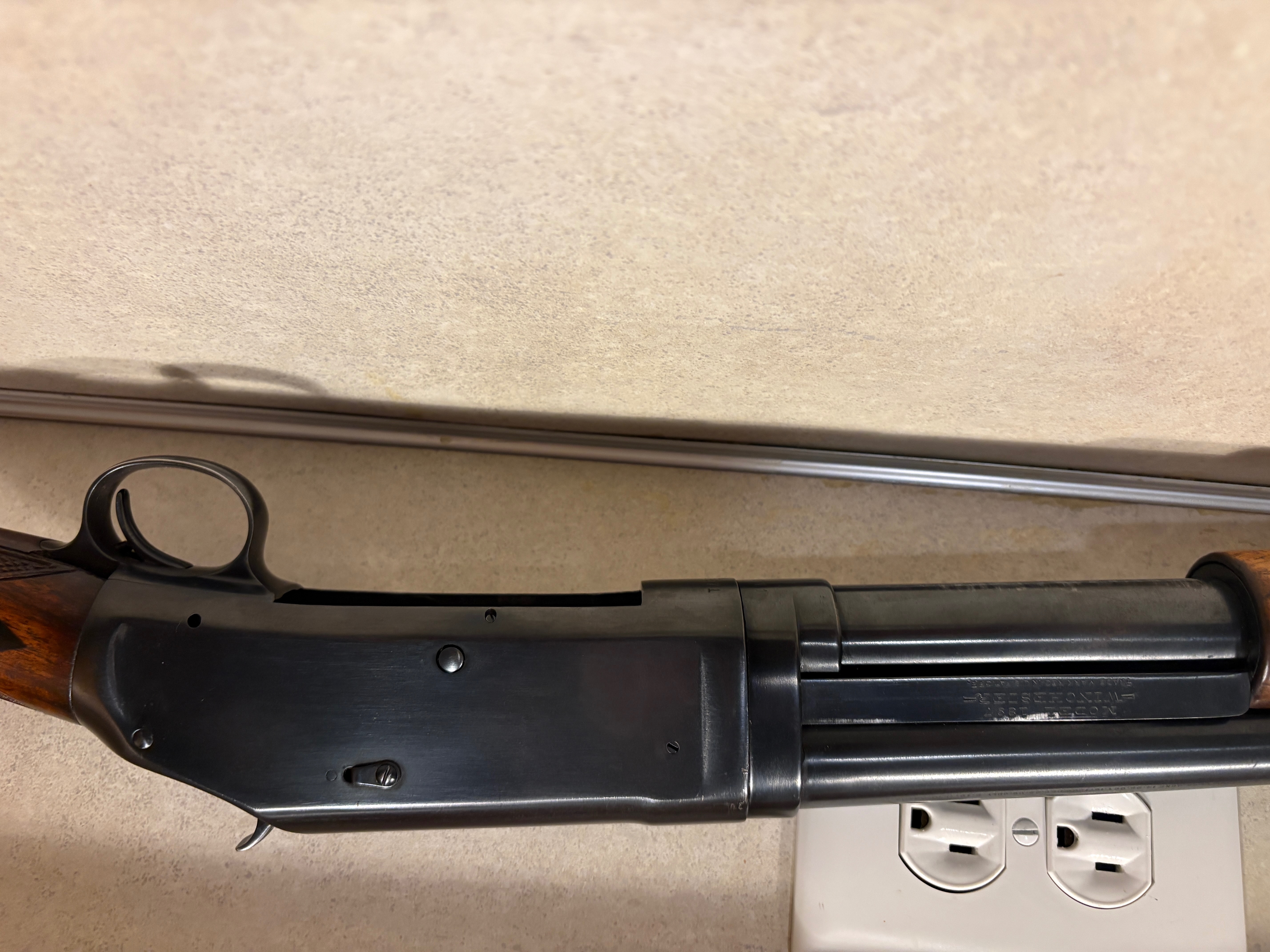

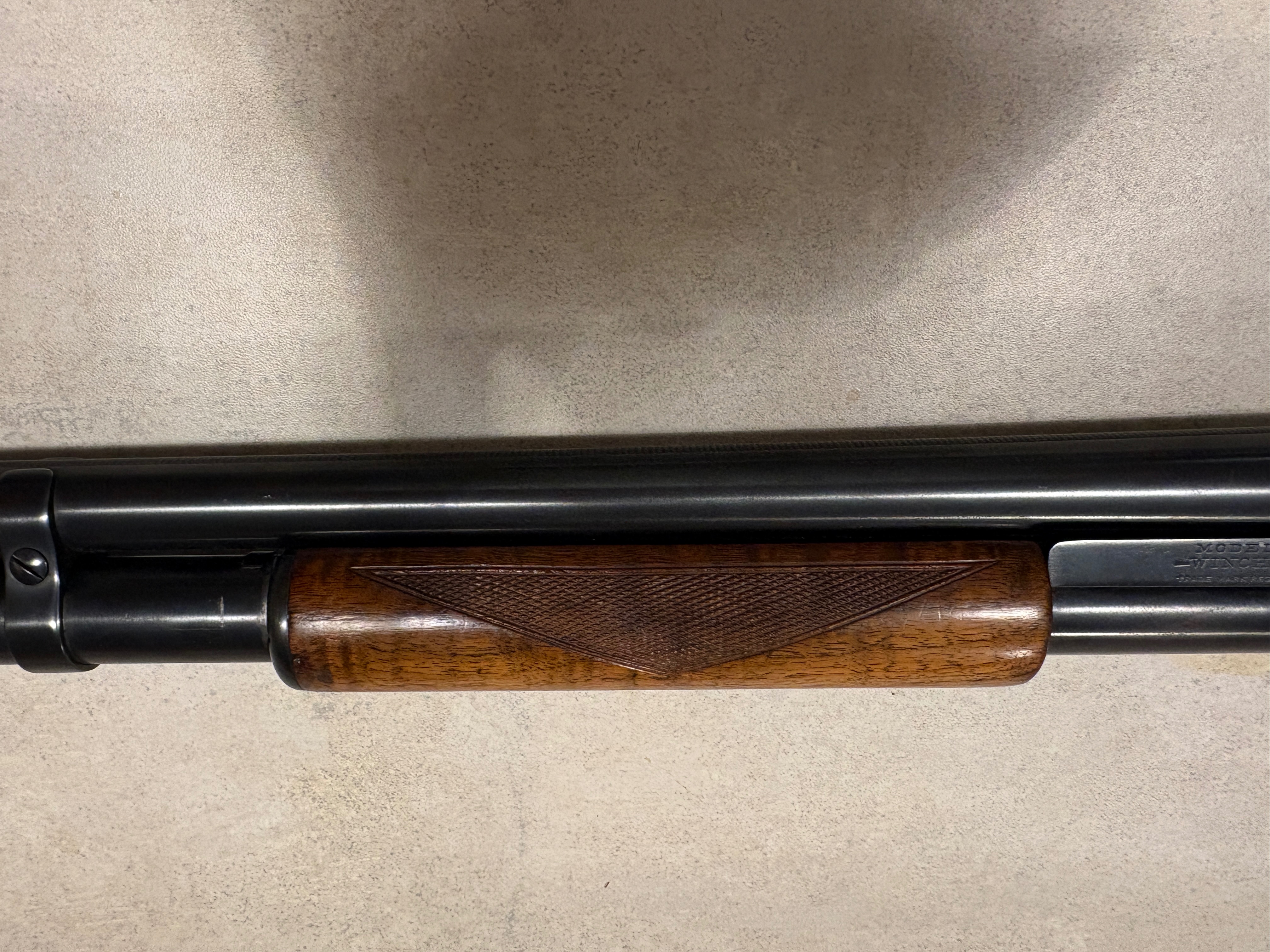

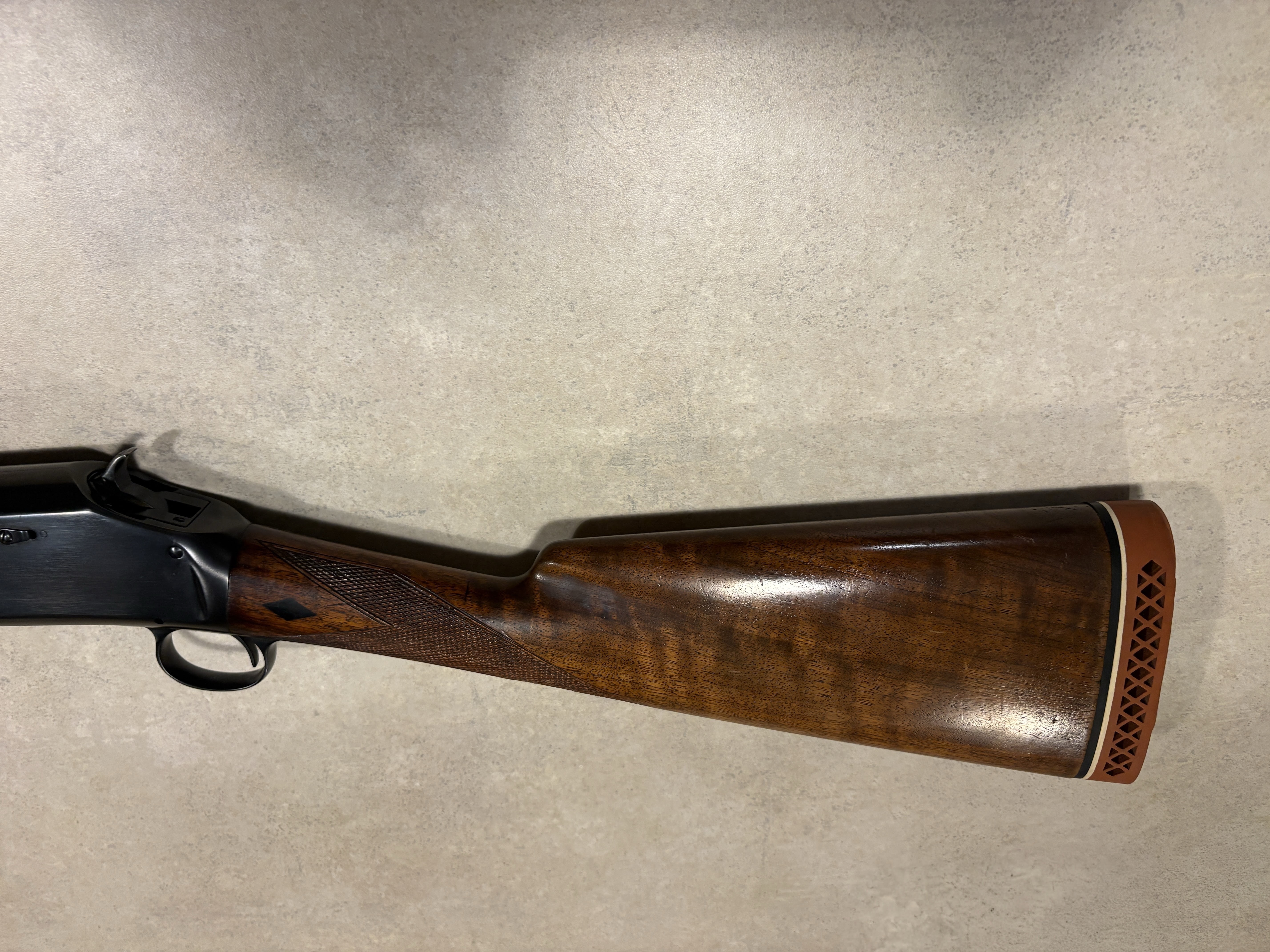

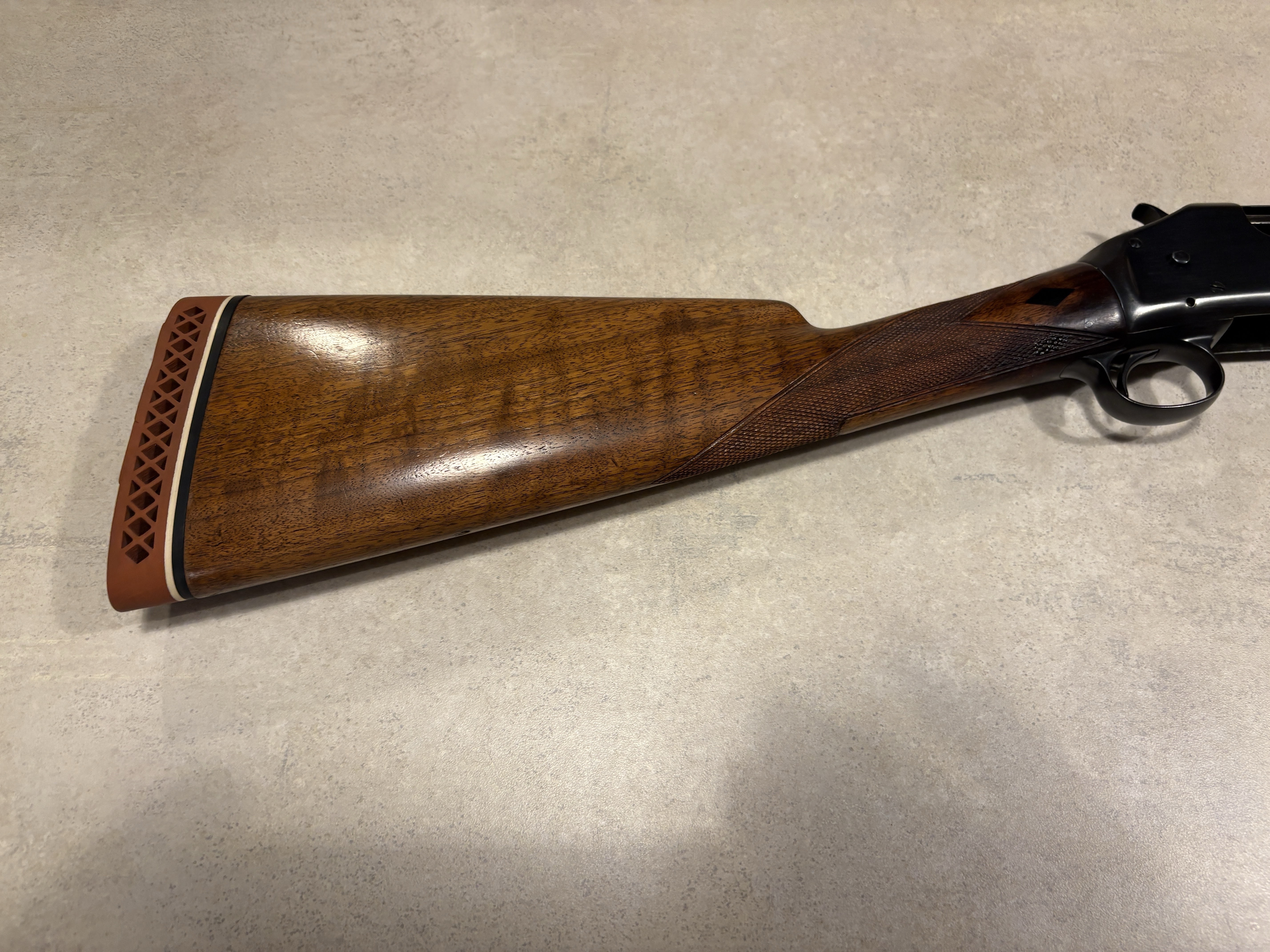

I know it is Black diamond and in great shape. In our family for close to 80 years. Mfg in 1911. No rust or scratches in metal and serial numbers match on both pieces. Trying to figure out best way to get it worth and providence

Thank you this helps. It is 30” full choke and seems to have all the right numbers. I am not sure about the refinishing. It was originally my great grandfathers gun and really had very little use. Between my dad and I we have done nothing to it for last 50 plus years. Just sat in nice gun cabinets. Action is all very tight which is good. I hope to find and expert who can determine if bluing has been redone. It kind of make sense it was as it is 114 year old.

The shotgun looks brand new if not refinished at some time.  You need someone to take a better look at it for you.  Hopefully one of the experts will respond.

I love the 1897 black diamond shotguns; I suspect that it has been refinished. The ventilated recoil pad is a strong indicator of this.

I didn’t see a picture of the barrel address.  The action bar stamps don’t look like they have been polished.  The receiver polish looks good to me, but I have no clue.  Just my observations

Positively a refinished gun.  Both the wood & steel have been refinished, and the recoil pad is an aftermarket alteration.  If the stock was cut (shortened) to install the recoil pad, that further degrades to gun.
What is the serial number?  With it, I can determine the precise date of manufacture (day, month, & year).  Does it have a matted barrel and receiver top?

Thanks for that Bert. I could not get the link to work. From the pics it does look like a high quality refinishing job. I know enough to be dangerous. The gun in question looks hot blued to my eye. Were not the early 1897’s rust blued?

Yes, the pre-1939 Model 1897s were manufactured with a “rust” blued barrel and magazine tube.  The receiver frames were “machine” blued.

Good deal, I may get one of those round tuits for WACA. The pad and the very slight wear where the slide runs on the mag tube were both major clues. Even in pictures original has a softer look and honest wear is impossible to fake. Old and original guns are not shiny. Light reflects more softly.
