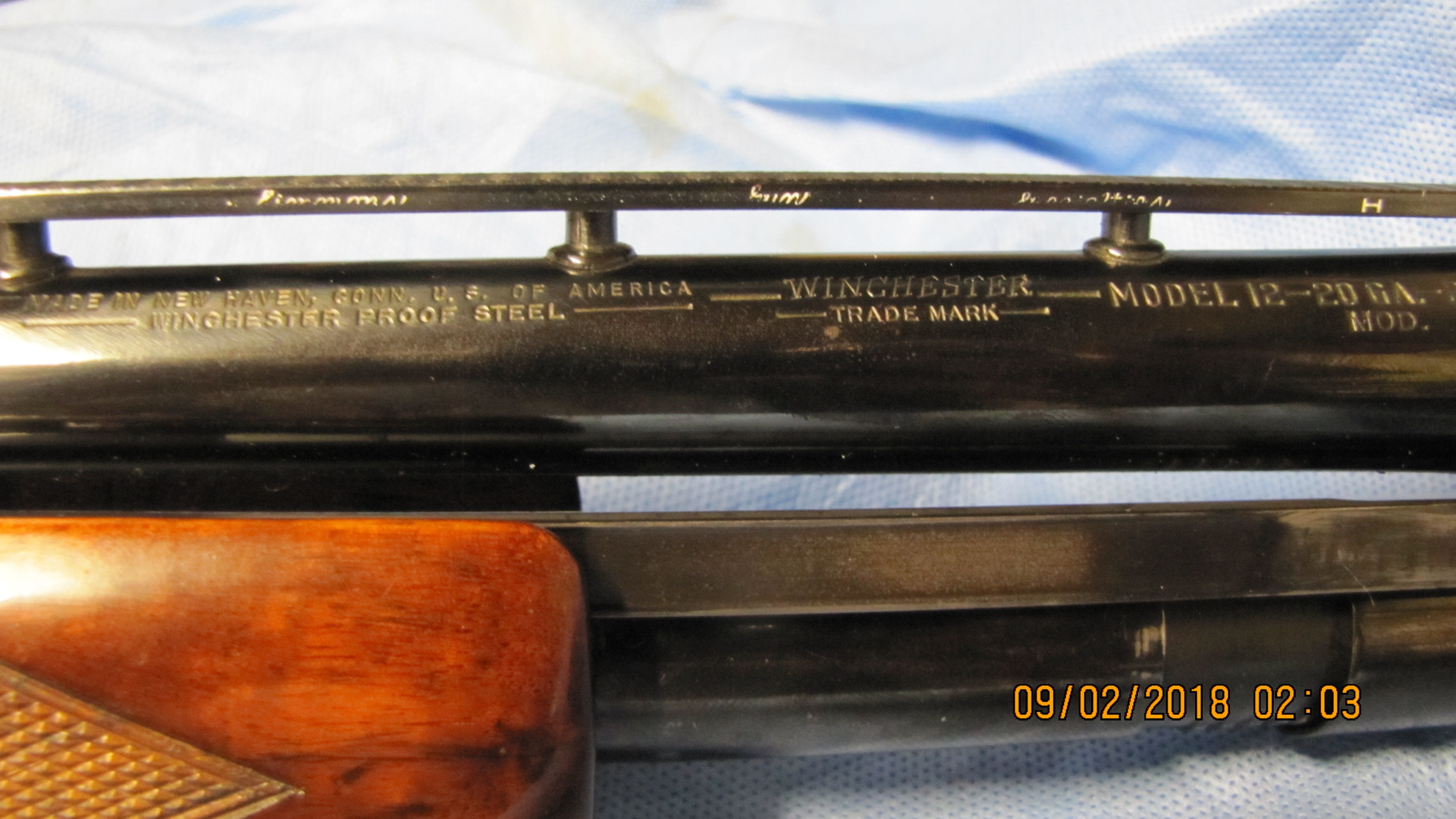

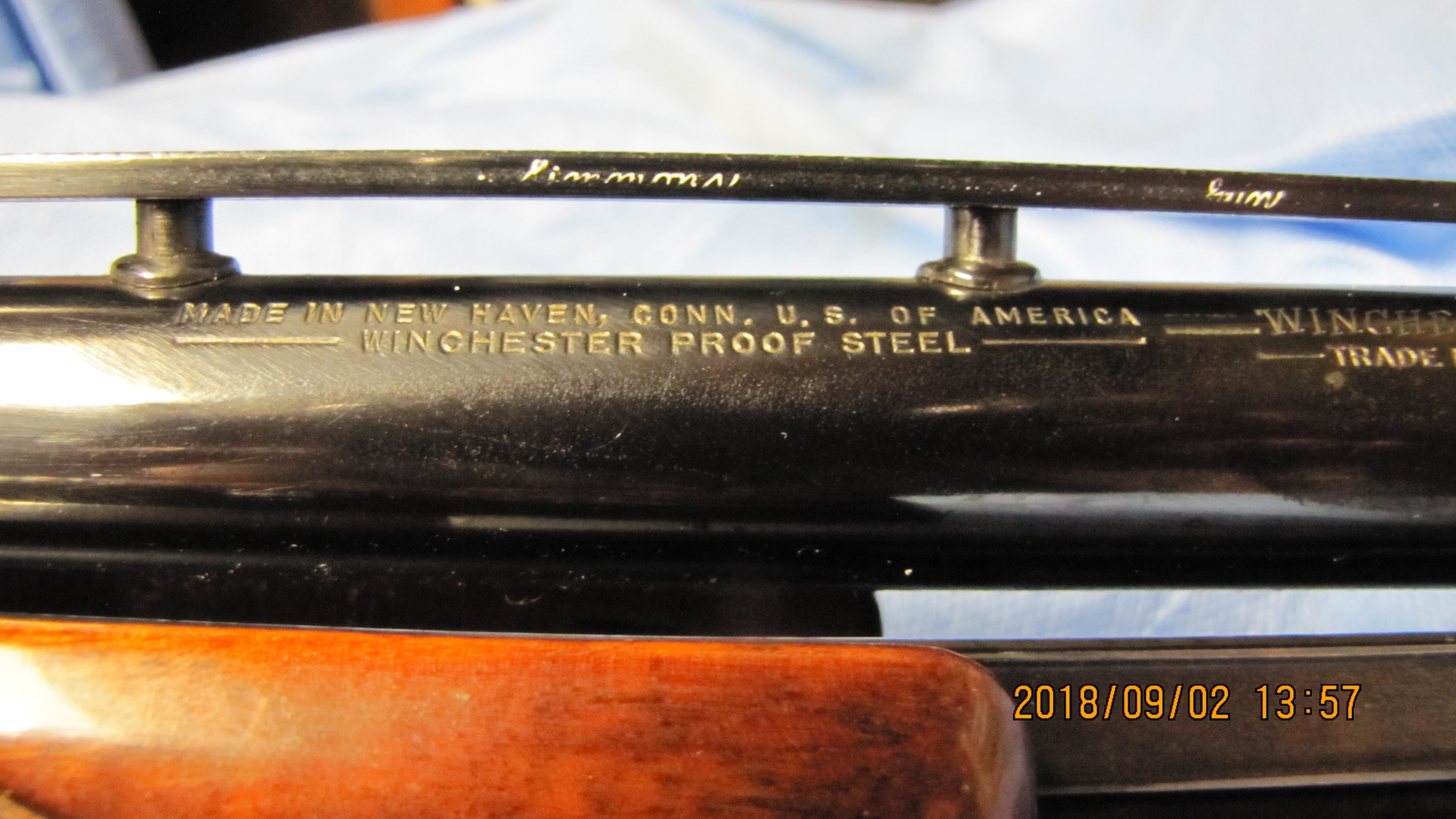

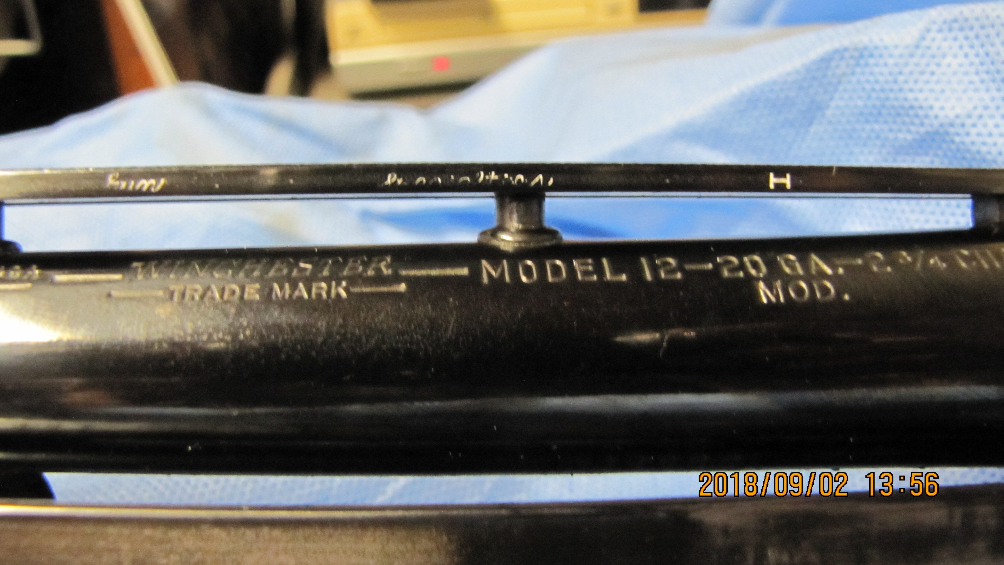

Thanks guys for your input.  I just checked the inside of the barrel and it does have a plugged front sight hole.  So, I now have a really nice shooter and can use the little ’20’ for what it was originally intended…..shooting!  Another problem has come to my attention.  The “action slide handle” wood has shrunk somewhat and the “action slide sleeve cap” is not tight.  It tightens about 15 degrees past center.  Any ideas of  the best way to correct this problem?  I don’t want to chance cracking or breaking the wood. Would it be possible to add some kind of wood oil to get it to swell up and tighten up the looseness? Thanks to all for my continued education in “Original Winchester Knowledge”.
I chalked the lettering on the rib and got these pictures.  The lettering looks the same when under a 10 X magnifying lens, unreadable.  I measured the posts and bases and they are the same dimensions as the measurements on my correct model 12.  Any guesses?RDB

Appears to say “Simmons Gun Specialties” although somewhat spaced out a bit.

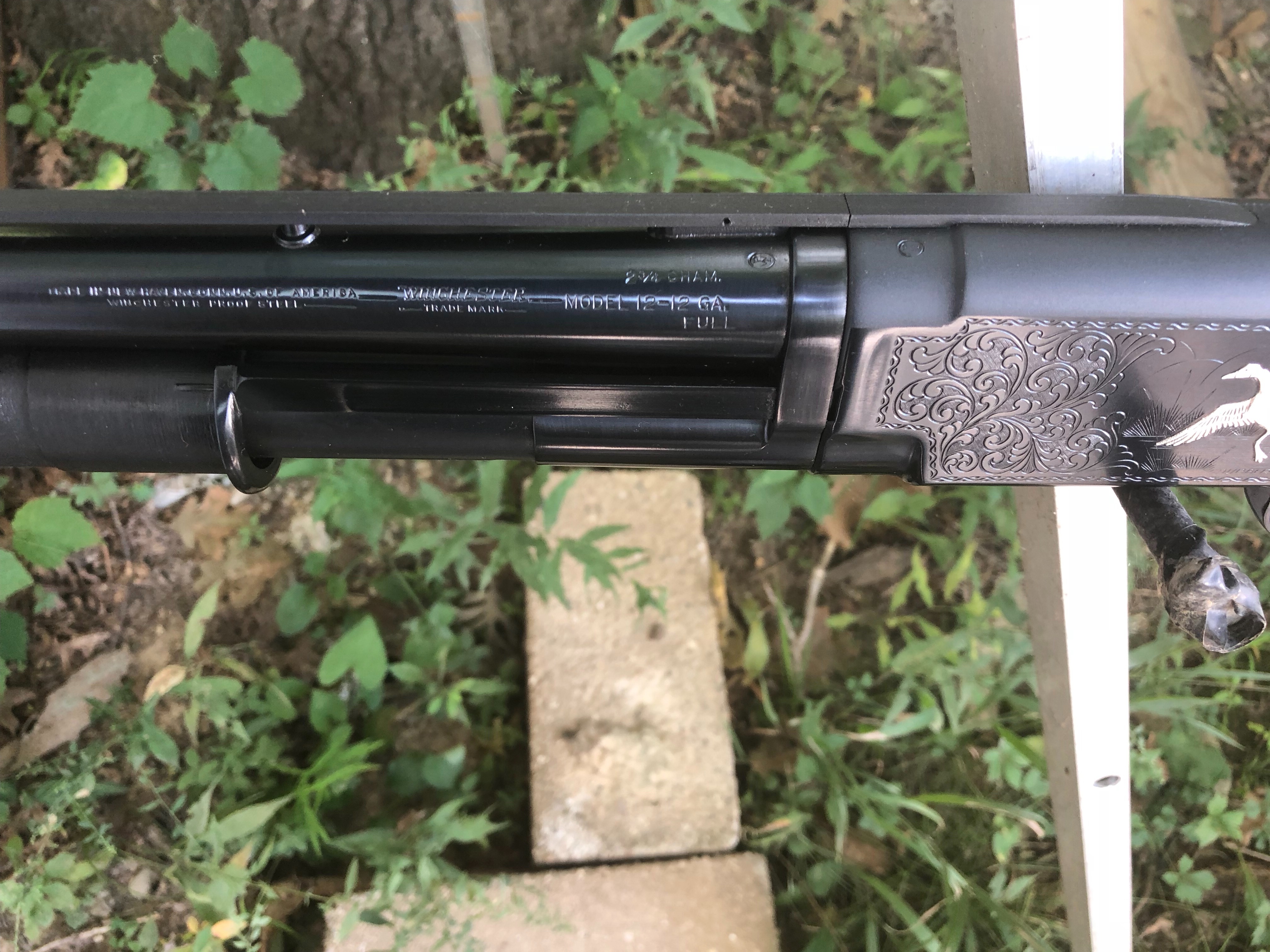

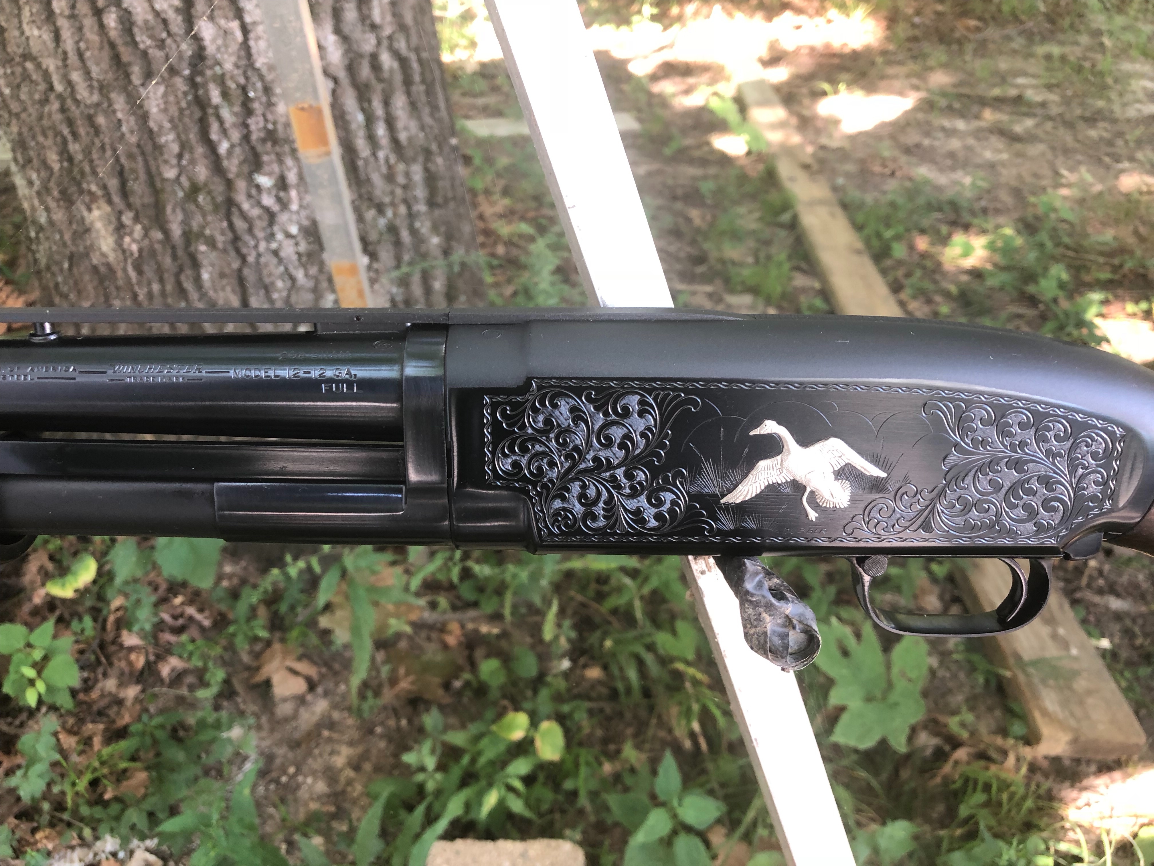

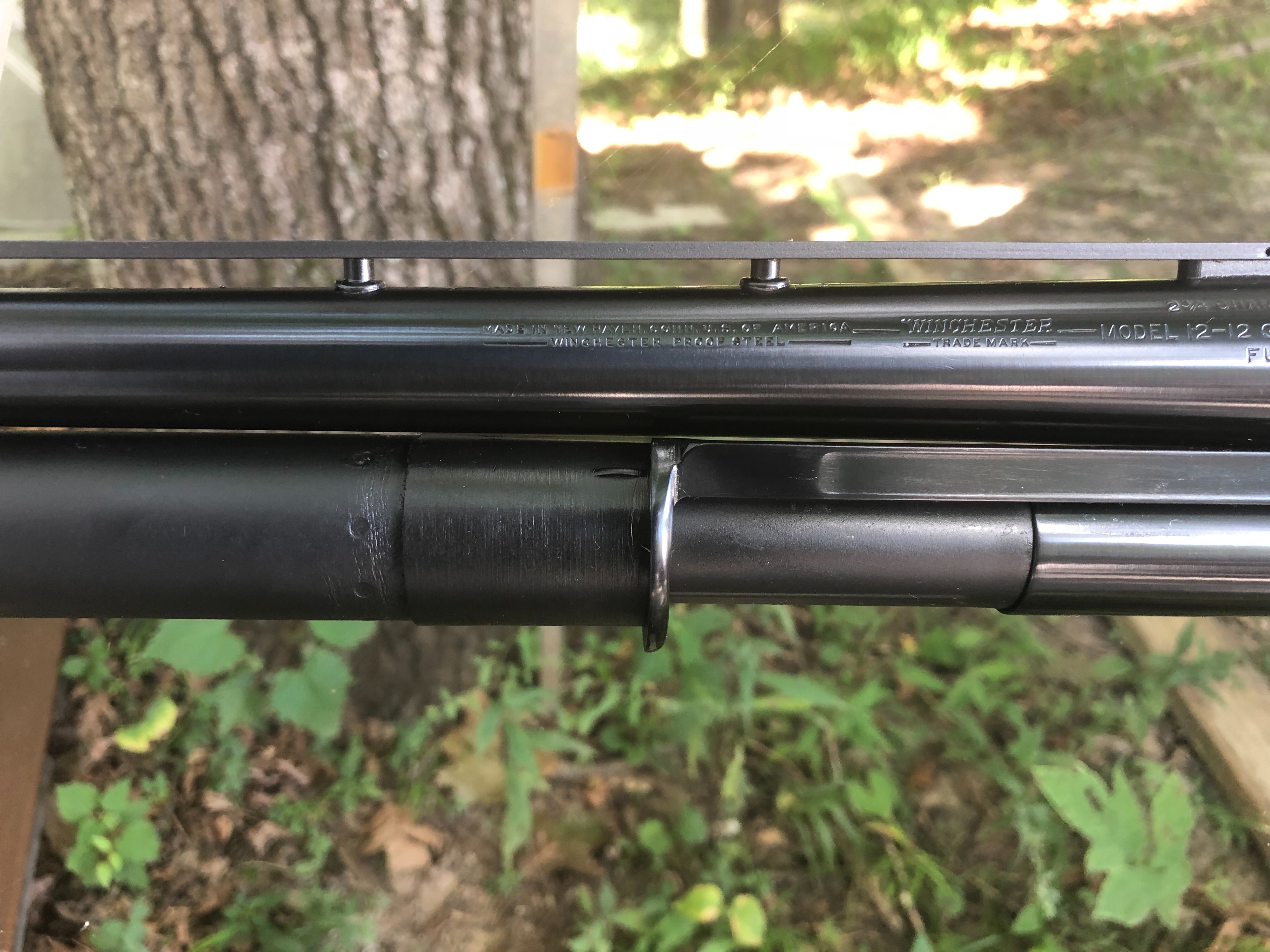

D9B2A6F3-827A-41EA-A015-06C0695CD13E.jpeg4DF1FF33-E2ED-4550-9816-A4E7CF520A2D.jpeg95A91500-4831-45CB-A39B-9DEDC628464D.jpegC4E1573A-383D-417A-A756-2AEDBAECC351.jpegHere are pics of a field grade model 12 I just got back from Simmons. Notice the proof marks and the rib has no marking on it.  I have had many model 42‘s and model 12 done by Simmons through the years but always had their name stamped on the rib. This is the first time one came back with no markings.
Your 20 gauge has a late model Simmons rib, the early ones were stamped in block letters.

Are the lines on the top of the rib striated lines running north and south or the squiggly lines running north and south and east and west?
You said the your model 12 was a field grade – was the engraving done at Simmons or someother place?  I do not see a signature. I really like the engraving (NICE JOB)  RR

The rib has straight lines. I wanted wavy lines but they didn’t have any in stock.  The gun was engraved by Mike Dubber, a friend of mine back in 1977 when he was first honing his skills. The gun set in my closet for 40 years in the white and finally decided to have the gun blued and rib installed.
Mike still engraves and his work today is  of the highest quality.  I believe he was engraver of the year a few years ago. If you have last year’s bluebook on gun values he’s on the back cover with a gun that he engraved.
