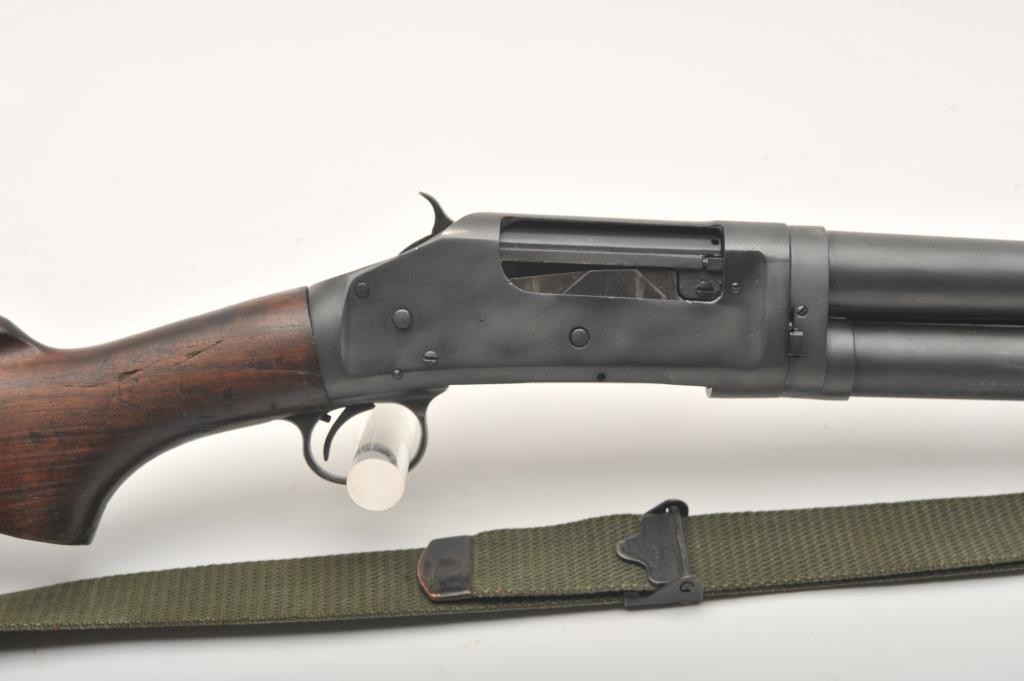

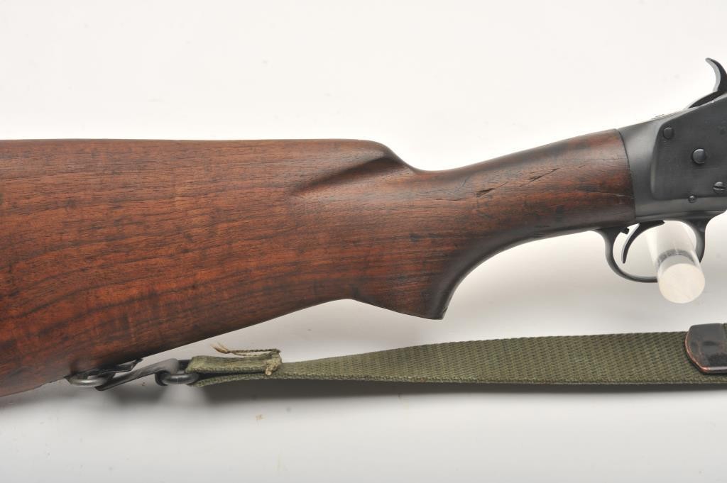

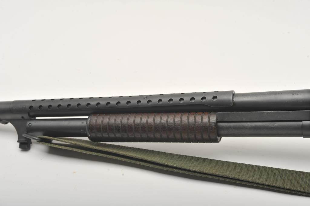

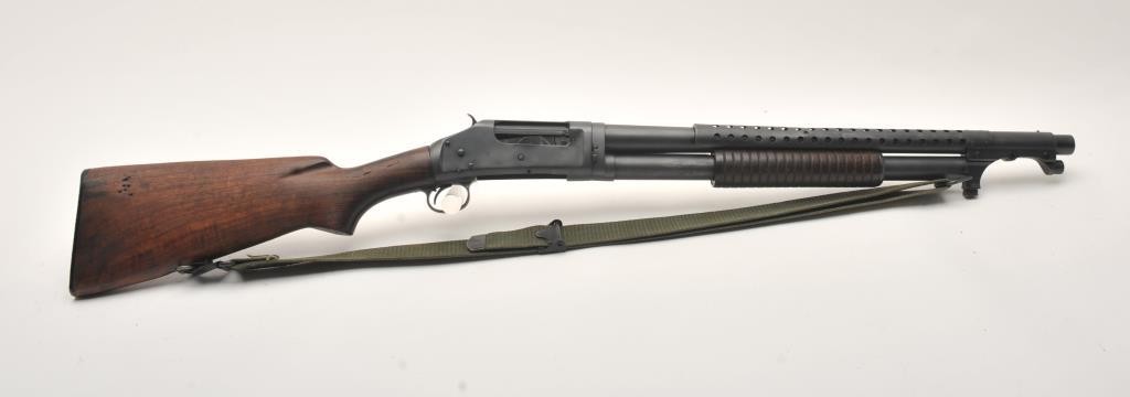

Was watching this one and am curious about opinions here. Sorta has that “too good to be true” look to it.
Winchester Model 97 U.S. riot shotgun, 12 gauge, 21” barrel with ventilated metal barrel handguard and bayonet lug, military finish, flaming bomb proofs on barrel and receiver, U.S. marking on left side of receiver, wood stocks, green woven sling, S/N E 921625; good to very good condition with a very good bore, crisp action good markings; good wood with crossed cannons and “W.B.” cartouches on left side of butt stock plus rare U.S.M.C. in small stamped letters on bottom of semi-pistol grip (C&R).

I kind of doubt the originality of the USMC markings.
Should have a unmarked handguard with 6 rows of holes.
Sling is not period correct. As Bert says, we need pictures. This appears to be an early gun and most desirable if correct.

Oops, sorry. I thought I attached the pics but it didn’t take (we call that a “PEBKAC Error” – Problem Exists Between Keyboard And Chair).
These are all I have from the seller. I haven’t seen the gun in person.

What does the seller mean by “military finish”?   It should have a commercial blue finish.  I can’t tell if it’s a faded blue finish or a parerized finish.  And the buttstock fits poorly to the receiver.  I would pass on that one.
March 3, 2019 - 1:21 am
It has been redone, and I think it has a 4 row handguard which is incorrect. Very limited in value, a real nice one may run you $8,000 +. If you are thinking about buying this shotgun, take my and the other posters advice, PASS!!!    Big Larry

Thanks. I didn’t bid. It went for $2400.
