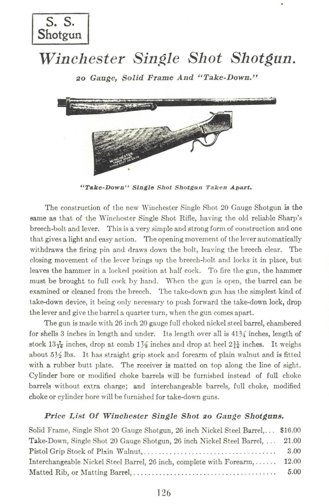

21 bucks for the takedown gun
12 bucks for another barrel
I would assume take down was a requirement for Addl. barrels. Given a solid frame gun was only 16, 4 dollars more bought an entire gun.
Now we know why 2 and 3 barrel sets are not often seen.

I understand you’re point, but in today’s money, $16.00=$579.72,  and $21.00=$708.38, in today’s dollars!
Just saying! It doesn’t sound like much today, until we look at the comparison! IMO!

I was looking at the percentage of difference. For another 4 bucks I would get an entire gun. We do not see many guns today with an extra barrel. I would think that there are also cases of an Addl barrel being separated from it’s receiver.

Of the (108) Single Shot 20-ga Shotguns that I have found and documented thus far, (64) of them are Take Downs, and none of them have a second interchangeable barrel.  With the only option being a different choke, there was very little reason to order a second barrel.  Of the (108) found thus far, (90) are FULL choke, (10) are MOD choke, and (8) are CYL bore.
