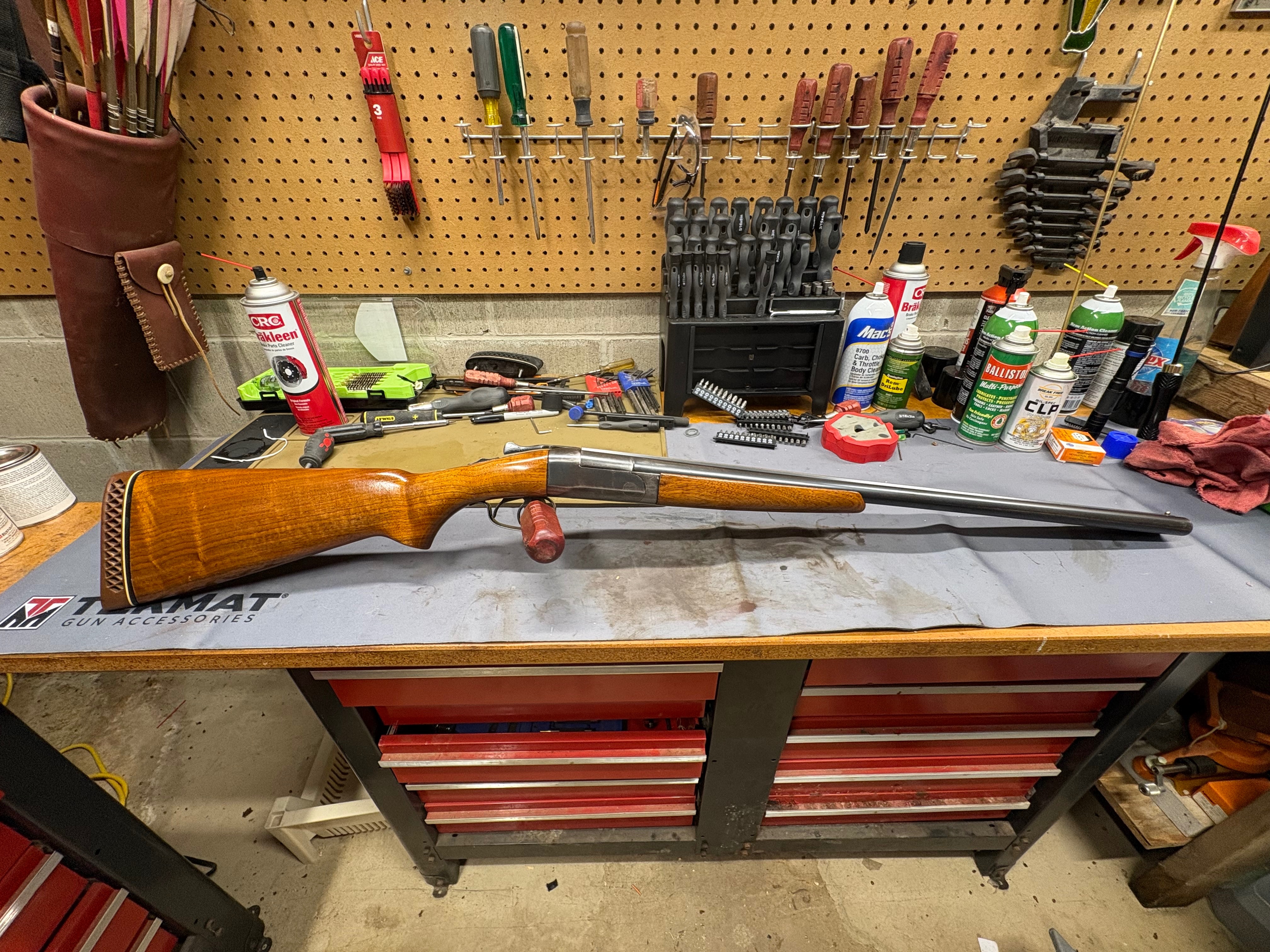

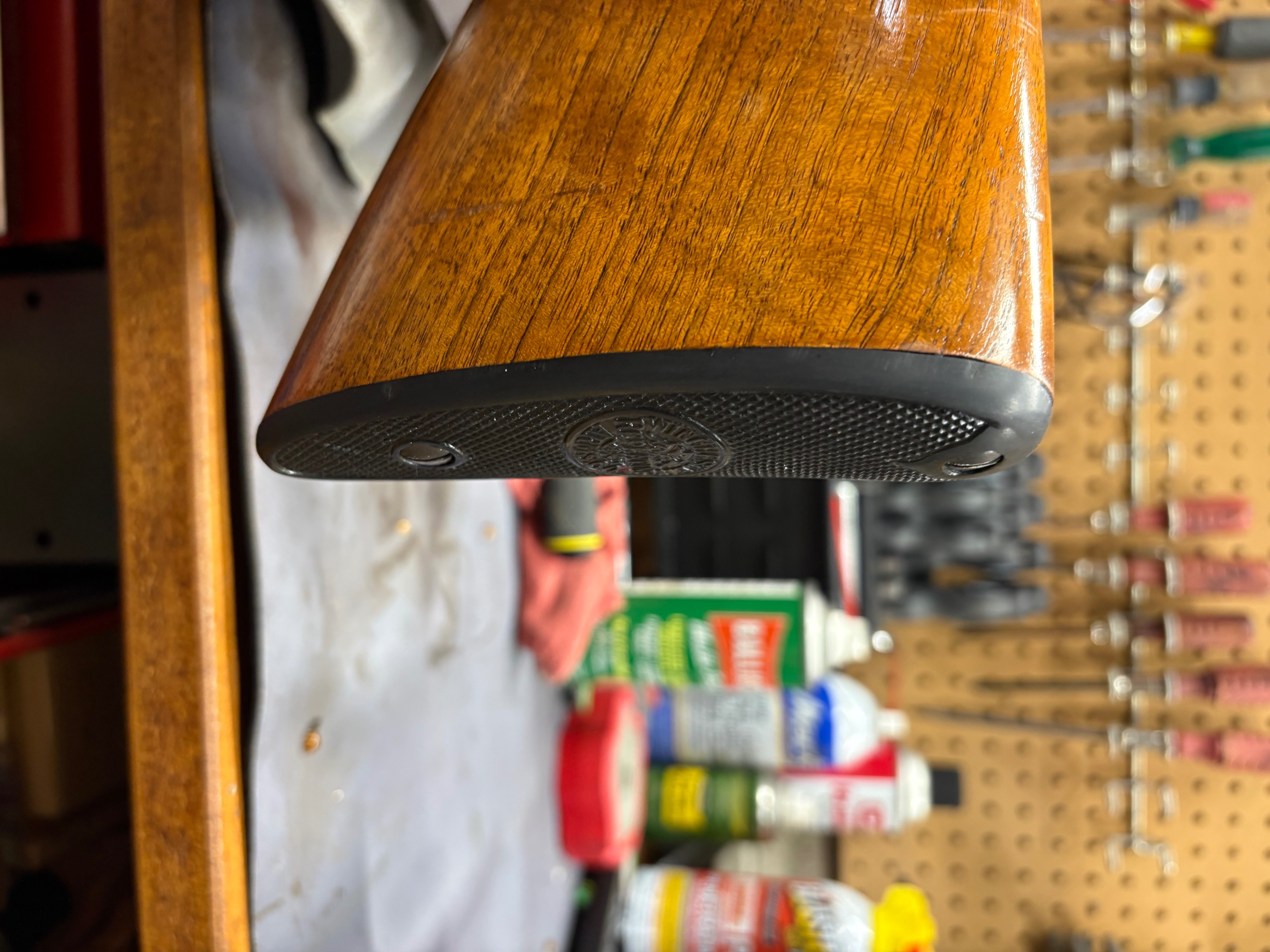

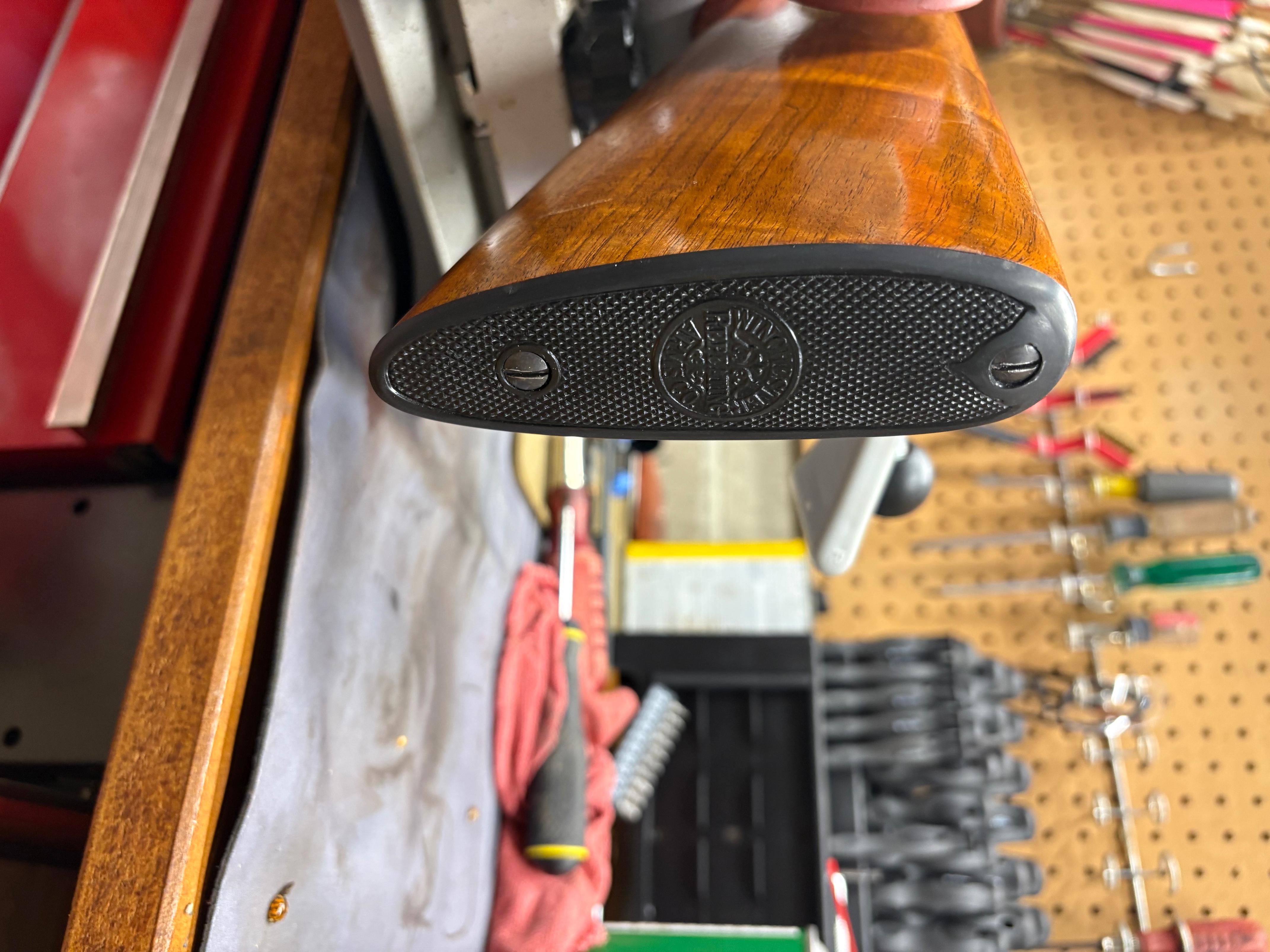

Installed a repro plastic butt plate.  Used a scotch brite pad on a die grinder.  Gouged a little in a couple spots.  Didn’t have the correct tool.  It worked.  Wet sanded with 600 grit to finish.

That looks so much better than the ventilated recoil pad. Good job!

Screws came from the same eBay store I got the plate from. 5$ I think. I since found that you can get a 12 pack of slotted screws from brownells for around $10.  I did tape the stock with masking tape. The scotch brite disk was a little too much.  I should have used something less aggressive.  The battery powered Milwaukee die grinder was new, I wanted to use my new shiny tool.  40 grit probably would have been better.  I got through the tape just slightly at the toe.  Wasn’t too upset since the stocks are already refinished.  Good candidate for some oxpho blue and getting the stocks a little more red sometime.

Looks really good to me.  I’ve done a few buttplate jobs and it is extremely hard to not fit one without some scratches unless you keep taking the piece off and on a hundred times.  40 grit WOW.  I never use anything under 60 for roughing.

Mark the area that is too large.  Take the plate off the gun. Use some sandpaper, around 200 grit.  When you get it to size use 400 grit then polish.  Not sure what you need to do?  Are the holes already in the buttplate or are you having to drill your own?  Assuming the holes are in the buttplate.  Make a paper pattern of the butt stock and punch the holes in it.  Align the pattern on the wood and drill pilot holes.  The holes need to be about the size of the inner part of the screw.  The area that is not threaded.  You want the holes small enough that only the threads will cut into the stock.

I taped the plate in place and drilled the holes.  I probably used too small of a bit.  I didn’t realize how abrasive the scotch brite was as I’m used to using it on metal. I should have realized it.  I’m guessing 40 grit would be less abrasive.  I think we have the same plastic replacement plate.  It came off a lot faster than I thought it would.  By then it was too late and I had to make the best of it. I wet sanded with balistol and I think that helped shine it back up.

Chuck,  the butt was not squared off for the thin recoil pad so it still has the proper draft for the curved buttplate. The original buttplate screw holes are long gone or filled and the holes for the pad are wrong for the plate. The repro plate is almost a perfect fit, overlapping in an arc at the heel maybe 1/4″ at the apex. The rest of it is proud of the stock less than 1/32″ — so hole location is critical. I’m reluctant to use anything but the plate itself as a drilling template and then start the holes with a self-centering bit. I would use a bit no larger than the screw shank. I’m.thinking green Gator.tape would hold it in place for my purpose.
The spring loaded centering drills are what I have and would use too.  Just didn’t know you had them.

I like how you “clocked” the screws . . . .just like on a very high grade gun!
I like to clock the screws on my re-do’s as well.

I like clocked screws as well. We most all do. It is wise use a tap for butt plate screws. There are appropriate taps available. An undersize hole for your pad can result in a crack. If no tap, drill your hole large enough that only the threads cut in to the wood.
