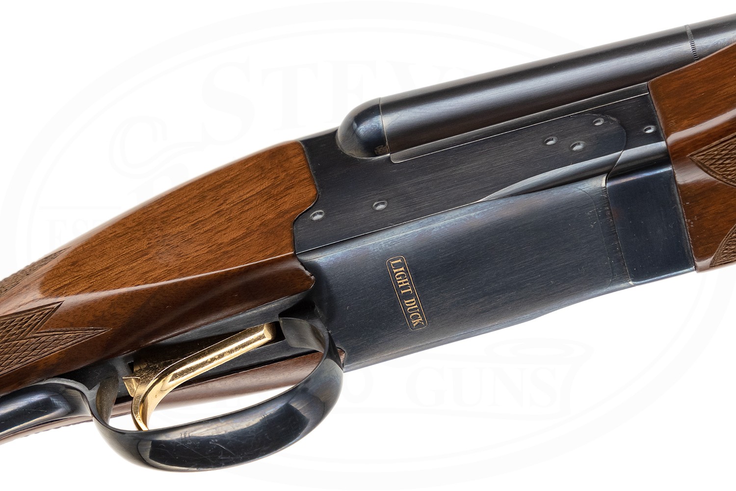

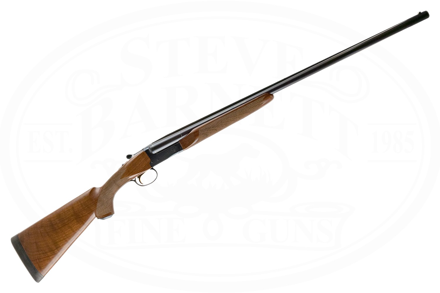

Hello folks,
I just bought a model 23 “light duck” from Steve Barnett fine arms and the serial number is LD-72E and from what I gather there are no letters or information on these models? Does anyone know what the letter E denotes? I already have a model 21 in 12g and needed a subgauge Winchester to compete in our Winchester Cup competition and figured this is a fine gun for that although the Full full chokes don’t thrill me!
Thanks I just wanted some input from those with experience on these models.’

My only thought would be that the E = Ejectors

I don’t think any of the Model 23 guns were made without automatic selective ejectors.  The Model 23 is essentially a version of the Manufrance “Robust” model, made by Olin-Kodensha for Winchester.
I once owned a Pigeon Grade Model 23 20 gauge with Winchokes and it was a fine upland gun for doves. However, I think the Light Duck version is far more elegant and closely resembles the Model 21 with its capped pistol grip and long semi-beavertail forearm.
If your Light Duck is in as fine a condition cosmetically as it appears to be and is mechanically the same, I would for my own use either have the chokes polished out to something more open — perhaps IC and Improved Modified – or investigate having tubes installed. I am not a waterfowl hunter.
However, the last time I looked on the Briley Website, the firm would no longer install tubes on side-by-side doubles. Briley’s last price for that work that I saw was five hundred dollars. Simmons used to do such work. I understand that it is an operation that, if done poorly, can alter where the gun shoots and not in a good way.

My plan is to send the barrels to Briley for thin walls or at the very least open them to IC MOD.
i looked at many of these and this is the cleanest one I found. I almost got a pigeon grade until I realized they have a semi pistol grip and the light duck just looks more like my 21, a mini me sorta!
