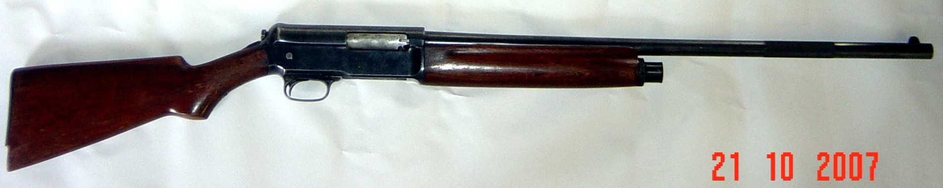

  • erial number and if marked with an “A”  Mine is A23455
  • barrel length (probably 26″ or 28″)…should ALL be 12 ga. 12 Ga 642 mm barrel (25.28 inches) -quite short
  • choke (full, cyl, or mod)  FULL Choke (surprising on a short barrel – I will get a choke gauge and check it later.
  • wood is most likely “plain” – Plain wood
  • the latest patent date on the barrel address (likely July 18 1911 or June 4 1912 -June 4 1912
  • any inspection stamps and where located – Only Winchester Proof centre top of barrel and Receiver

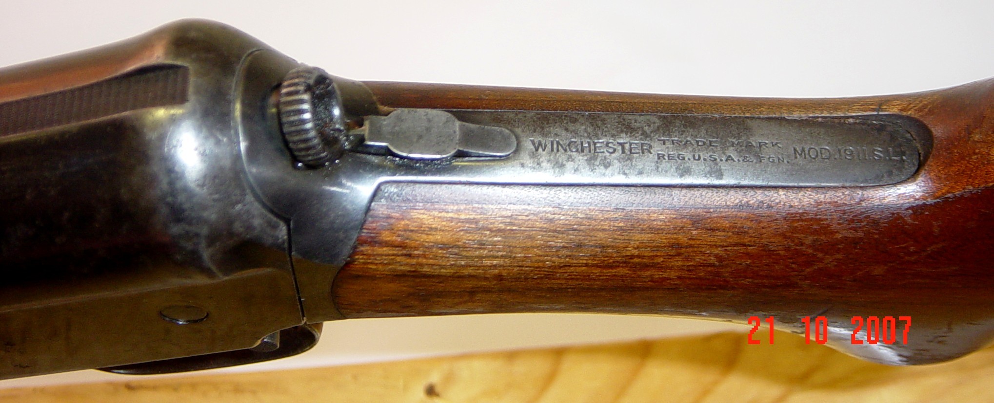

  • if serial number is 60,000+, please provide upper tang stamp (MOD 1911 or MOD    11)  Upper Tang is MOD 11
  • butt plate  (orig HRBP or replacement)  – Winchester Repeating Arms – Black “Plastic”
  • LOP  (measure center of trigger to middle of stock rear, likely 13.75″) – 350 mm = 13.78 inches)
  • an overall photo  See “Model 1911 SA Shotgun – 003a”  I bought th gun in 2007, and have uses it for my monthly Sporting Clays competition – with my own hand loads.  I could not hit anything until I fitted a recoil pad over the butt to give an extra inch of pull.  It is in excellent condition with no loss of bluing except on the upper tang.

Thanks for all the info Keith….are you double sure on the upper tang for the 23455? Up until 60k+ they should be “MOD 1911” with the “19” disappearing around 70k….everything else jives. Can you confirm that for me and send a pic maybe?

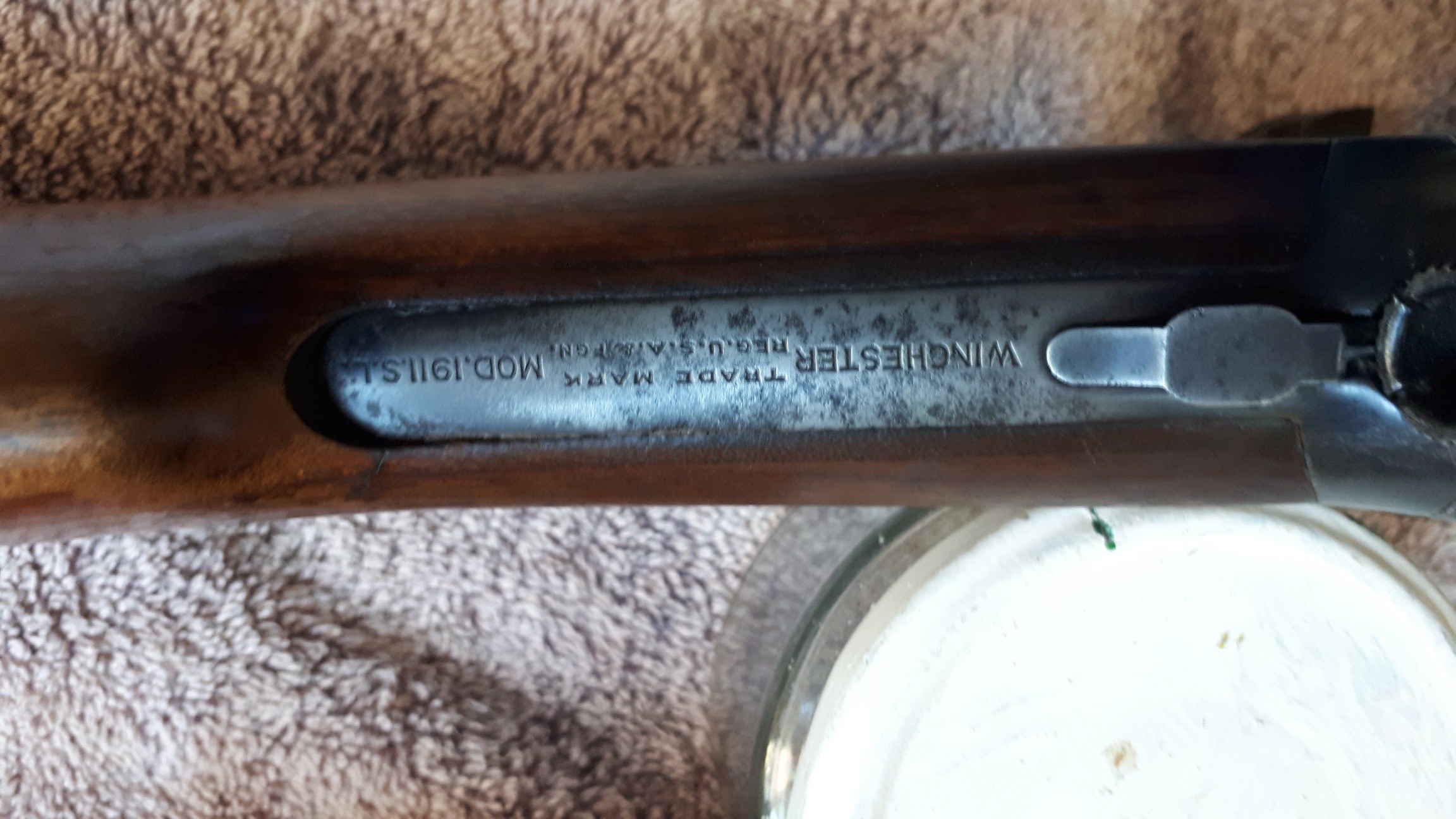

1.  are you double sure on the upper tang for the 23455?- good eyesight  See photo.  It is FULL choke and measures 17.50 mm = 0.689

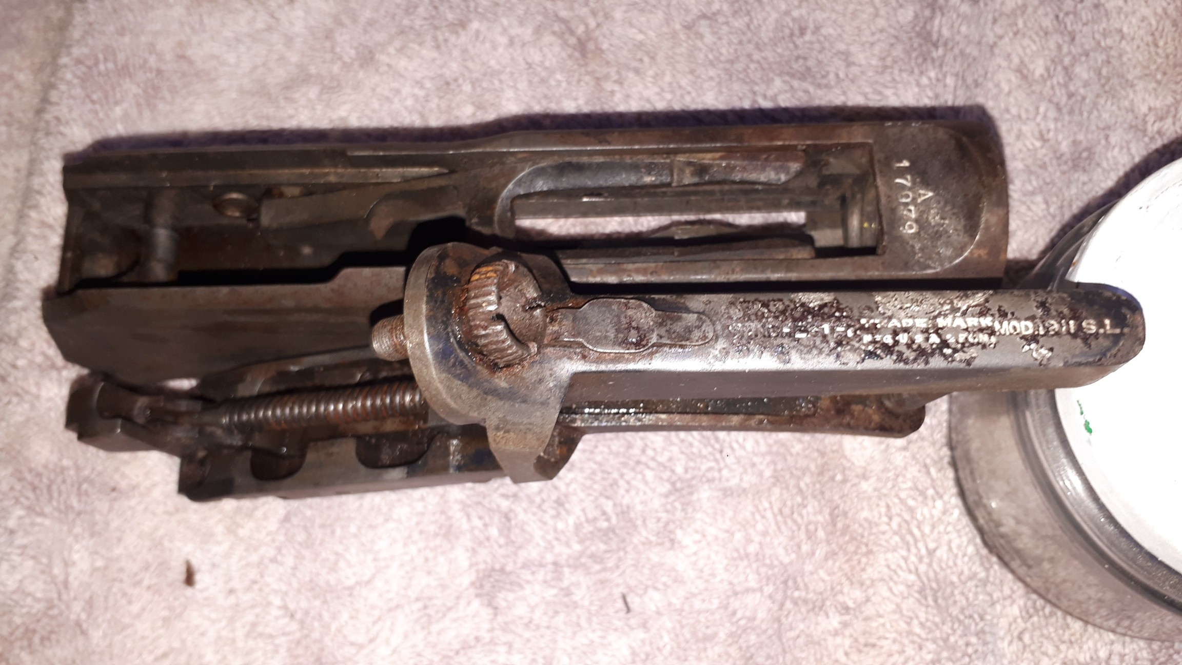

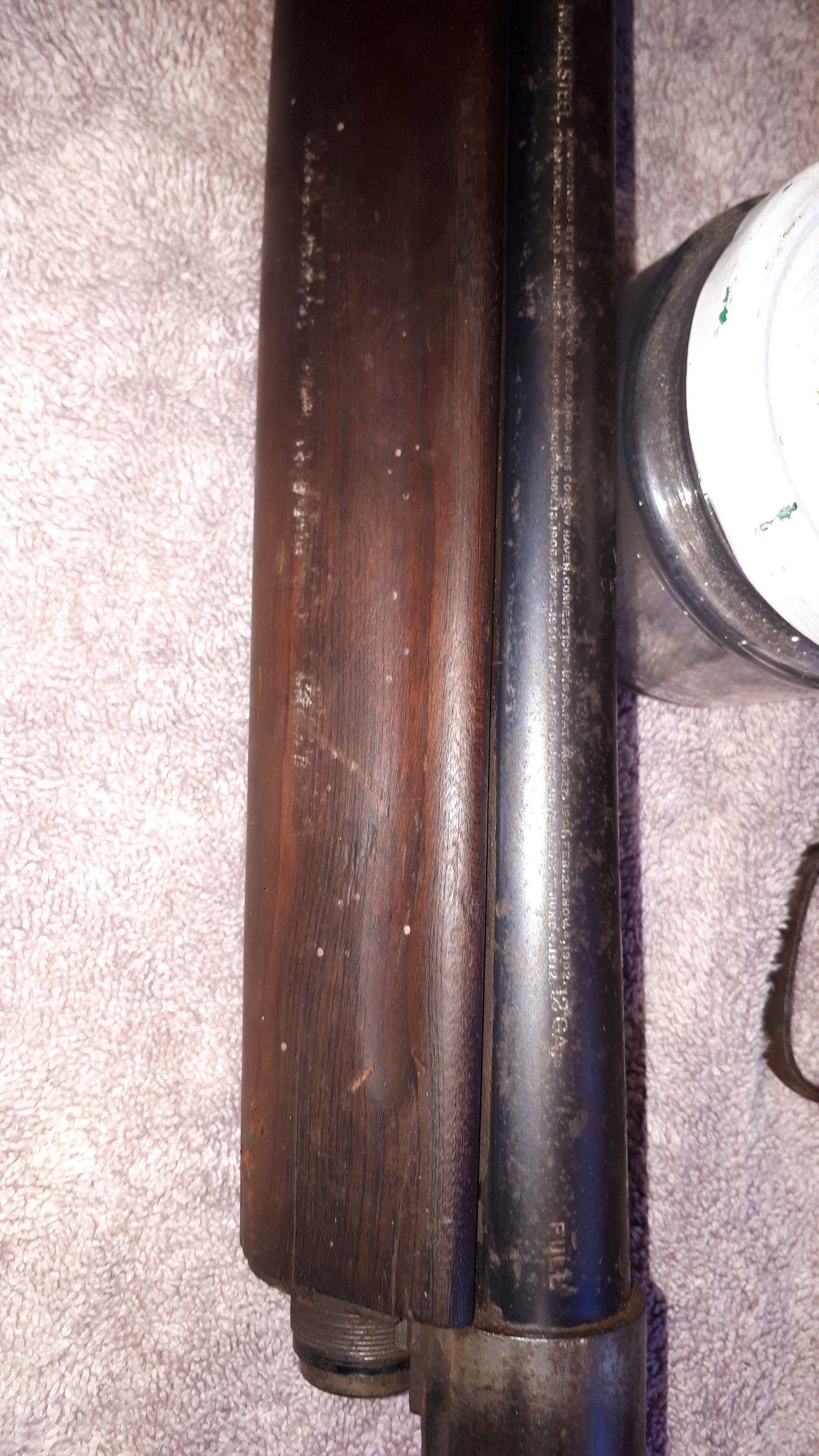

2.  details on # A17979 -Yes it has an A, and the Upper Tang is MOD. 1911 SA – see photos.  I have included a Barrrel marking – very small but the last patent No is 1912.  It is 640 mm long = 25.1 inches, and has not been cut, FULL choke measures 17.00 mm = 0.669 inches.  I assembled the stock and as per the photo it has a Recoil pad, BUT the stock has not been cut by comparison with my other gun, so it has the same Trigger Pull length.
As you can see, # A17979 is rusty – many guns were hidden and stored in damp conditions when they were banned in 1997 by the usual citizen, but were resurrected during an amnesty, the first being 2004.

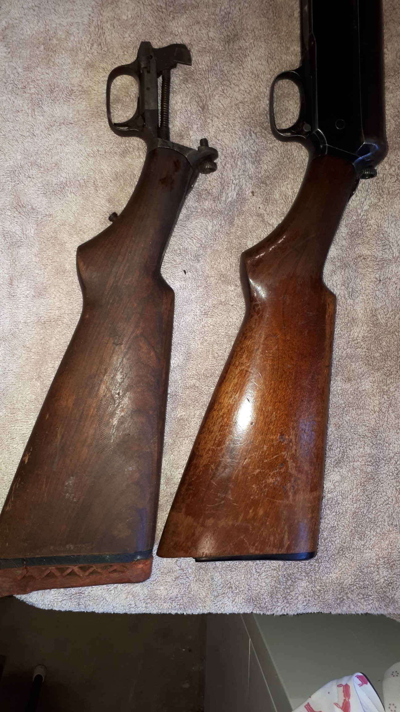

Model-1911-SA-Shotgun-A17979-Barrel-Markings-2.jpgModel-1911-SA-Shotgun-A17979-Serial-Number-Upper-Tang-2.jpgModel-1911-SA-Shotgun-A17979-Compare-Stock-size-with-A243455.jpgNumrich-Part-No-223380-for-Win-Model-1911.jpgModel-1911-SA-Shotgun-A23455-006-Tang-Markings.jpgModel-1911-SA-Shotgun-A23455-Upper-Tang.jpg
