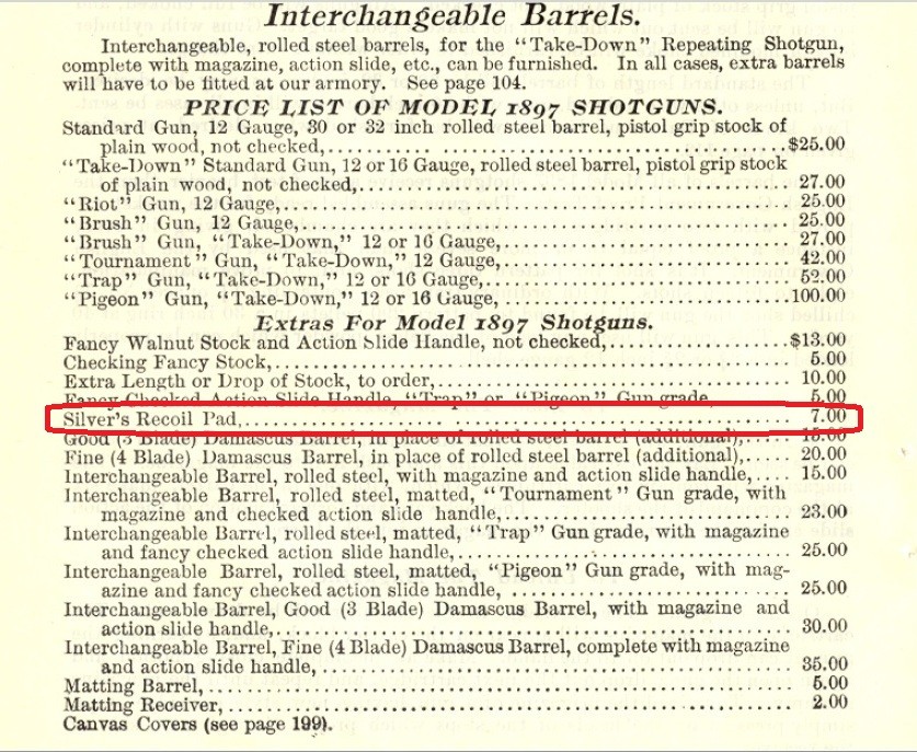

I need to replace the aftermarket pad on my 1897 shotgun. It’s a 16 gauge trap gun shipped on November of 1900. The reproduction Winchester pads I saw had a 1922 date on them.Would a Silvers pad be the way to go or are there other options?

Joe,
A Silvers pad would be the correct option.  Before Winchester began manufacturing their own solid red rubber pads, they installed Silvers solid red rubber pads on special order.
