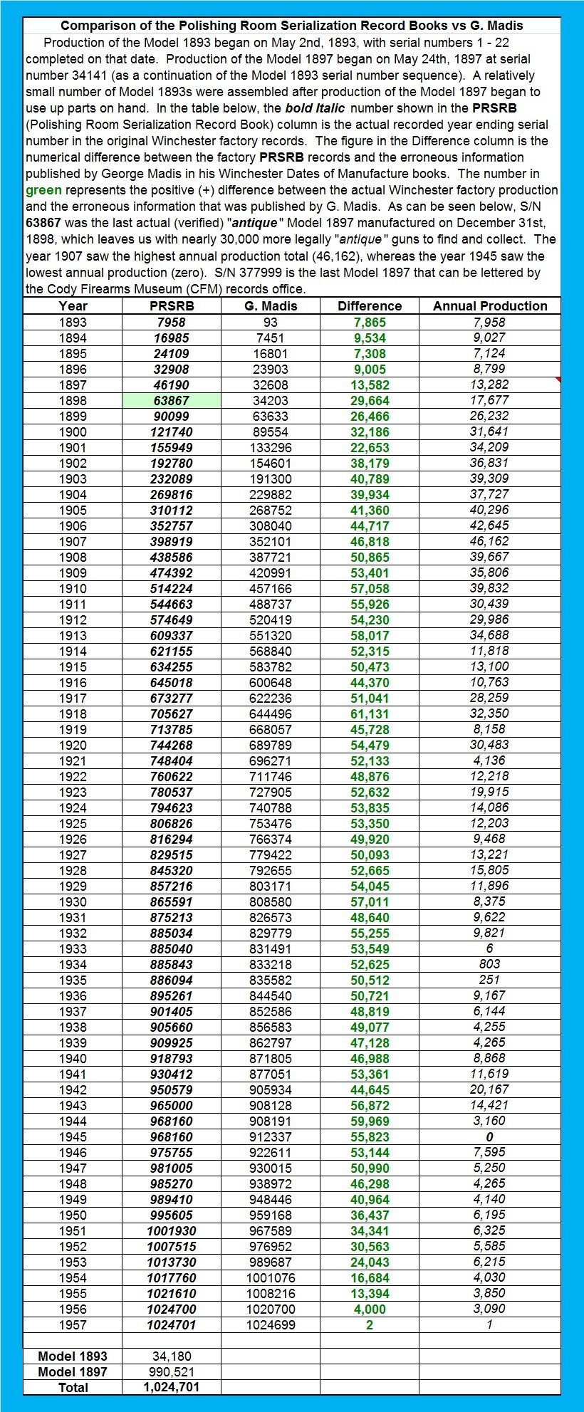

What is known, is that nearly all of the previously published Model 1897 date of manufacture information in books and on the internet are grossly inaccurate.  The only known accurate DOM look-up information for the Model 1897 is the one found here on the WACA website (I created it) – Dates -Winchester Collector
Further, I just recently published an informative article discussing the entire 60-year production run for the Model 1897, and in that article, I provided the annual production table listing the year ending serial numbers.
