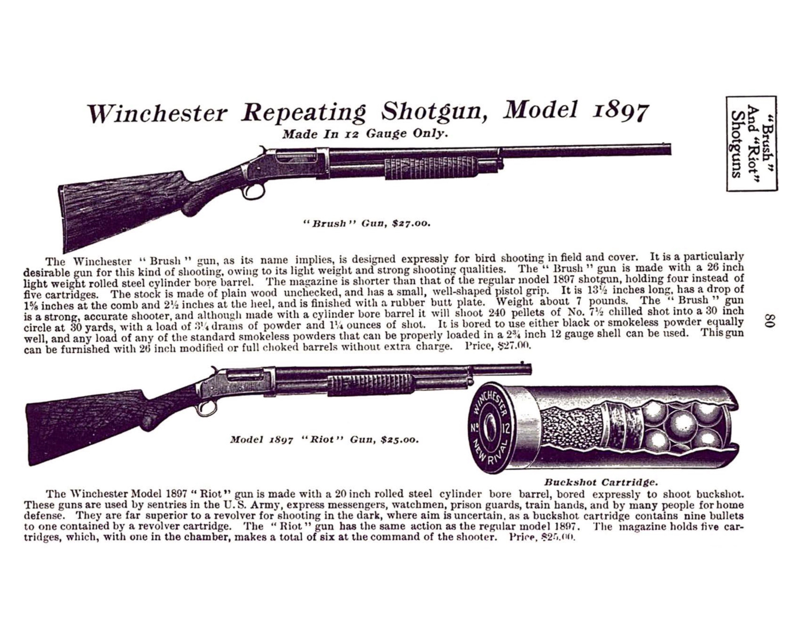

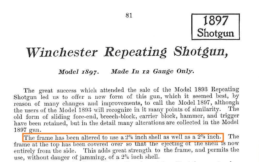

Peter,
I believe that those “indications” you mention are a result of the original Winchester catalog description for the new Model 1897.  The attached picture is a scanned copy of the February 1899 Winchester catalog.
As Tom has correctly stated, all Model 1897 Shotguns were factory chambered for a 2¾” shell.
