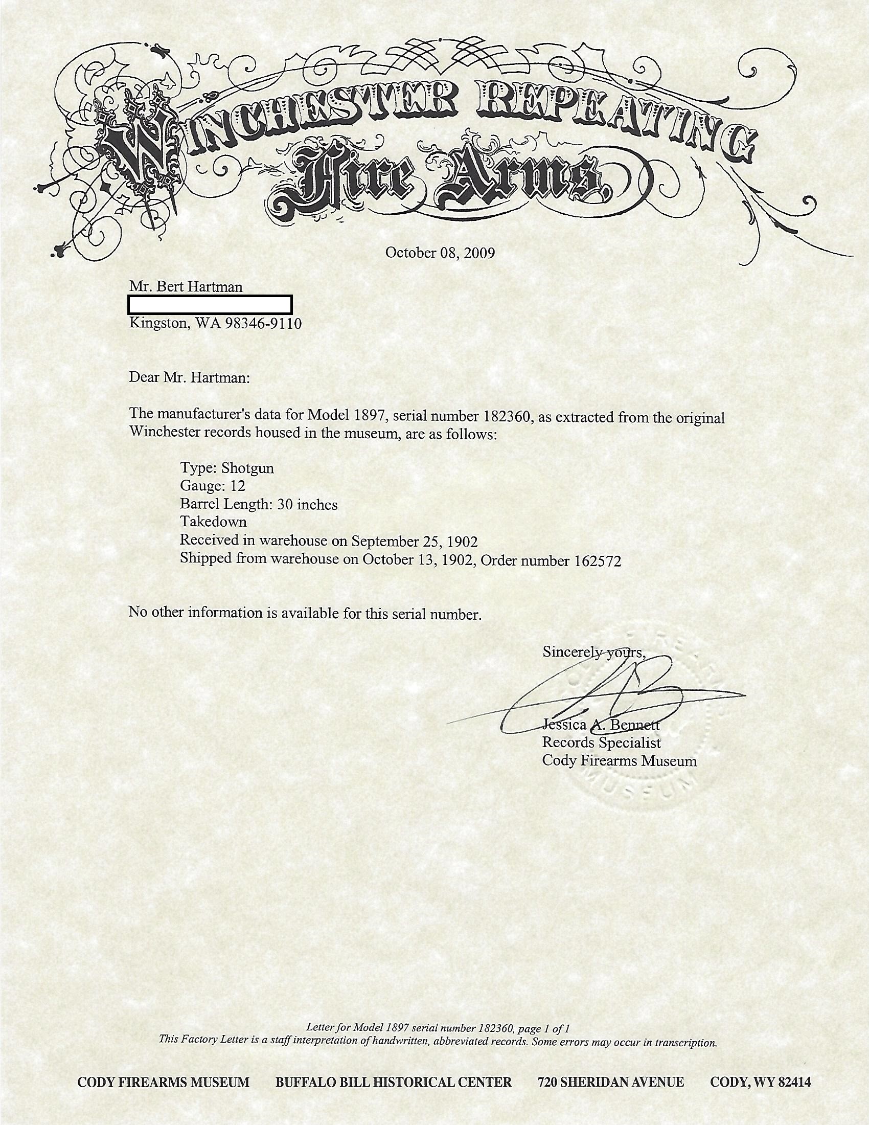

The barrel has been modified, and it was most likely originally 30-inchs in length (standard) with a Full choke barrel.  Apparently it was cut down (shortened) to install the aftermarket Weaver choke.
If you are interested in determining what the original configuration was, the Cody Firearms Museum (CFM) record office can (for a modest fee) provide you with a factory letter that will contain all of the information that was recorded in the original Winchester factory warehouse ledger record.  The letter will look something like the example I have attached below.

Bert, after noticing your 1897 riot gun at the Cody show last weekend, I had to dig mine out and see how it compared.  It looks like it may be part of the batch that you reference above.  Here’s the specifics on my shotgun.  I don’t know if you have it in your research survey.
The factory letter says the following:
Model 1897, serial number 100728
Serial number applied June 6, 1900
Type:  Shotgun
Guage:  12
Barrel Length:  20 inches
Riot
Received in warehouse on June 07, 1900
Shipped from warehouse on June 12, 1900.  Order number 61487
Not mentioned in the factory records, but its a solid frame.  Also the barrel appears to be 20 inches in length, but it was originally stamped FULL, and now has a CYL marking stamped directly under the original FULL.  It’s also configured with a Herter’s Inc. adjustable choke.  I assume the entire barrel has been replaced and modified, but just curious if you think it was originally part of the Texas shipment to keep the peace in Galveston.
Roger
