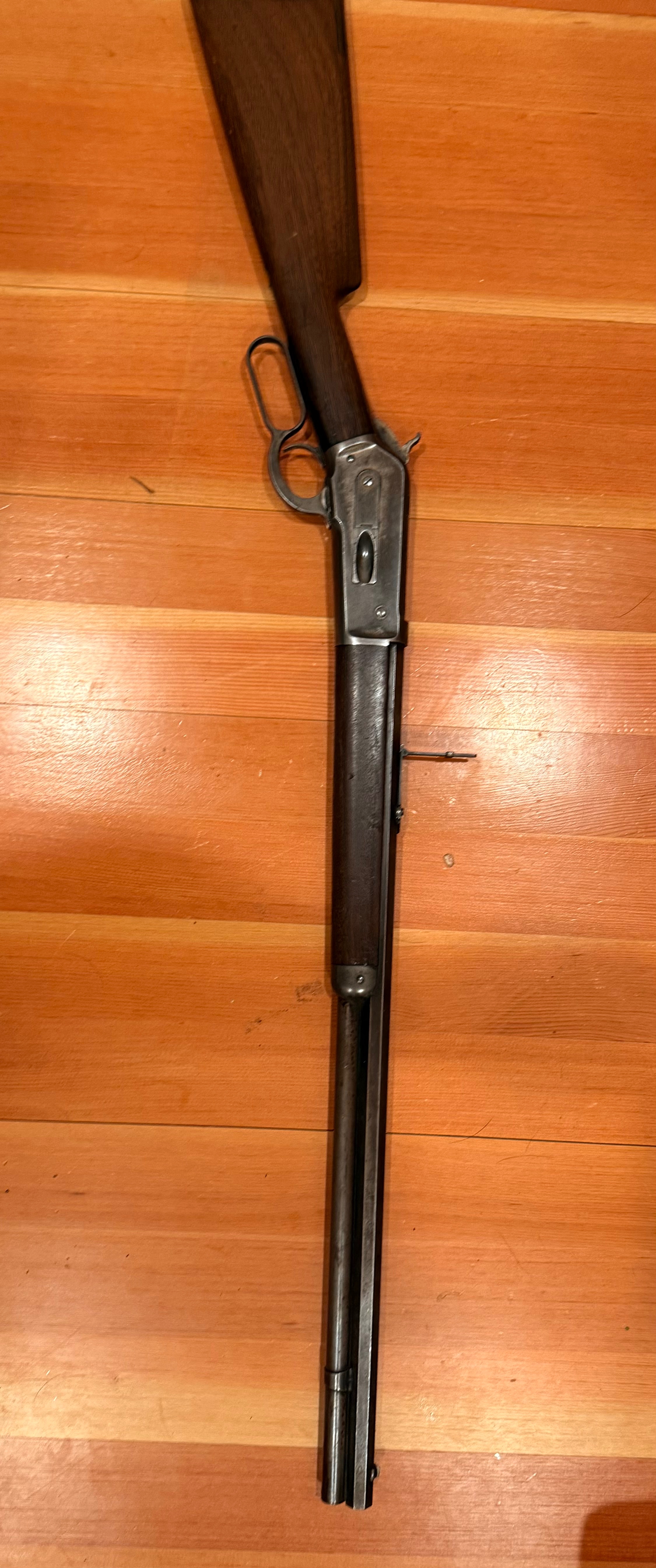

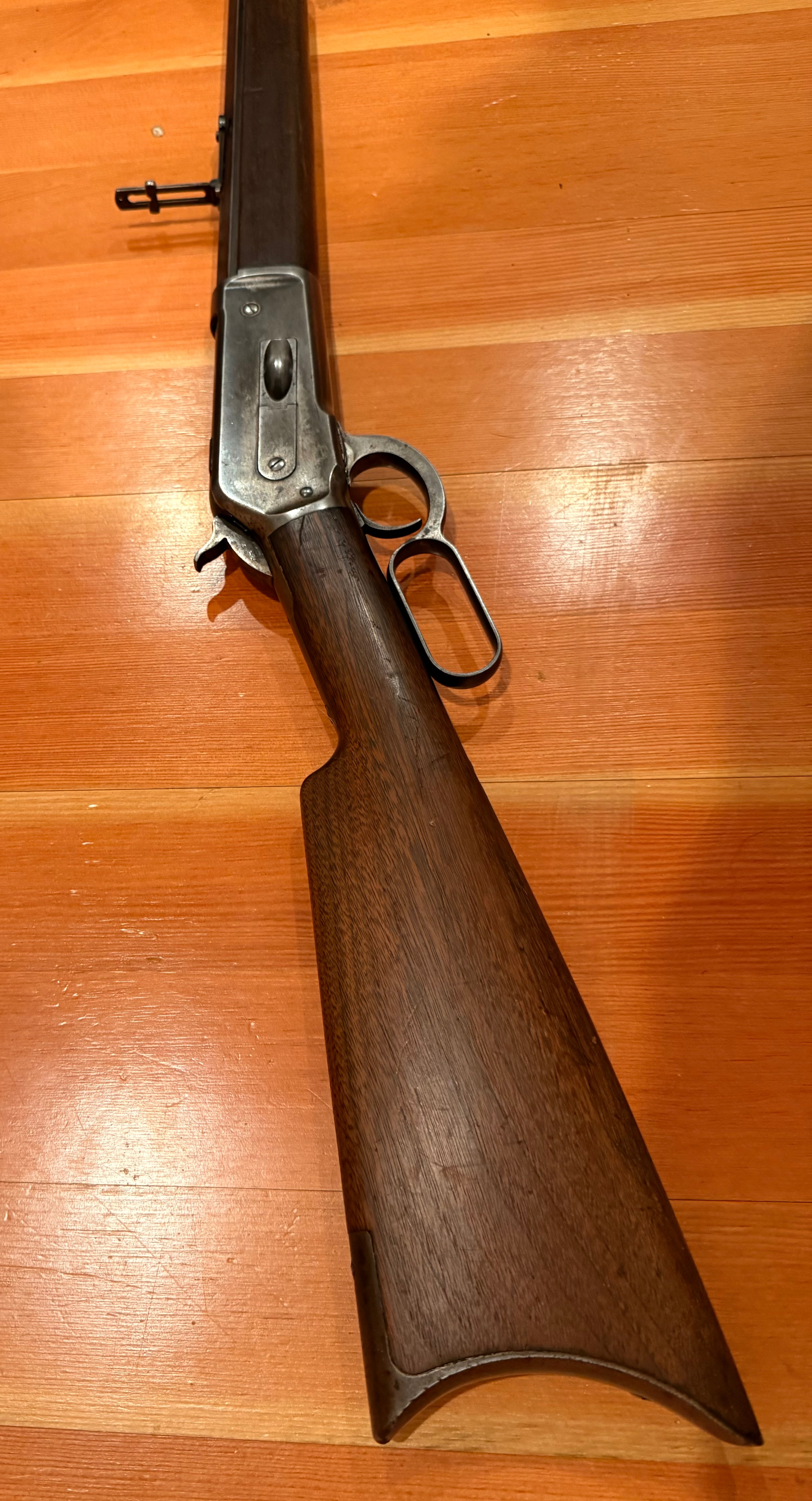

IMG_2902.jpegIMG_2901.jpeg Here is the 1886 serial 754

Model 1886- Serial 28334, produced 1888.  Looking for some assistance on Caliber, either barrel has been shortened, or not marked from factory. Any way to get production specs?

Model 1886 45-70 Serial 754 produced 1886′

For your Model 1886 s/n 28334, the Cody Firearms Museum (CFM) records office can provide the details for a modest fee.
