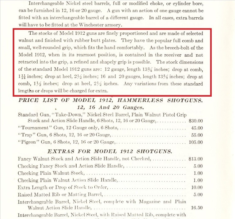

Model 12 stock dimensions
Dueeast
Forum Posts: 3
February 10, 2026
February 11, 2026 - 9:30 pm
Please help with 16 ga. LOP DAC and DAH Thanks
Forum Posts: 14956
February 12, 2026 - 5:18 am
Please help us with a serial number, and which specific variation it is… not all Model 12 shotguns were the same.
Dueeast
Forum Posts: 3
February 10, 2026
February 12, 2026 - 2:46 pm
Ser. # 1073xx  Field model plain barrel
Forum Posts: 14956
February 12, 2026 - 5:45 pm
That makes it an early production (December 1914) Model 1912.  Per the Winchester 1914 catalog;
