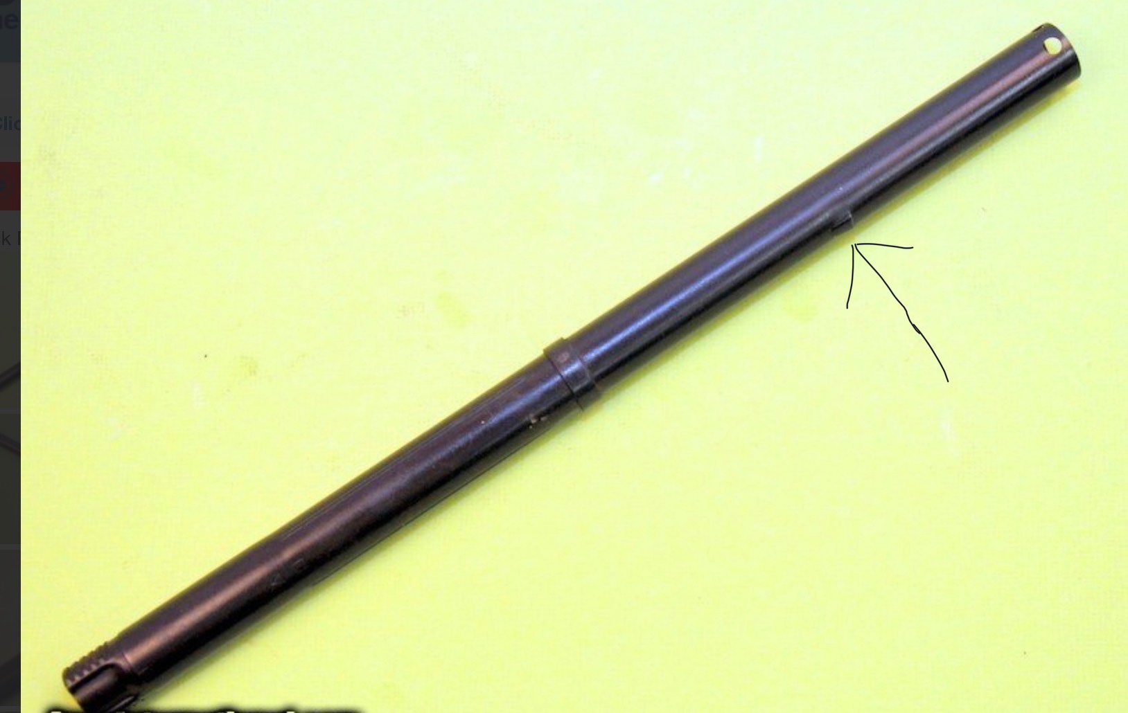

I believe it provides a small amount of “binding” when the forend is pushed forward as part of the takedown operation.
Keeping that forearm “under control” during takedown, will help ensure no marring at the left-front of the receiver during reassembly.
On the Model 97, a flat leaf spring accomplishes the same “binding.”
Steven Gabrielli
LI NY
Forum Posts: 491
August 14, 2021
April 3, 2026 - 4:46 pm
I was thinking it allowed air to escape will loading a full mag, IDK. Never saw that on other makes of pump guns, was it really needed?

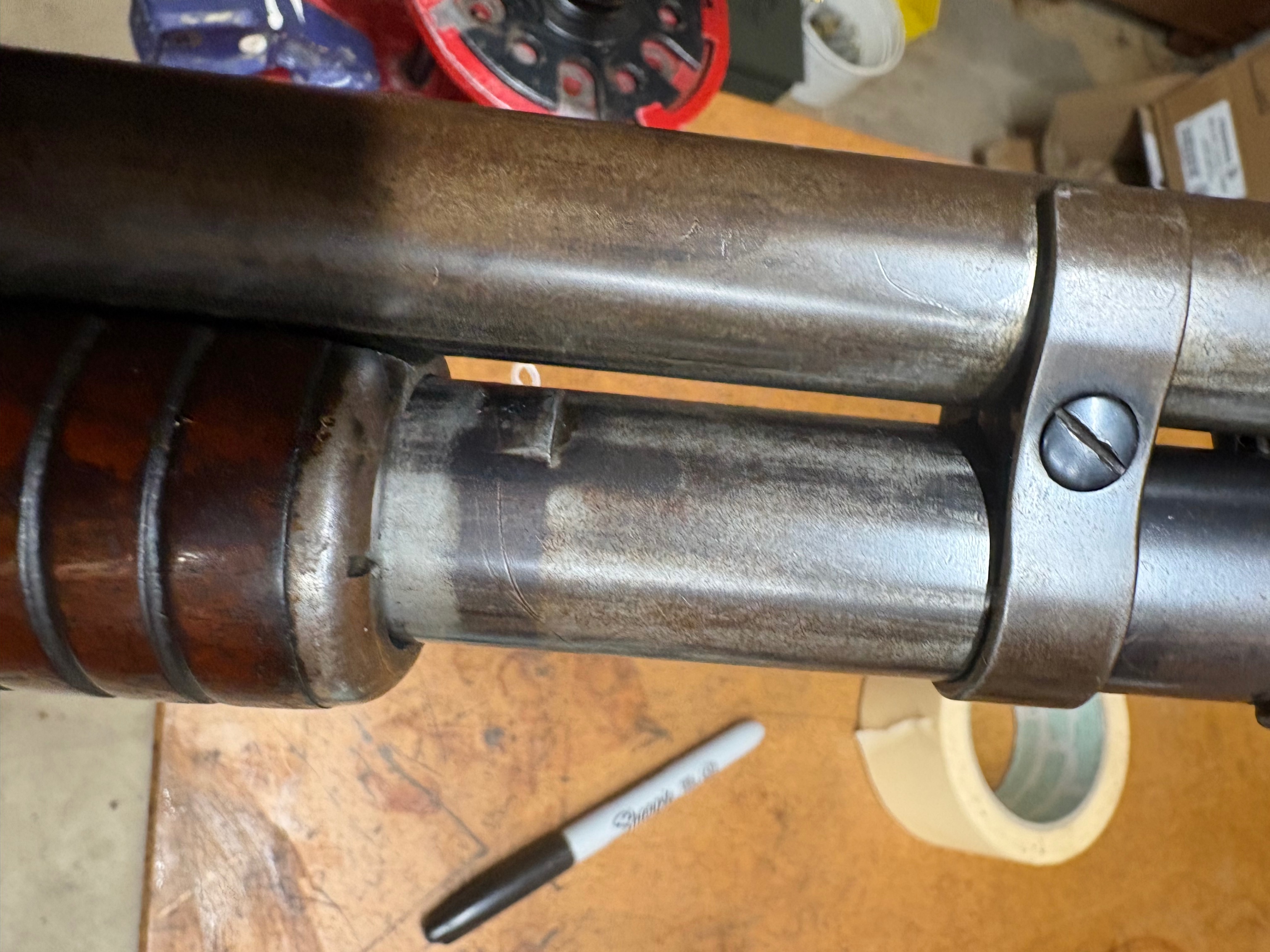

IMG_1896.jpegMy 97 has the same thing.  I thought it was a stop. When you lift the mag tube to take it down it stops on the mag holder
Forum Posts: 14939
April 3, 2026 - 10:06 pm
It is the magazine tube stop tab (to prevent ramming the forward end of slide handle into magazine band when taking the gun down).
Steven Gabrielli
LI NY
Forum Posts: 491
August 14, 2021
April 3, 2026 - 10:14 pm
Ah thanks to you all.
