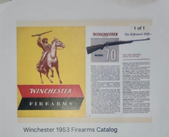

Thought I would add this just for clarification.
The Winchester catalog calls it the “Model 12 Heavy Duck Gun” until end of 1951.
In the 1952 and 1953 catalogs it’s called “Model 12 Duck Gun”,
From 1954 on, it’s called the “Model 12 Magnum Duck Gun.”
Just fyi.
 Interesting information.Thanks for posting.Seems I remember seeing the 3 inch Model 12 listed as Magnum Duck Gun some where in the past.
Here’s the “Magnum Duck” call out in the 1956 catalog. I’m trying to find my 1951(“Heavy Duck”) & 1952(“Duck Gun) catalogs showing the changes.

Just the follow up of the catalog name changes.
Magnum Duck Gun 1954
Duck Gun 1953
Heavy Duck 1952

 From those catalogues ,it would seem the special vent rib heavy/magnum model 12 was not available until 1954.The 52 and 53 catalogues list only plain and matted barrels for the gun.So it would seem, that vent rib barrels were no offered until then or perhaps as a special order feature only.
  Thanks for posting,Rick.
Rick C
Forum Posts: 1007
March 14, 2022
March 21, 2024 - 4:12 pm
Winchester “Special” Ventilated Rib was only a catalog offering on the Model 12 Field Gun in the January 2, 1954, and the January 24, 1955, Winchester catalogs.
It’s not offered in the big 1955 Winchester catalog or the September 30, 1955, or any after that.

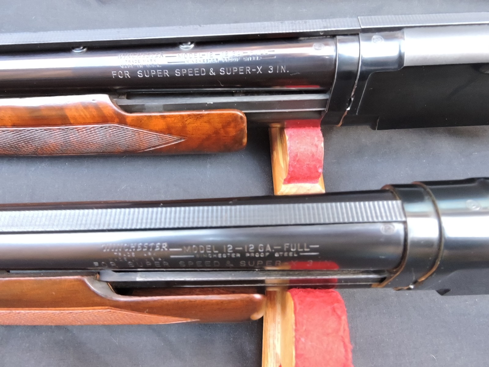

A little late information that may help.  I am having some dificulyy learning to use my new camera and it’s settings.  These pictures may be updated later.  These two Model 12s with the 3″ chamber may help.  The solid rib, ser. #1545538 dates to 1954 production and vent rib ser. #1626627 dates to 1955 production.  Both have 30″ barrels and the solid rib does not have the plastic “Grip Cap on the pistol grip.  The ventilated rib is the Winchester “Winchester Special  Ventilated Rib”.    RDB
