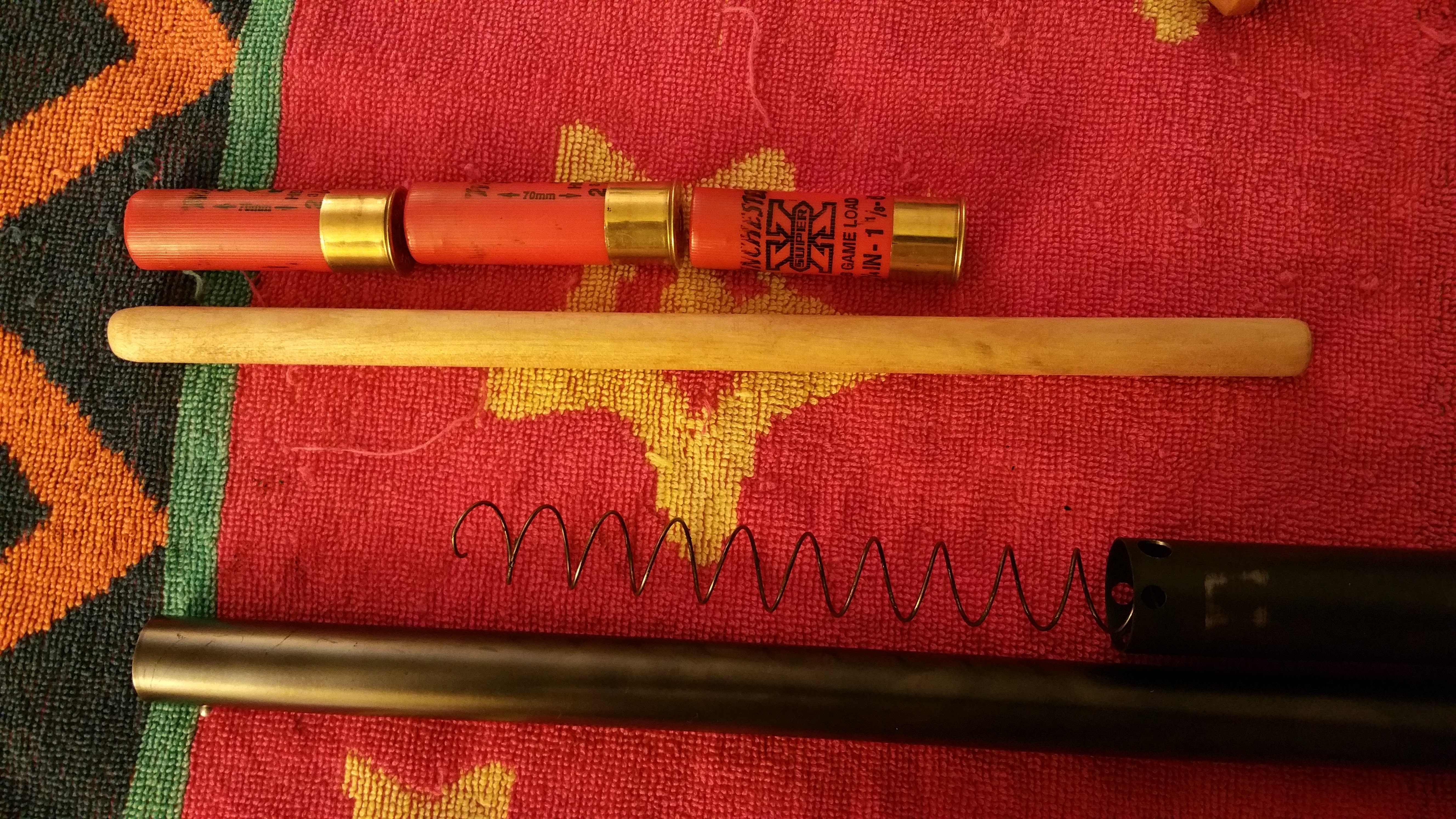

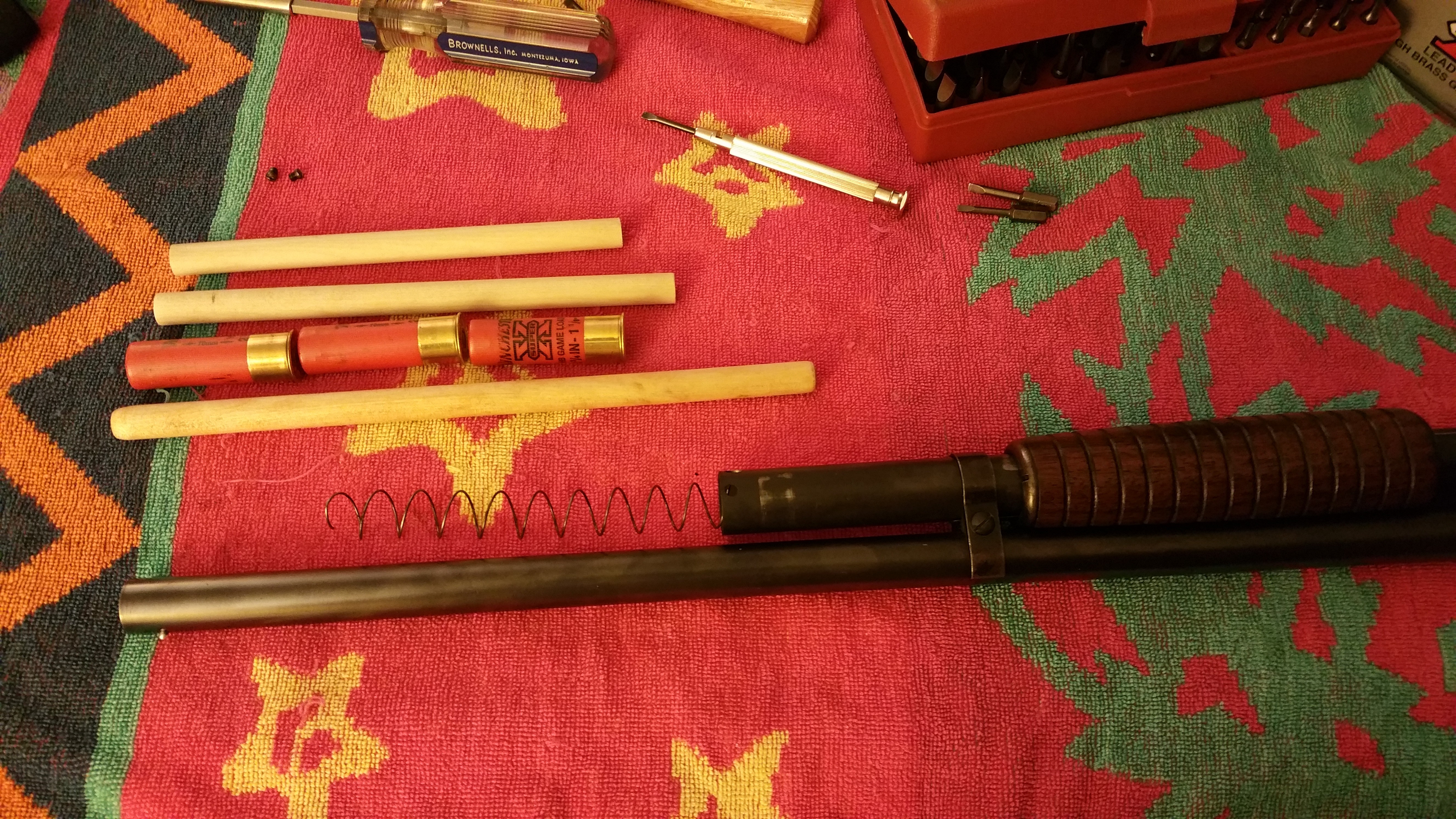

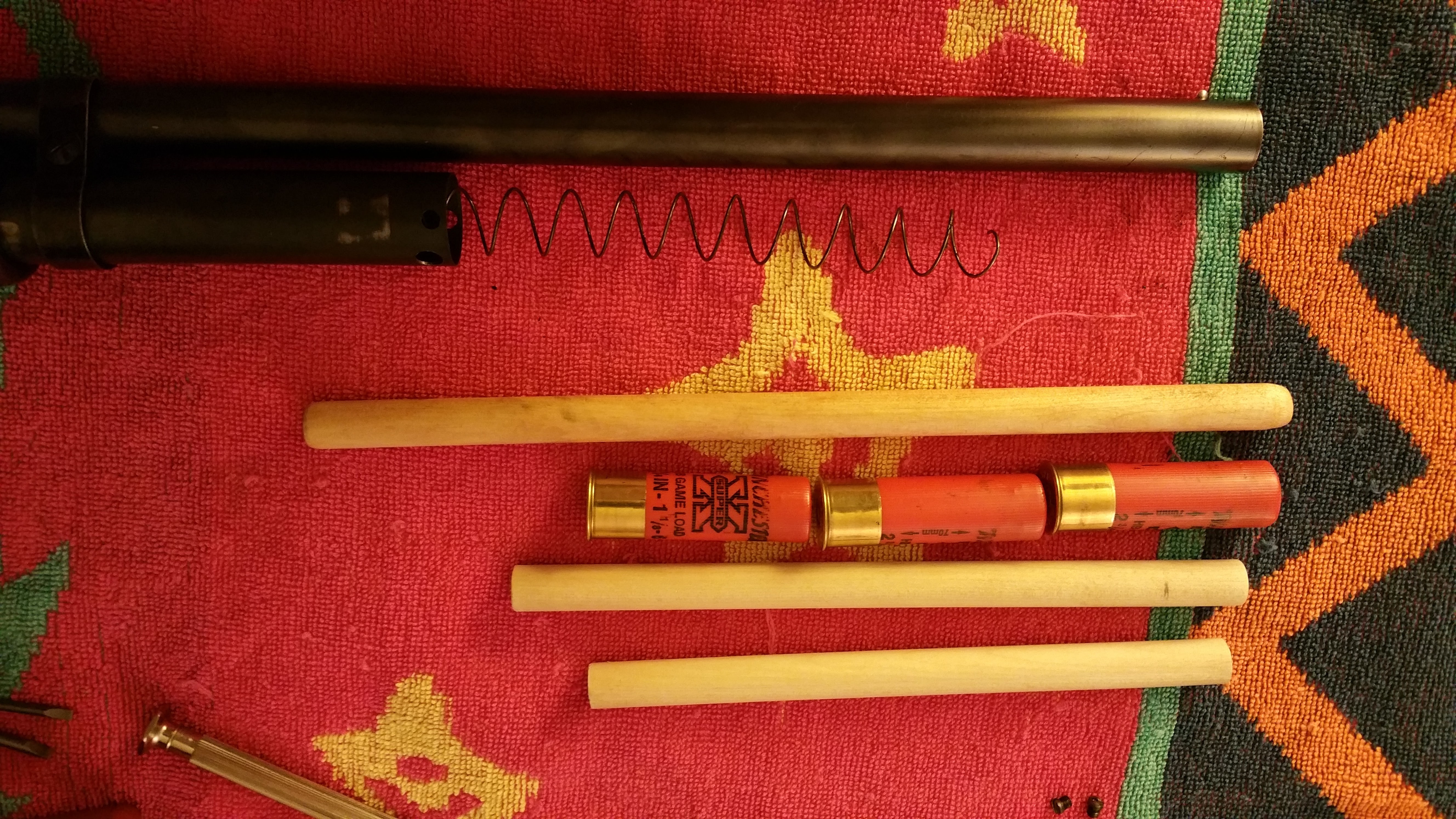

These calculations are rough. In order to assure there will be enough capacity remaining for two shells, the plug should be about 6.5 inches long, which will still not permit the full length of a third shell to enter the magazine. 20150917_082551.jpg20150917_082609.jpg20150917_082617.jpg
11.875 – (6.5 + 4.75) = 0.625 MAX
11.250 – (6.5 + 4.5) = .250 MIN
I would try a 6.5  inch plug and make sure two will clear the stop but not three, to accommodate Murphy. If shell #2 won’t clear the stop, note by how much, add a hair more and cut back accordingly. Obviously, don’t round and finish until you’re happy with function.
At the risk of telling you what you already likely know, the plug is installed inside the magazine spring. Winchester used Oak or Walnut stock. A 3/8″ diameter Oak dowel is perfect. Round the ends to avoid hangups between coils. I think Winchester sealed theirs with lacquer or shellac. I brushed on a sealer coat of shellac and applied a couple of coats of paste wax, before installing. The one in my son’s Browning Light Twenty has been there almost 40 years. Others I’ve installed in Model 12s went down the road with the guns.
