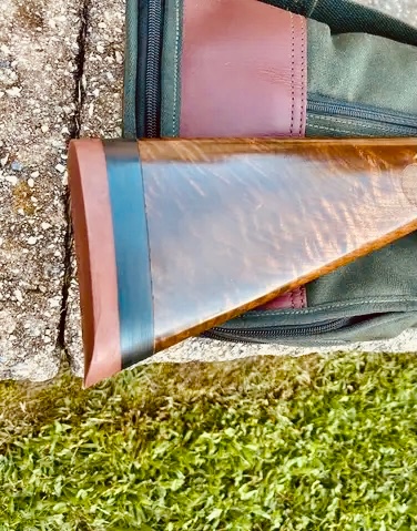

Rick, a couple of Decades ago I walked into a small town gunshop owned and run by a good gunsmith of my acquaintance. On his consignment rack was a virtually new Browning “BPS” 20 gauge in the “Sporting” version – English straight grip stock and 25″ ventilated rib barrel milled for choke tubes. Factory box, papers, 3 tubes.  It had excellent balance and great condition. What’s more, it was made on JMB’s bottom-loading and ejecting action so no side port.  Really pretty and at a ridiculously low price, around $300.
The reason why was it had been cut down for a kid. The LOP was about 12″ including a black Pachmayr “Old English” pad.  I thought about it for maybe two seconds, consulted the gunsmith/owner about the cost to install a flat black spacer to bring the LOP to 14 3/4″ , and bought the gun. About 3 weeks later I picked it up and I wish I had pix to show because it was a beautiful job. My son-in-law is holding it for my grandson.
I don’t own a Purdey or a Boss or a Holland sidelock bird gun and never will but I have seen a fair number of them with black spacers,  added as a lucky young sportsman grew up or as an adult inherited a gun built for a shorter ancestor.  Some of these things were built between World Wars and stay in families that probably couldn’t afford a new one, now priced like a Porsche 911. Throwing away exhibition grade Circassian Walnut is a non-starter,  so spacers and pads get added.
A good gunsmith can put a pad and spacer on your Heavy Duck and it will replicate a factory job so closely you can’t see the difference. I would get him to install a removable pin in the pad so you can stand the gun im the safe without the pad collapsing.
