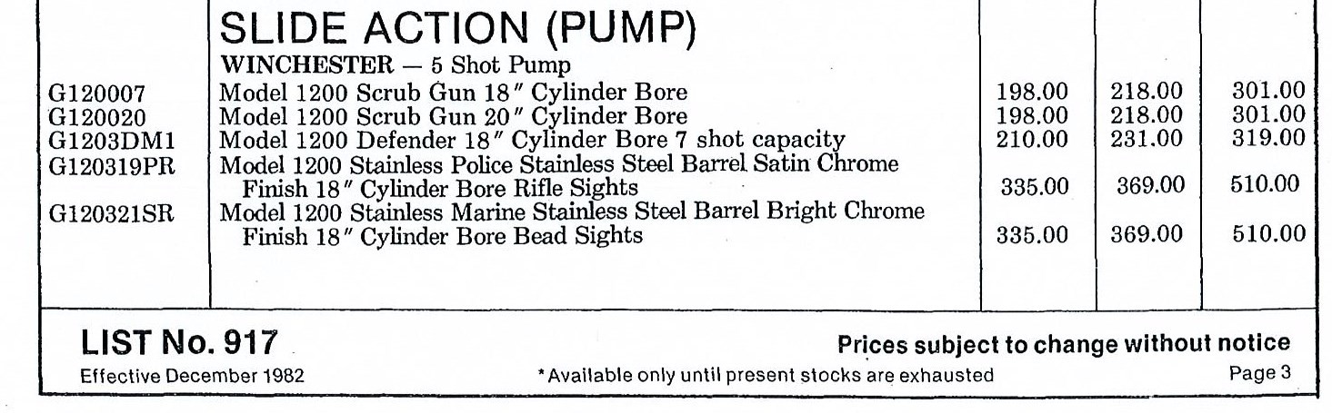

Laurent, Bert is correct about the year, and again you may have a model 2200, as they were made until 1989, were sold in Australia and I have also found them in France. Model 120s and 2200s were not sold with 18 inch barrels, but Model 1200s were still sold with 18 inch RIOT barrels in 1982-83.  The attached “Figure 1 Excerpt-1982-December Winchester Australia Price list # 917 Page 3” shows how they were advertised in Australia in 1982.  Although they were advertised as “Scrub Guns” they were the Model 1200 RIOT model as can be seen from the UPC Numbers G120007 and G120020.  If you either Post or send me by email photos I can advise further.
