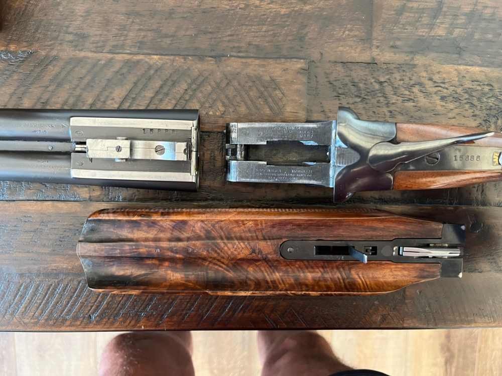

Mike has a point worth investigating.i had just assumed that your gun was manufactured as a two-barrel set, but Mike and I know nothing about the gun’s provenance.  It would be very helpful to see photos of the markings on the Skeet set compared to those on the field set.
Do you know anything about the history of the gun?
The barrels of a Model 21 are marked with the gun’s serial number. Make sure both sets have the same serial.
One of the things you should do is contact the Cody Museum and obtain a letter. My understanding is all or virtually all of the Model 21 guns made are “letterable” – unlike other Winchestet
The letter should tell you whether it was originally sold as a two-barrel set. If it wasn’t,  it should tell you which set of barrels it was made with. I’d guess the Skeet choked set.
Is it possible your field choked barrels were made up later and not used?
However, you really should get a Cody letter, to know what you’ve got. If you will show us the stamps and marks on both barrel sets, that would help immensely.
EDITED: I misread your post and erroneously thought it was the Skeet set that was hard to open. pix774304630.jpg

This is a two barrel gun marked skeet.  Both barrels share the same serial # with the frame and forend.  I purchased the gun from Steve Barnett three months ago.  BTW I love the gun but I am a reformed skeet shooter and I use the gun for 5 stand with the skeet barrels and I use the F/M barrels for quail (they run in NM) and perhaps pheasants. I may try sporting clays with the skeet barrels.

If I had to guess, based on your balky fitting barrel set having been made up in New Haven with the rest of the gun, that you have a maintenance problem. Although, in your case, it might be possible the tight-fitting set has never been used enough to wear in.
I expect you’ve already tried Gunslick or something at the wear points. If that and repeated shooting doesn’t solve it, you’ll have to have it looked at.
Unless the barrel connecting parts were dropped on concrete enough to be slightly  distorted but then polished off to conceal the flaw?
Why don’t you apply Gunslick or some other opaque viscous grease to the assembly parts of the barrel set only, then assemble the gun, opening and closing the breech several times. Then disassemble the gun and see what parts of the barrel have been disproportionately affected?  This at least might indicate where the interference is located.
