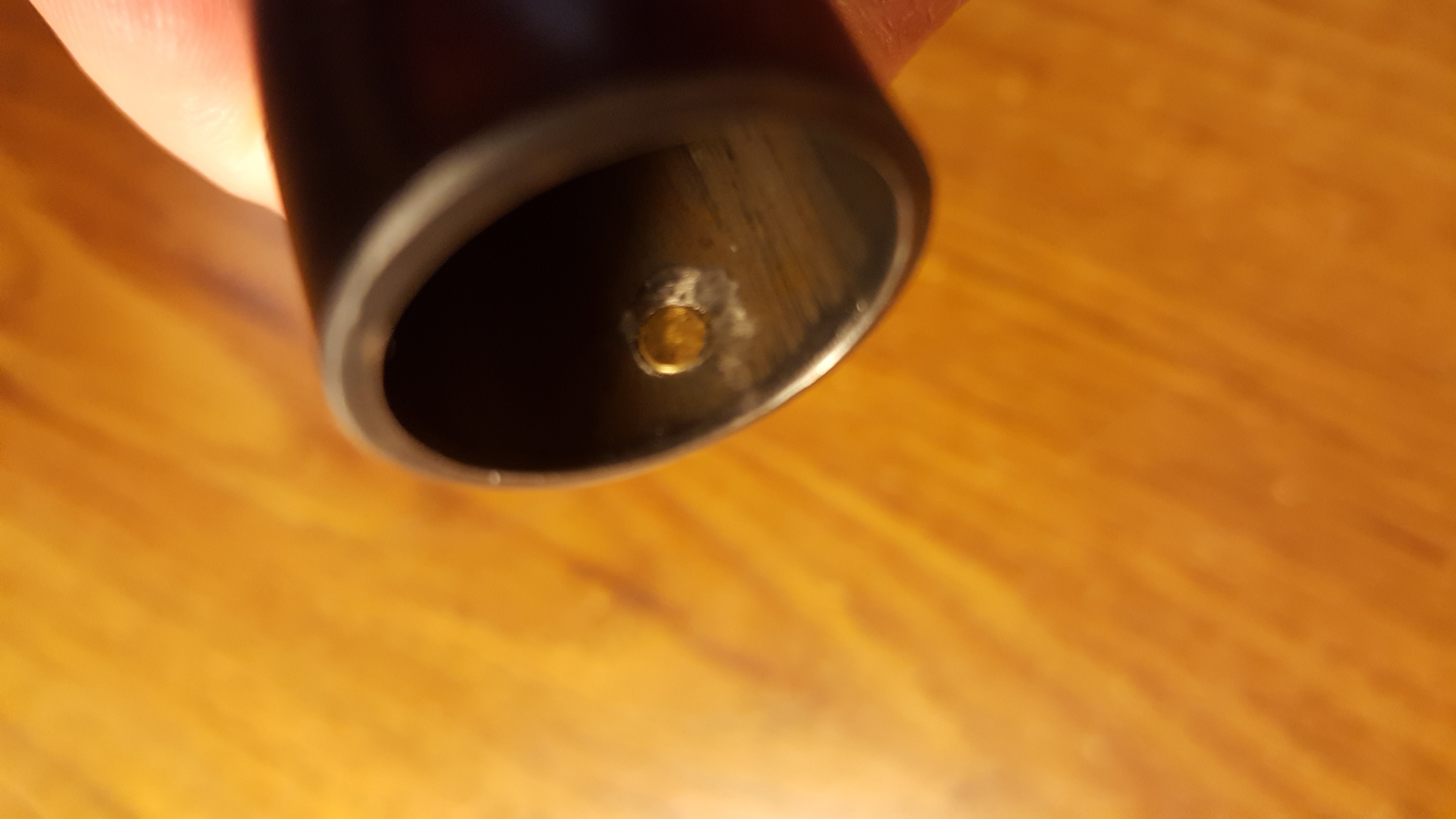

Here are some barrel and site pictures of a solid frame 1897 manufactured in 1914 that is supposed to be a riot gun. From the bolt to end of barrel measures 20 1/8”. From end of barrel to the center of the site bead measures 3/16”. The barrel is marked CYL.
Phil
Phil,
The barrel has been cut down from a longer length.  Winchester installed the front bead exactly .500″ from the muzzle to the center of the bead.  The pictures you posted clearly show that “Bubba” botched it on his first attempt.

Thanks Bert, that is what I expected.
It amazes me how people butcher such fine works of art, I will keep looking for the right one.
As to the front site bead should you see a brass post inside the barrel? What should the actual bolt to end of barrel measure?

I have found authentic Riot & Trench guns with barrels as long as 21-inches.  That stated, the accepted length is 20-inches.  The front bead shank is visible on an original, but it is exactly .50″ inch from the muzzle face.
