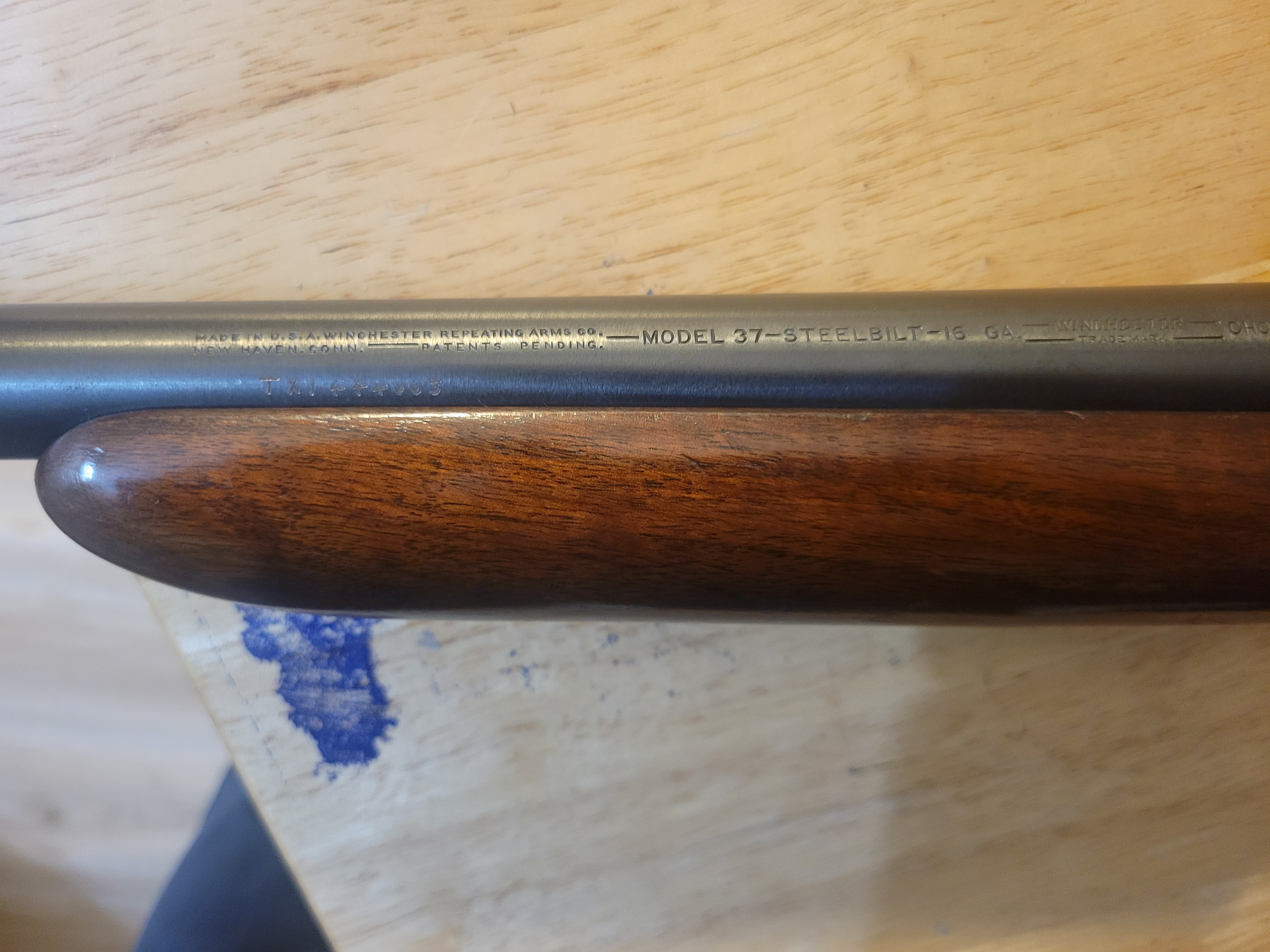

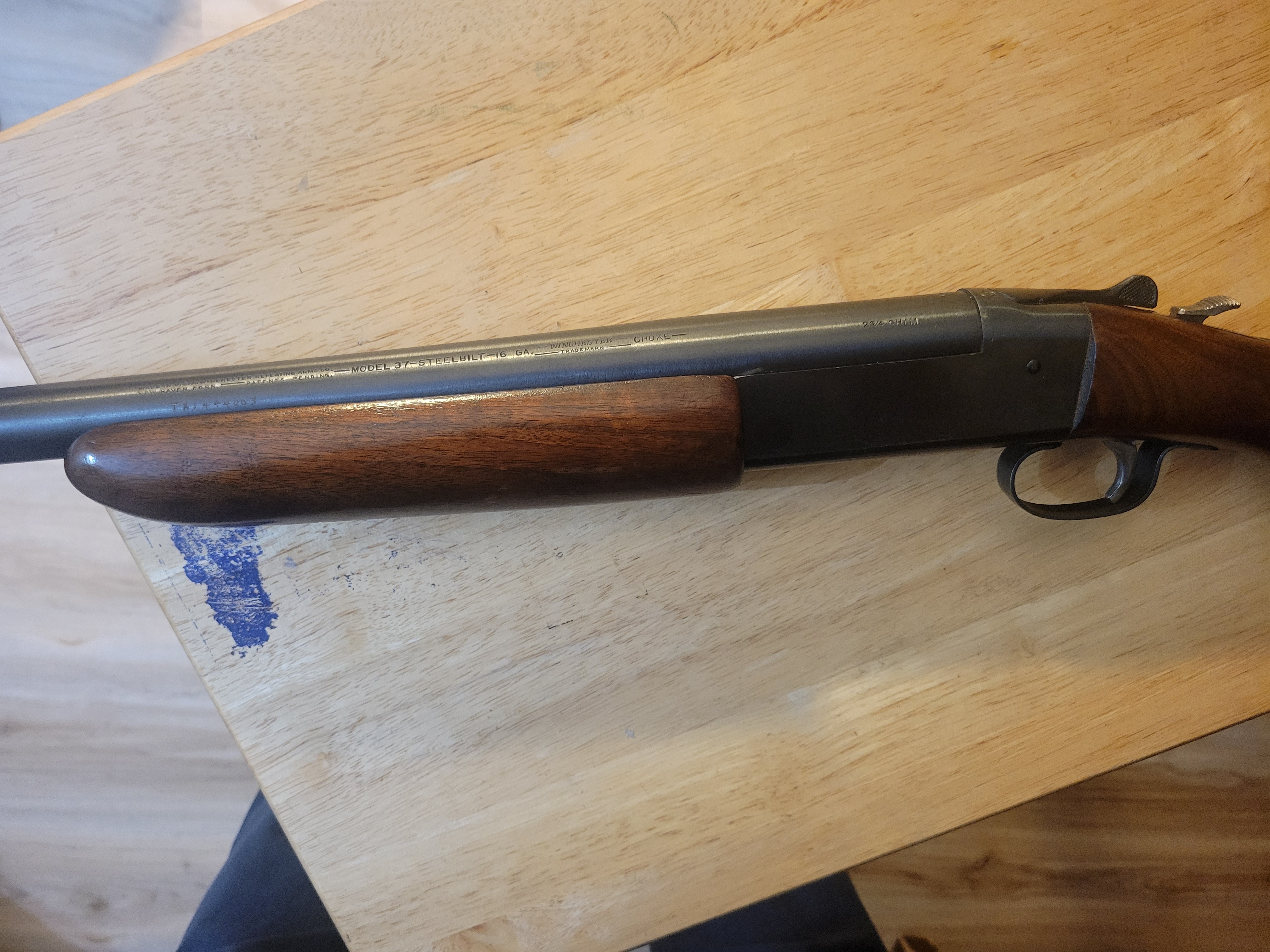

I’ve just been gifted a nice Model 37 16 gauge with a “choke” barrel and no apparent serial number. Ill post pix soon but not tonight or Saturday.
In the interim are there any particular physical characteristics that might let me ballpark the date range?
Roll marks include the expression “Steel Bilt”  and the barrel and frame bear Winchester proof marks. The frame is blued, not case colored and the hammer is (or was) bright steel. Stock and forearm are dark straight grain Walnut and a deteriorated pad is on the butt.
An owner has thoughtfully added his Texas DL in 4 point scratching on the barrel. Mercifully unobtrusive. The trigger guard is bent steel, blued.

An update.  There is no date or date code anywhere on the barrel.
My friend who.gave me this Model 37 (because he is moving to an assisted living facility) believes his father bought the gun shortly after the close of WWII, before he could afford to buy the pump shotgun he used for the rest of his hunting days.
If he bought it used,  it may be older than 1946 or 1947, although it is a 90% gun except for a flattened and distorted recoil pad of unreadable make,  badly installed on the un-squared off wooden butt.
If anyone collects the Model 37, perhaps the “Steel Bilt” rollmark will ring a bell. Also the “Choke” rollmark, although I’d bet a donut that meant Full Choke since these guns were supposed to “shoot hard.”
It won’t be economic to do so, but I’m going to take it to Ron Gervase and have him install a solid red Sorbothane pad on it. The rest of this little 16 gauge is too nice not to do so and it would make a good teaching gun for somebody down the line.

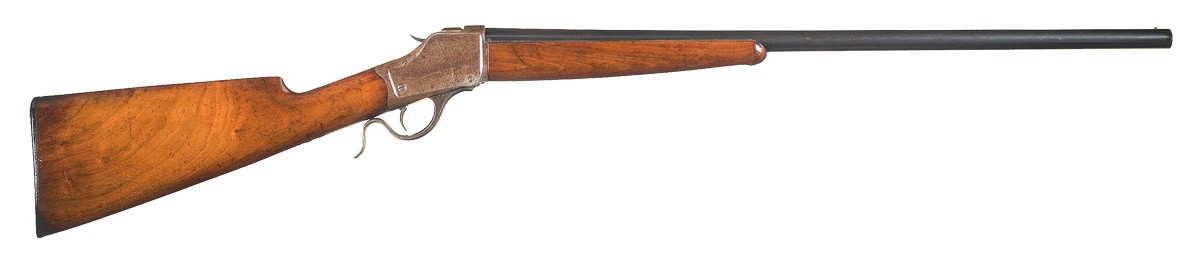

You apparently have not ever tried to shoot an original Single Shot high-wall 20-ga shotgun… I challenge you to shoot even a half box of standard 2.75″ No. 4, 5, or 6 shot shells through it.  The high-wall shotguns as manufactured by Winchester weighed just 5.5 lbs.  I stopped shooting mine after just (6) shells and have not tried to shoot it again since (I purchased it at the January 2001 Las Vegas Antique Arms show, and then took it out shooting in the Spring of 2001).

Paul,  all that information helps a great deal. On close examination:
1. No trace of red paint.
2.. lever appears to be of conventional shape and made of solid steel. There is a checkering pattern impressed or molded into the sides of the tab.
The buttplate is missing and a deteriorated red pad with horizontal ventilations was on the still-radiused buttstock. I removed it in pieces and observe the stock is American black Walnut, not birch.
The forearm is full and ovular,  almost a semi-beavertail, and without finger grooves.
Based on your helpful.information, I think we can conclude it was made post-WWII,  from 1948 forward.  That comports with the donor’s recollection of his father using it to hunt ducks along the Brazos in the late Forties or very early Fifties. My friend would have been 8 to 10 years old then.
