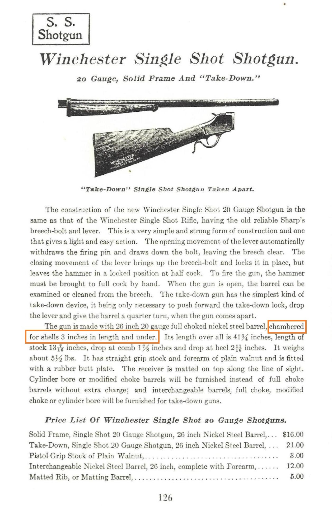

Chuck,
Your Single Shot (M1885) 20-ga high-wall shotgun has a factory 3″ chamber… short shells are not needed.
Per the 1914 and 1916 Winchester catalogs…

Chuck,
I’m sure you have told me this before but if I don’t scratch it into the back of my hand, I will forget. I updated my file to show 3″ shells.   I do have several cases of 20 ga.  Probably 1 of target and 1 for hunting.  Maybe I’ll take a 3rd gun to the range tomorrow.   Thanks.
