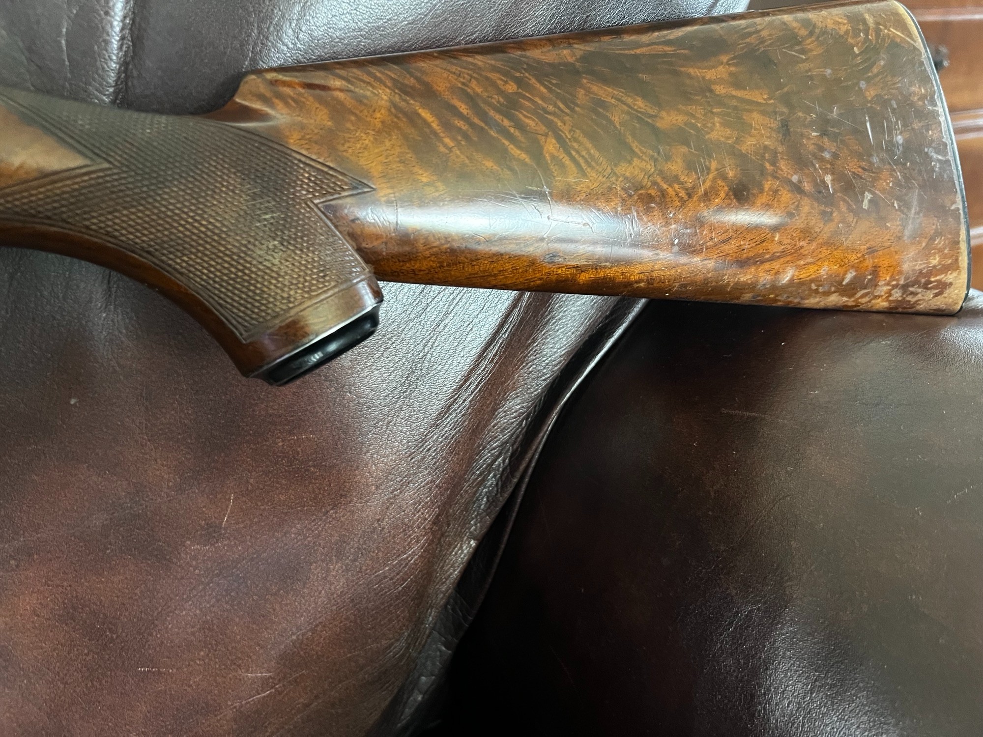

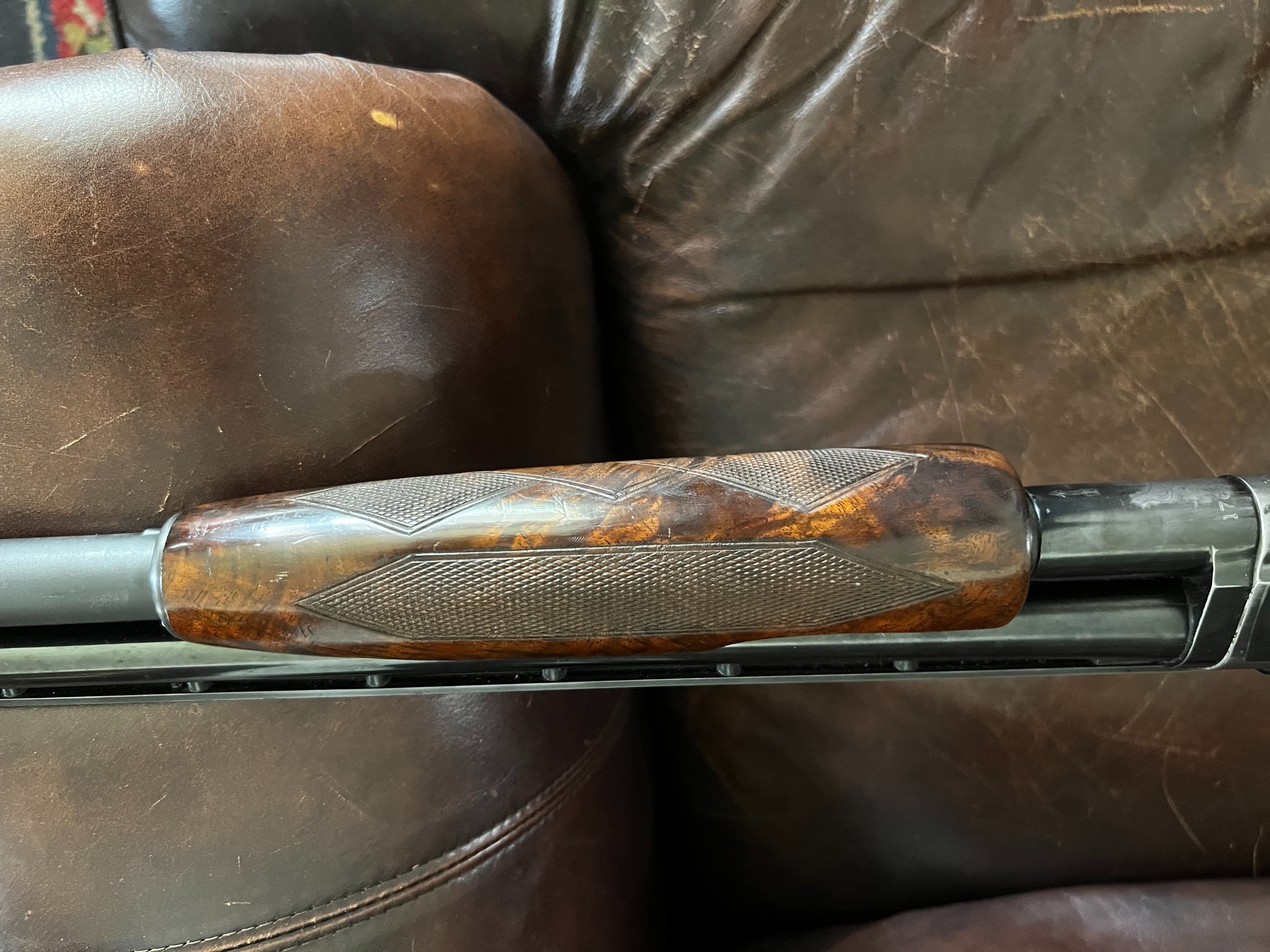

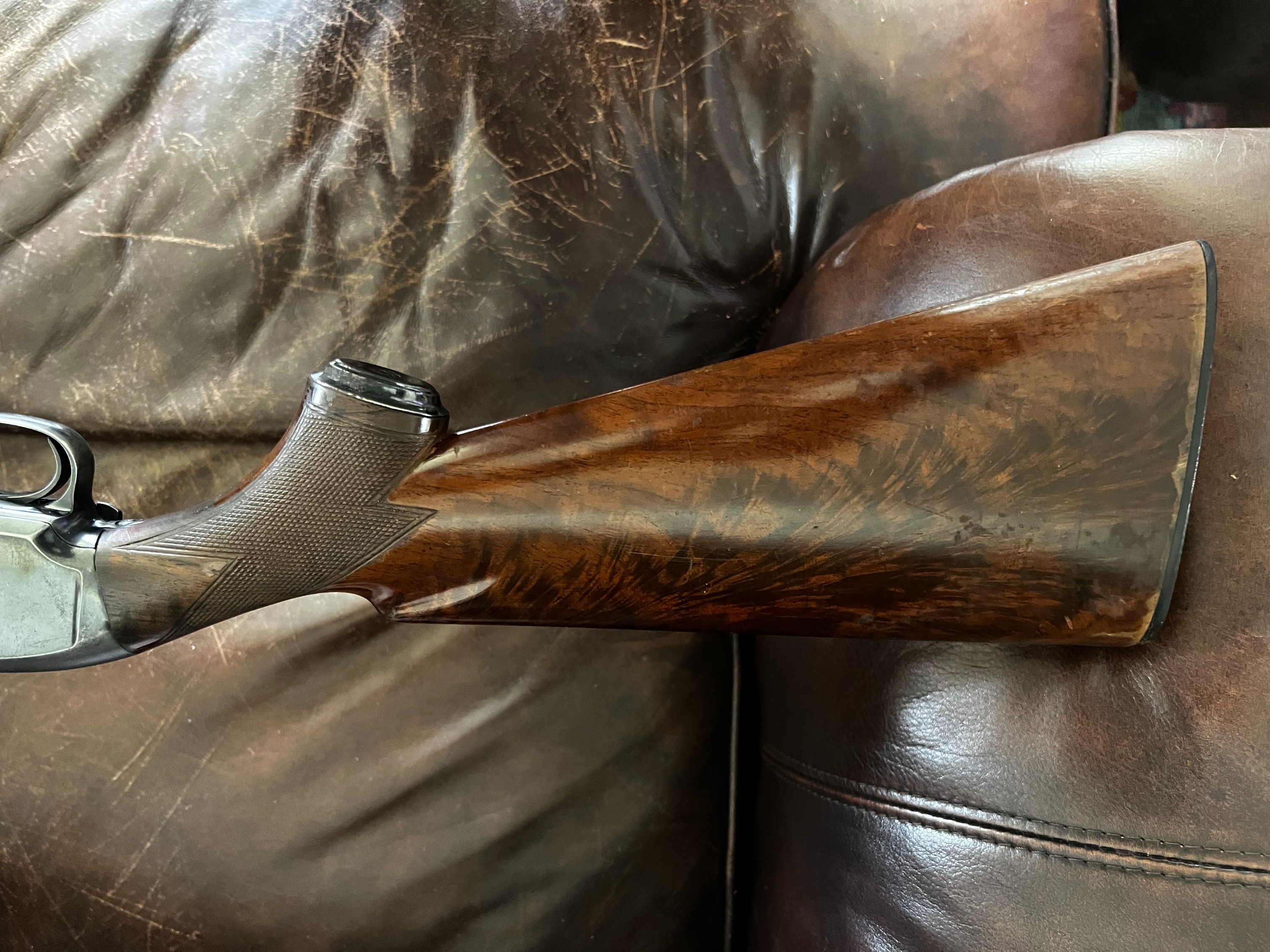

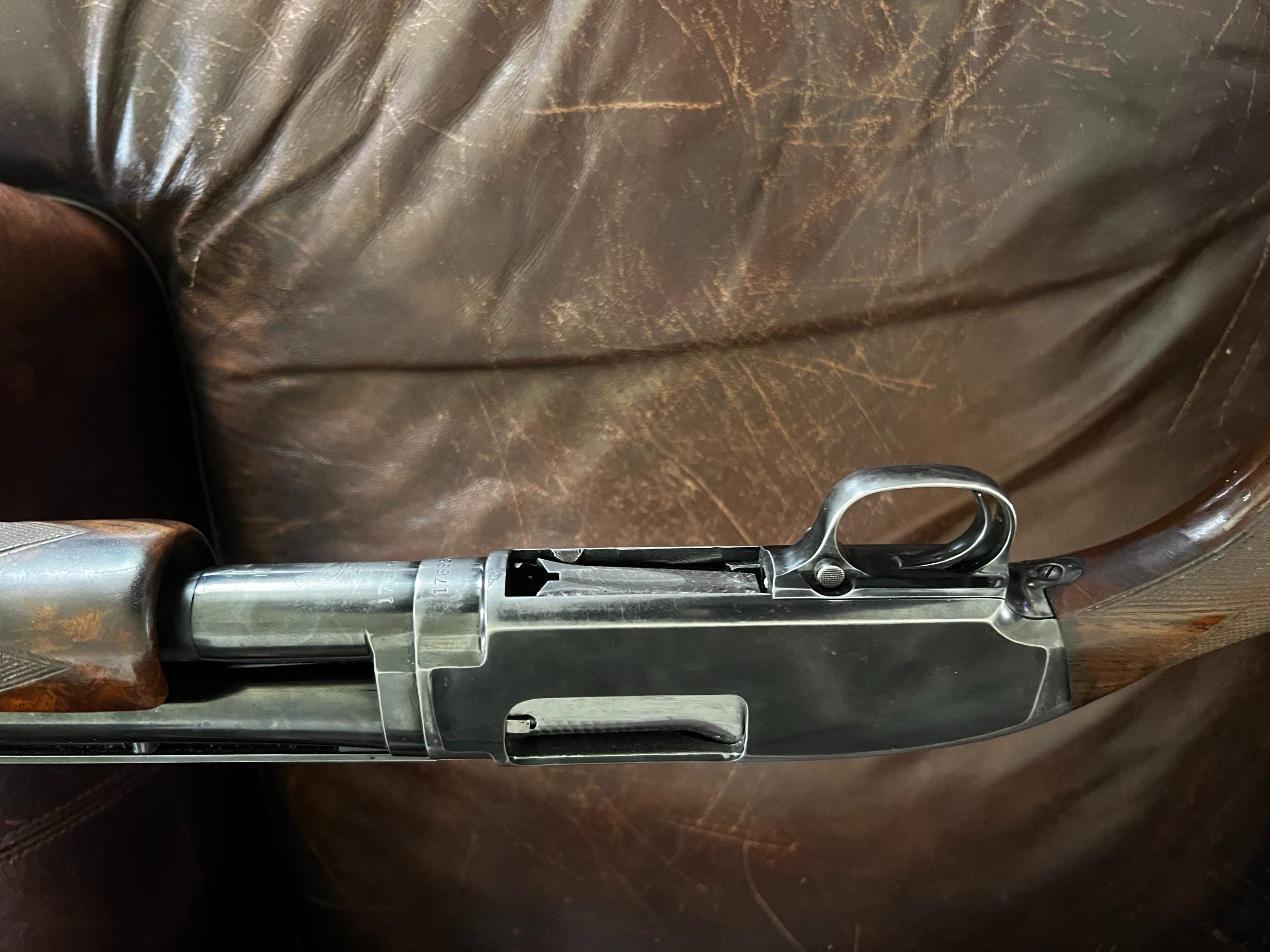

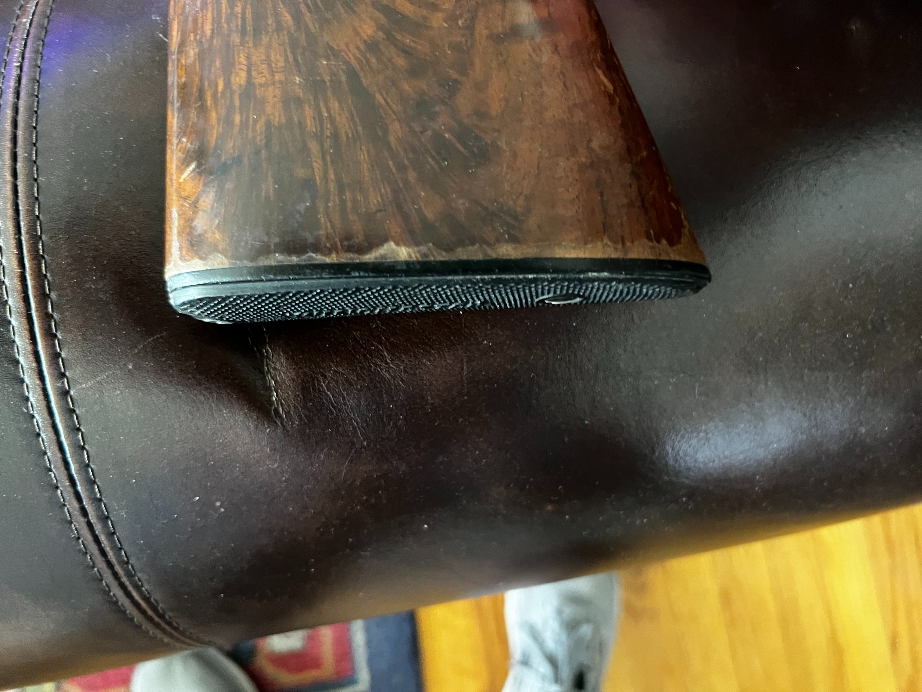

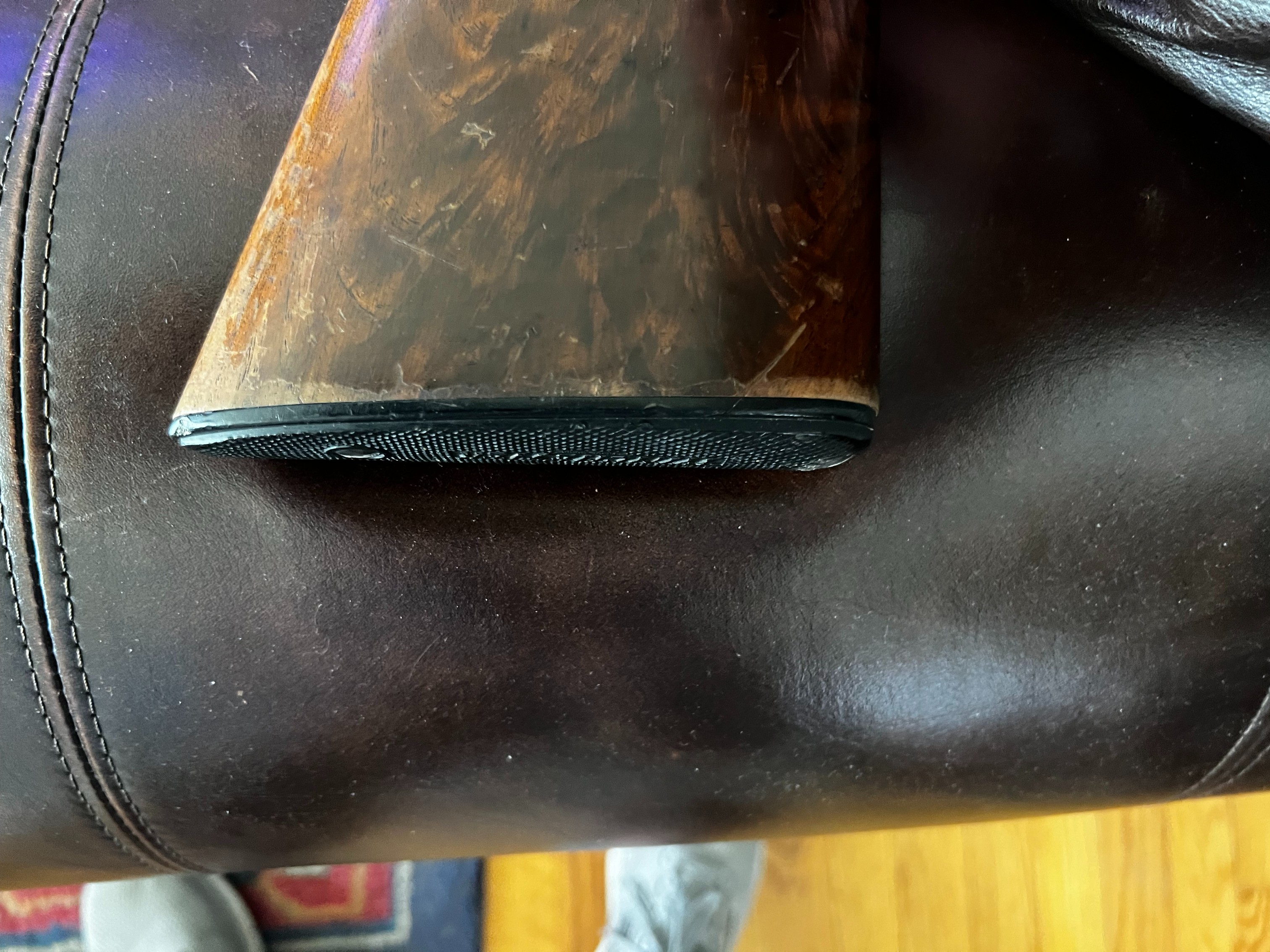

I was able to get a few photos to better show what I’m looking at.
Forum Posts: 6916
April 26, 2025 - 9:00 pm
As far as the wood goes, give it a few coats of Boiled linseed oil.
Forum Posts: 2509
April 26, 2025 - 11:24 pm
I’m not a fan of unmodified linseed oil, myself. Without a hardener, it never dries, doesn’t resist moisture all that well, and turns gummy and black with age and exposure to Sunlight.
I’m pretty sure the original finish on that PG was sprayed lacquer, based on how little remains around the circumference of the buttplate. There are other hardening oil finish products than Tru-Oil but that’s what I’m familiar with and have found compatible with old Winchester sprayed lacquer. It is essentially linseed oil with a red-brown tint and a hardening chemical. It can be applied with a rag or a brush and when thoroughlybdry leveled with 4-0 wool or the equivalent, building up with several coats. It can be given a sheen with pumice or rotten stone in an oil slurry on a felt pad.
If you are uncomfortable with the possibility of messing up the remaining lacquer, a completely reversible alternative is a tinted wax, the only downside to which is the need to refresh it from time to time. Wax slowly evaporates.
The fact that this gun is a twenty and not a twelve looms larger and larger in my mind, particularly now that I’ve seen the high grade wood. If the rib is soundly attached. If the bore is good and it shucks and shoots, a ridiculous price would be all that would stop me.

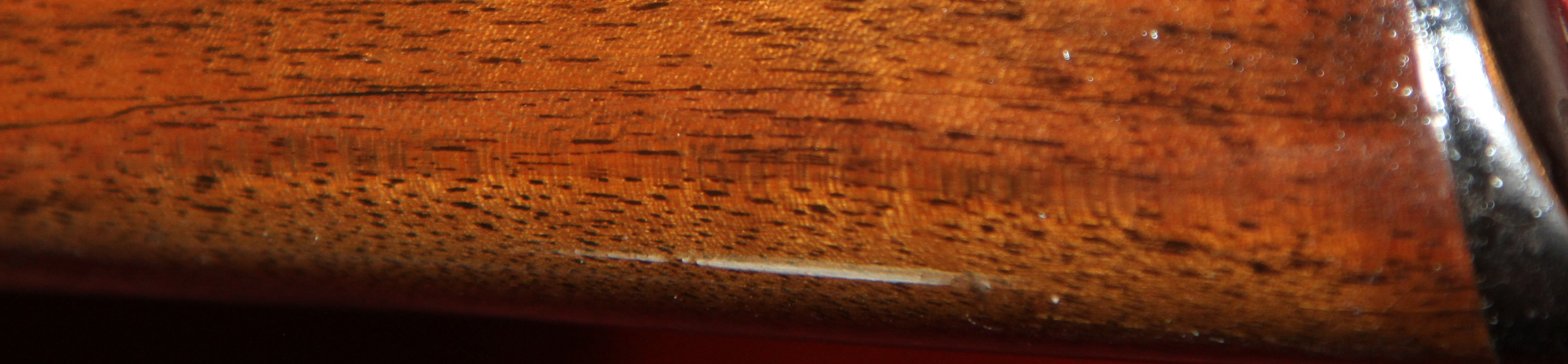

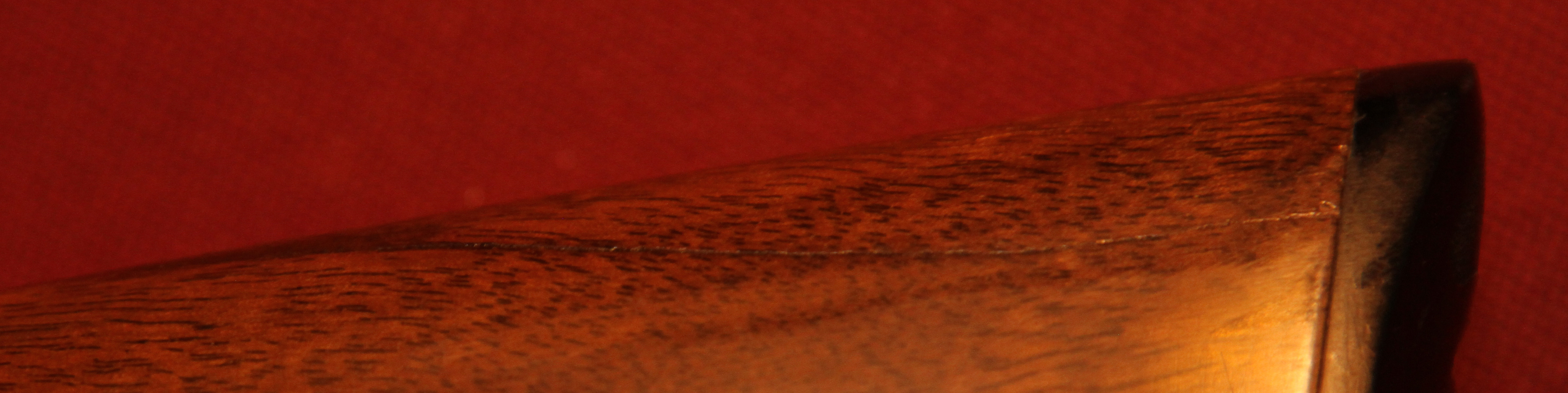

This Browning is my latest project.  I just re glued the original piece that broke off.  I did have to do some sanding but on one side the owner took some steel wool to it so there was a lot of sanding.  I use 400 grit wet and dry sandpaper that has been used many times.  As long as it will make a cream it is cutting.
The damage is done and I don’t want to do more than stabilize the broken piece.  The more you sand the worse it will get.  If it was an oiled stock sanding isn’t that much of an issue.  But high gloss varnish is a pain especially if you cut through the original coats.
