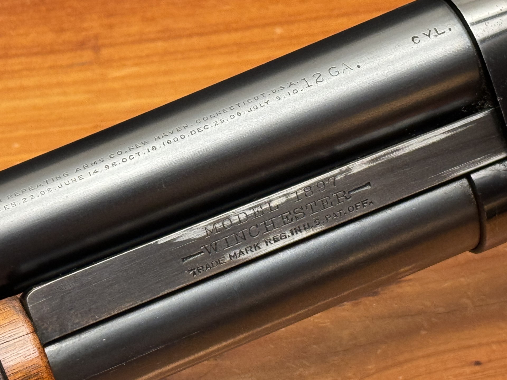

6 lines running the full length of 30" modified choke barrel on a E model 1897 Winchester mfg. 1918.
Dennis Flaim
Forum Posts: 3
March 28, 2025
April 7, 2025 - 4:50 pm
what are these lines in this barrel and are they supposed to be there?

bore is very shiney,lines look like they were machined into barrel. The gun was purchased with a 20″ cyl. bore barrel installed on gun. The 30″ barrel came with the gun, it has the matching serial number to the receiver. Gun is in 95% condition.

Dennis,
Is the 20-inch barrel a Winchester marked factory barrel, or something else?
Do the lines twist inside the barrel or are they perfectly longitudinal?
What is the serial number on the gun?

Yes the 20″ barrel is marked Winchester model 97 2/3/4″ cyl made in New Haven conn.  The 30″ barrel is also marked model 97 Winchester 12 ga.2/3/4 chamber mod. serial # on receiver and 30″ barrel E646815.    n0 serial# on 20″ barrel. lines run longitudinal the full length of barrel. The lines are perfectly spaced and you can feel these lines if you insert small finger in the end of barrel.
Based on the markings you describe on both barrels, neither one of them is factory original to the gun.  The s/n you mention was manufactured in February 1917 per the factory records, and the gun is a Model “1897”. Winchester did not begin marking the chamber length on the barrels until the year 1930. If you inspect the bottom of the barrels, you should find a 2-digit year number stamped near the take down extension.
The slide bar on the barrel assemblies should be marked accordingly as shown in the picture below.  However, it too may have been swapped out and have a later style marking, or no marking at all.
The original barrel(s) were marked as shown in this picture.
As for the scoring in the barrel, it is not factory work.  To the best of my knowledge Winchester did not ever manufacture a slug or “Deer Slug” barrel for the Model 97.  On other Winchester model shotguns, the slug barrels were rifled (the grooves twist inside the barrel).
