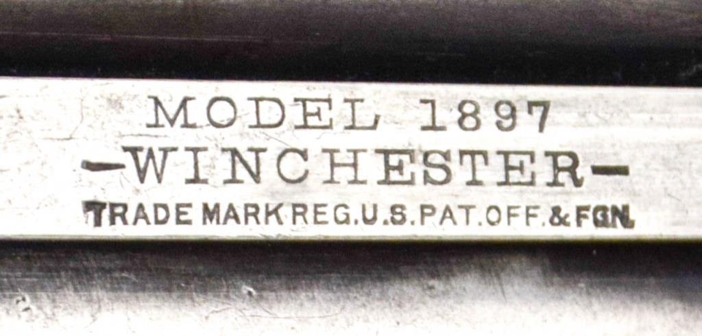

In the early part of the year 1919, Winchester Plant Manager Frank F. Burton issued a Change of Manufacture Notice to shorten all model designations in production from 4-digits to 2-digits.  The Engraving shop then was tasked with making (or modifying) all of the roll die stamps to comply with that notice.  For some models, the change was made rather quickly, but for others it took nearly a full year to fully make the change.  Due to some models having a substantial number of already made & marked parts on hand, the newly marked items (barrels, slide bars, receivers, etc.) did not begin to appear until late in the year 1919, or in several cases, early 1920.
The Model 1897/97 transition took longer than any other model to complete (reason unknown), and it has the longest span of serial numbers where the transition took place.  I have been surveying the Model 1897/97 for a very long time now, and I have a considerable database on them, which includes the observed serial number ranges for the various changes.
The first Model “97” marked shotgun I have found dates to mid October 1919.  Just prior to the change, Winchester was using what I refer to as the “Type-5” slide bar marking with the upper line marked “MODEL 1897”.  The new “Type-6” slide bar marking was created by simply removing the “18” from the Type-5 roll die “MODEL    97”, and it was used through November 1920, when it was replaced by the “Type-7” roll die “MODEL 97”.  For most of the year 1920, there were a lot of guns made that still had a Type-5 slide bar marking on them. See the pictures below showing the Type 5, 6, & 7 slide bar markings.
I would like to add your Model 1897/97 shotguns to my survey.

Your Model 1897 was serialized in December of 1919.  It is very near the end of the “1897” Type-5 slide bar marking use.  What was the serial number on the one you passed up?
