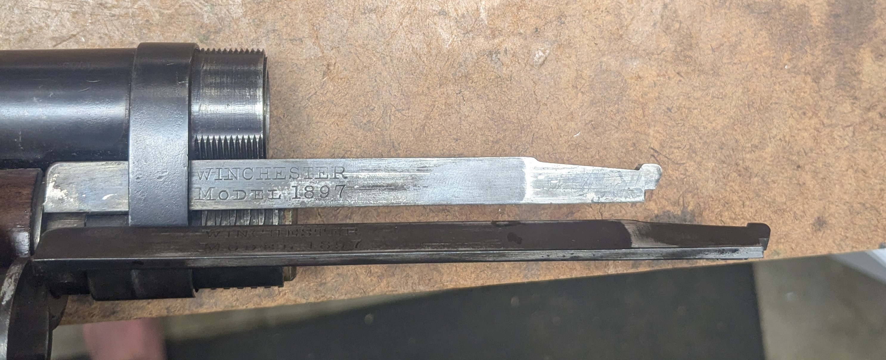

I recently bought a replacement Slide Action Bar for my vintage 1897.
I installed the part and the gun would not cycle properly. After exhausting all of the reasons why it could be doing this, I finally compared the old to the new.
The old one, on the bottom, is much long than the replacement.
Was there a length between the solid frame and the takedown? I don’t know why there would be, but stranger things have happened.

Yes, there is a length difference for the slide bars between the Solid Frame and the Take Down guns.  You bought an early Type-1 slide bar for a Solid Frame gun.

Yep…
I just found that elsewhere…
Guess I have one up for sale then.
Thanks Bert
