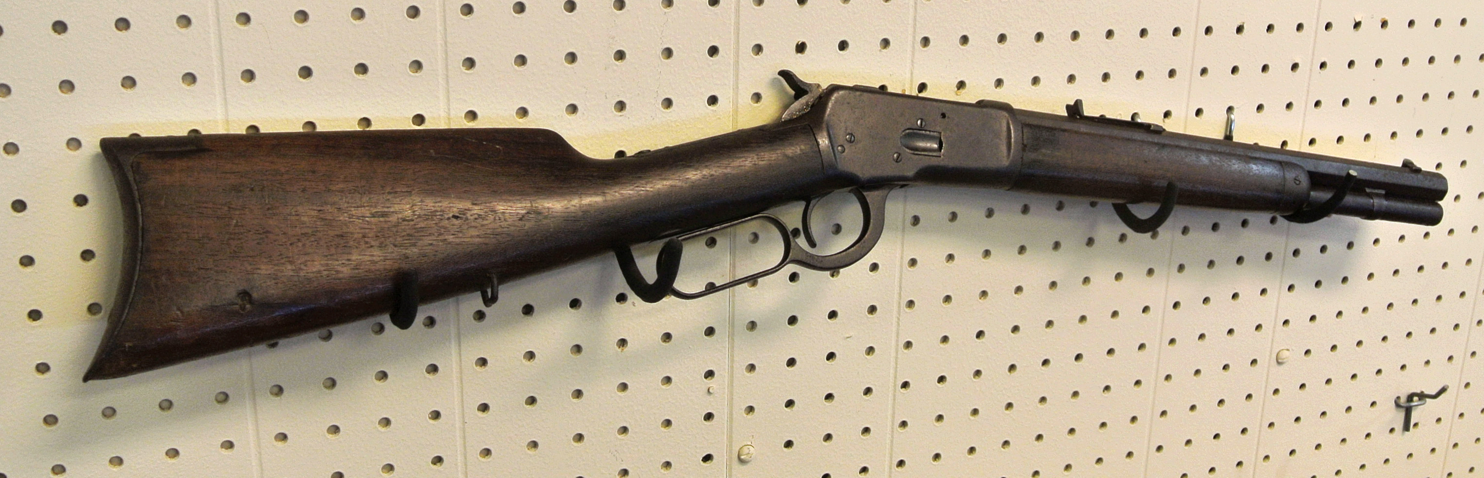

Any help or advise on this would be appreciated. I purchased a number of old Winchesters recently and this 14″ 1892 is one of them. It basically looks like it’s been left alone for 100 years but who knows. The patina looks right and some pitting or residue in some areas. All the writing is visible and readable but I am having really tough time with the serial number. The number is there but time has just made it really tough to decipher but a couple of digits. The age wear is just in a tough place.
Hopefully the photos indicate that there’s been no defacing or removal of numbers it’s just very, very hard to find much to read but it’s there.
About the rifle itself, it does have a 14″ Octagon barrel and is chambered in 44 WCF. I’m wondering if that would provide any age/date range (maybe octagon barrel vs round barrel etc)? As Bert clarified it’s not a “Trapper” but a short rifle.
Not sure if there’s any pecking order of desirability for short rifles or features but I’d appreciate any information or help.
FINALLY. From what I read at the BATF website, they would likely exempt a rifle like this from NFA regulations whether antique or C&R but I’m just trying to get opinions on this rifle.
Thank you very much, Paul

If the barrel address makings are in front on the forearm cap, contact me. That is where they should be. I am not trying to disparage your gun, but it has been cut, like a lot of others in the era. Just trying to save you the trouble of sending to ATF where they may weld up the chamber.
Walter

Thanks for the info, I’m under no illusions about this rifle so I appreciate the information. It took some doing with a toothbrush and a little gun oil to find the markings and it does begin in front of the forearm end cap and continues behind it. The barrel measures exactly 14″ so I was hoping it was factory but sound like it’s not.
I wonder what my best option would be on this rifle?
Paul. (Stephen is my first name but I go by Paul)

If a gunsmith says it safe to shoot, then shoot it and enjoy. 14 inch guns are a hoot to shoot.
Walter
