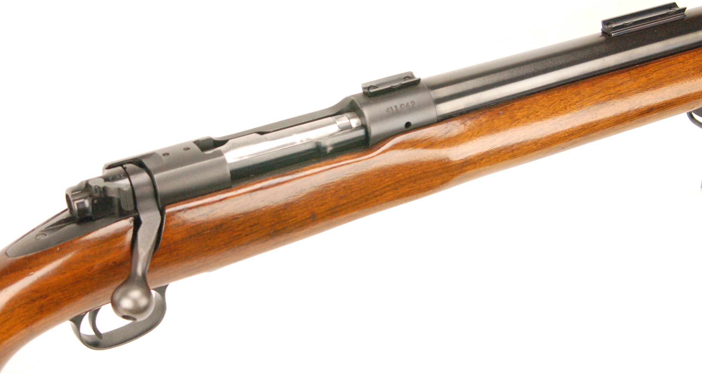

I was referred here by a fellow from the Milsurps forum.  I posted there about a couple of Model 70s.  Both are set up basically like the one shown in the attached pictures.
I’m mostly a US military collector but I’m also an FFL and I buy/sell on the side for fun money.  These rifles don’t hold much of my interest and I will be passing them on to someone that wants them.  However, my usual methods of research don’t do me much good if I don’t even know what to call them!

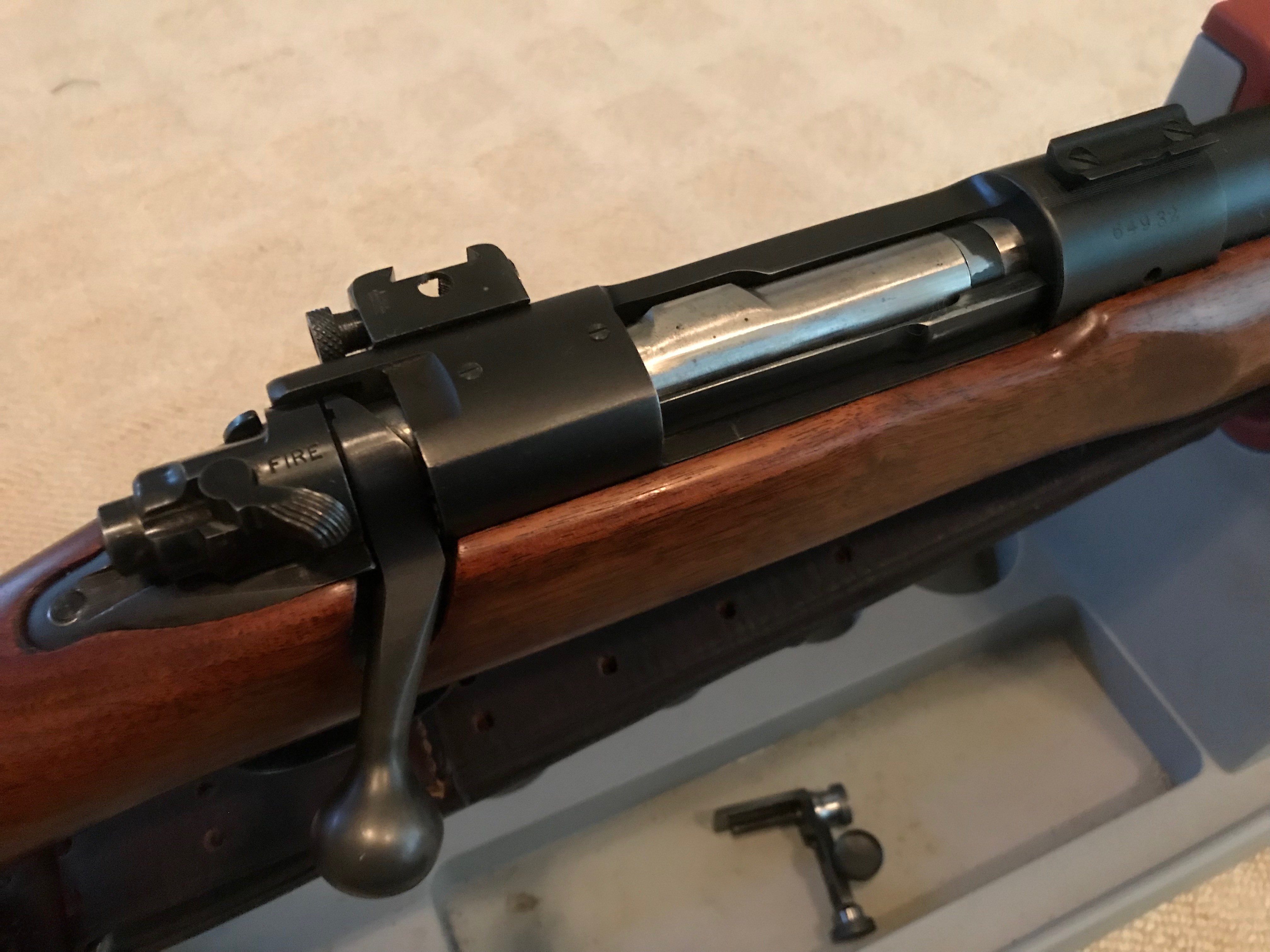

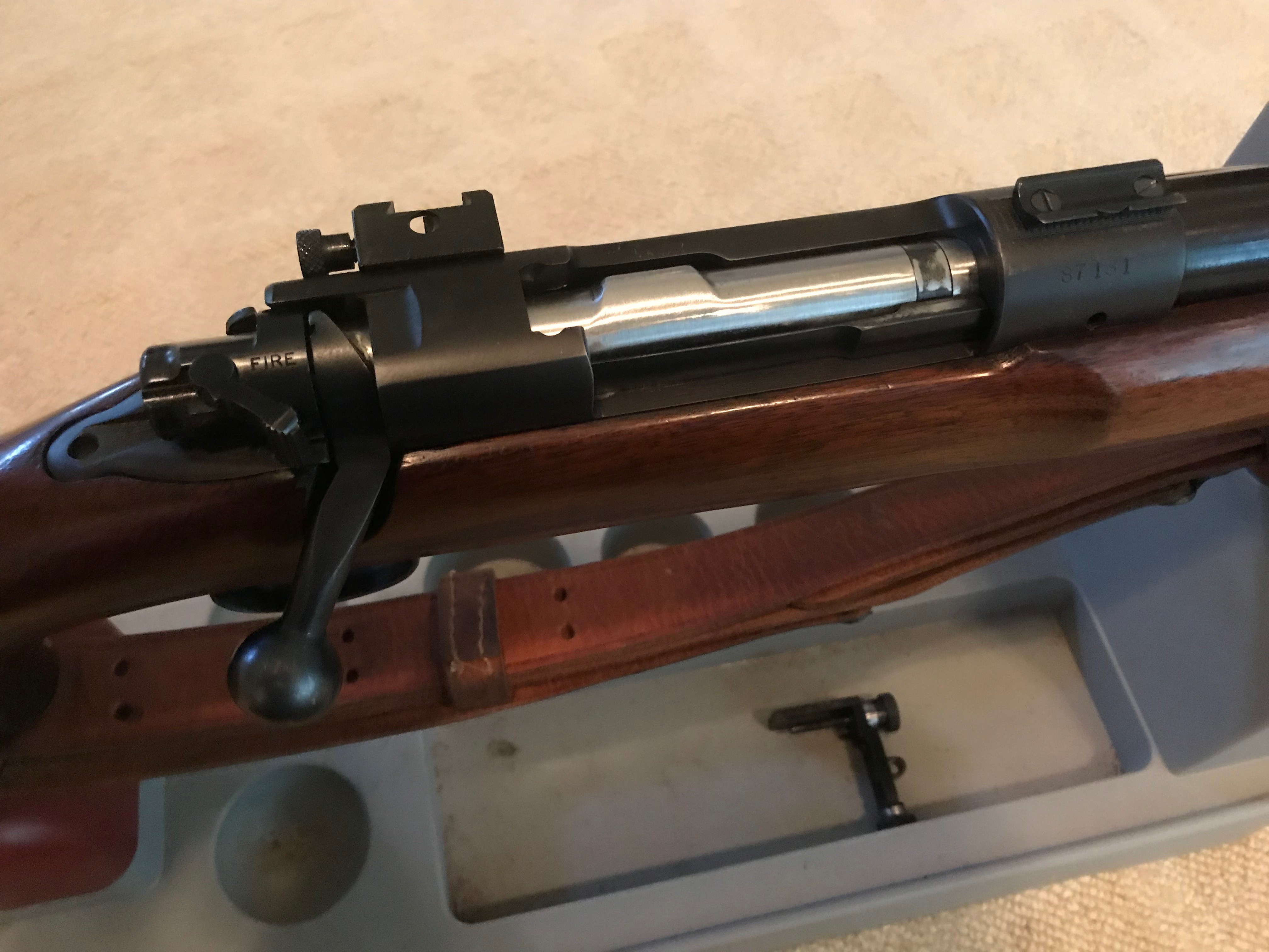

Alright, here are some more pics.  I’ve arranged them in two separate galleries by serial number for ease of viewing.
Unfortunately, one did get some damage in shipping.
Anything to add in light of these new pics?

Viewing pix; rifles as ‘packaged’, my conclusion…  Likely heck of deals.  Really great!  Actually looking about like two different rifles each!  Such between action-forward and buttstock-aft. Just the sighting equipment alone, extraordinary!  Perhaps if mine, I’d try to trim down the buttstock area to more ‘livable proportions.  Unsure what all the extra weight & bulk was intended to achieve there.  Presuming Walnut, must be considerable weight aft!  Not at all sure of what appears a strengthening sleeve on the barrels, yet now wondering if those might have originally been National Match rifles based on barrel diameter beyond sleeve. All in all, very interesting packages.
Unchanged conclusion these aren’t collectible rifles in any “pre ’64 Model 70” sense I can conjure.  Likely whatever residual value as target guns, IF sufficiently accurate and perhaps with some stock modification averting ‘clunkiness’.
I like them more for what they could be if trimmed down stocks.
Perhaps some target shooters can weigh in concerning residual usefulness in that capacity. If not… Fun guns, Ho!
(Additional pix of left side would be interesting too, IF convenient!)
Just my ‘non-expert’ take

The first rifle, 24718 is an interesting one. Look’s like a pre war receiver which has had the top of rear bridge milled flat and and a post 64 bolt installed.
By the way, the Swenson sights are excellent pieces.
None will win any beauty contests, but most likely excellent target rifles. As mentioned, absolutely no collector value, but worth every penny paid for target use, or just the components.
