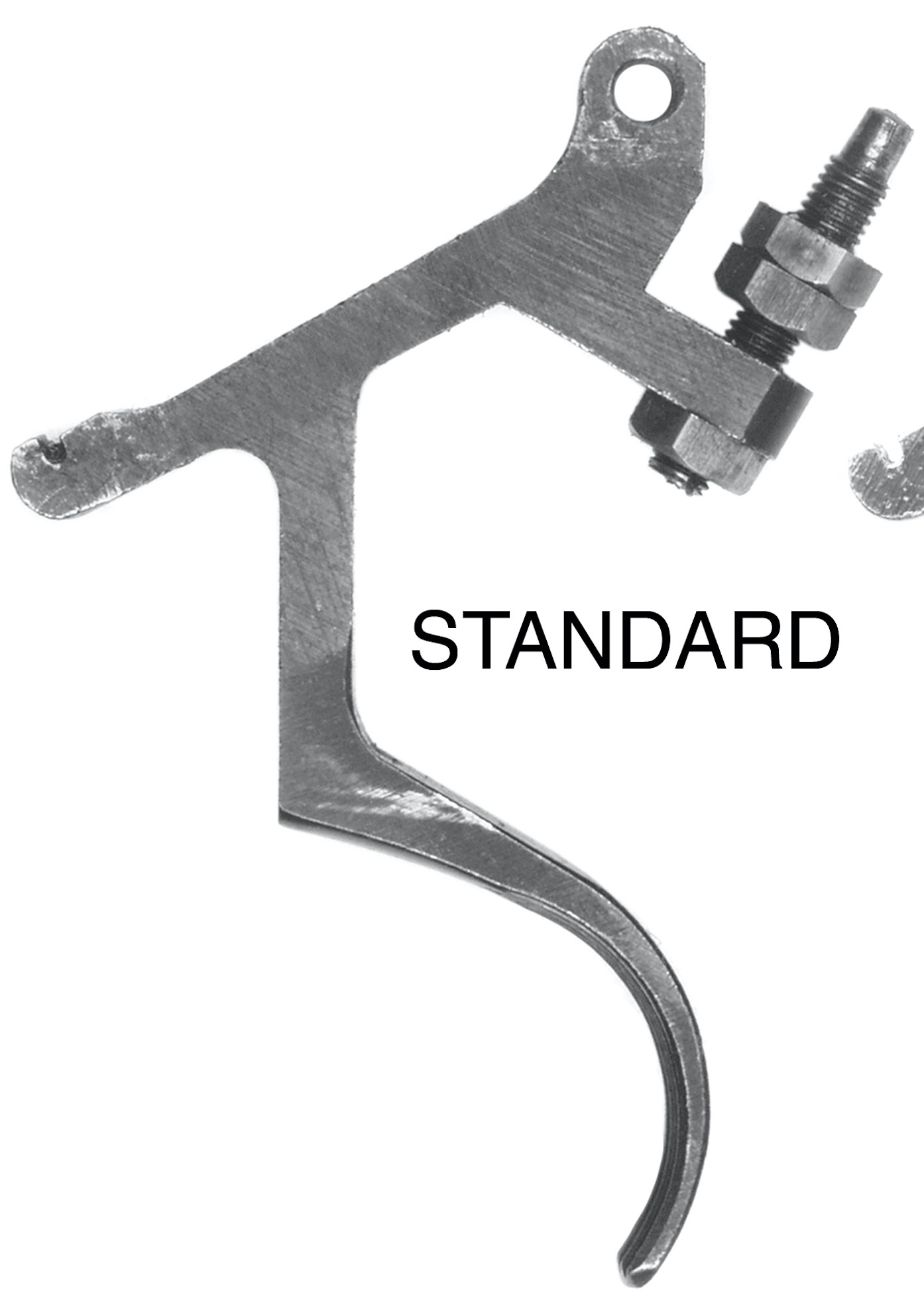

Hi Sureshot-
To my knowledge Winchester only used two different triggers in the manufacture of the pre-64 M70.  The standard trigger and the target trigger, which differed only in the dimensions of the sear engagement notch.  Both were steel and both were blued…
This is the standard trigger:
Anything else is altered or aftermarket…
Just my take,
