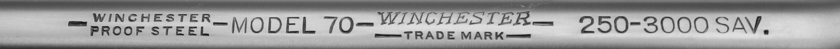

You can’t draw many conclusions comparing caliber stamps on 250 Savage barrels with those on rifles whose barrels were made after 1950.
The subject rifle, while built on a 1954 action, is very likely to have a ’49 date barrel with Style 3A roll mark (my guess on date Laugh).  The important point being that until 1950, Model 70 caliber designations were applied using a separate (from the barrel address/model roll mark) die stamp.  Those die stamps are generally composed of characters 0.100″ tall, and since they were usually finished by hand (something factory engravers did when there wasn’t anything more pressing), there is a degree of variability from die to die.
In 1950, the factory went to one-piece roll dies where the caliber designation was part of the Style 3C roll die.  Those have characters 0.080″ high, same as the “MODEL 70” part of the die, and are generally more consistent in appearance than the hand stamps.  But Winchester dropped several chamberings after 1949, and the 250-3000 SAV was among them.  The VERY few (exactly two) 250-3000 SAVAGE barrels I’ve seen marked with a one-piece roll die read “250 SAVAGE –” not “250-3000 SAV.”…
Here’s a pretty good looking 250-3000 SAV. die stamped caliber designation.  It’s an earlier barrel so the roll mark part is Style 1, but that’s not the point.  Compare this one to the GB gun…
